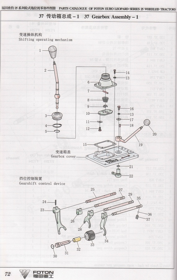

Greetings, Often when shifting into foward gears the engine bogs like it is still in reverse as well as the forward gear. I have to shift into reverse and out and shift again. I'll try to upload and exploded view of gearbox/with shift tower.

In the exploded view item #10 the pattern template. You can see, #12 & #6, that it is shown bolted to the tower. If that were to be loose I'm thinking that might cause the problem I mentioned. Have any thought on it?

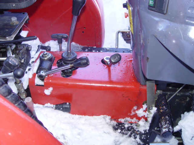

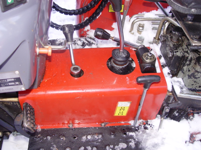

Is this similar to your tractor? Were you able to remove the sheetmetal without raising the instrument console by just removing the handles on either side of the shift stick?

I don't have a tractor yet but I've experienced a similar problem with a GM Saginaw 4 spd transmission. Shift rods and forks are accessed by the shift lever when you move it forward/backward, and across the H. Transmissions have a series of interlock balls, detents, and springs that prevent one from selecting TWO rods at the same time. If a ball or something is missing (as was the case in the GM transmission I rebuilt) it can allow two forks/shafts to be selected at the same time, followed by your movement of the shift lever forward or backward. If a forward gear and reverse are adjacent or side by side in the shift pattern, this situation can result in simultaneously selecting both forward and reverse at once. At that point the engine bogs done. I hope this helps you out.
/ Foton 254 gear confusion #12
Valley,
More thoughts.....The shift lever #2 pivots on a spherical shape roughly 25% up from the bottom. The end of the shaft has a ball like tang on the end and it fits into one of the slots on top of items 23, 26, 28, and 34 depending on where the shift lever is from one side of the pattern or the other. Once engaged in a slot, for example on top on item 23, when you move the shift lever forward or backward, it moves the shaft. If the tang on the bottom of the shift lever engages two of these at once it will try to move two shafts at once. That's just my opinion from looking at the exploded view. I'd take the cover off and see if it's possible to move two adjacent shafts in the same linear direction at the same time.
Hope this helps you out.

valley it's one of the # 37 spring's that is weak or broke sometime's you can streach it out a little if it's weak, if weak it won't let # 36 ball hold the shifting rod in place Jeeper

yes I've had this experience with other tractor's you will have a ball and spring on each shaft the ball could have a flat spot to, looking at a 404ft or 354 jinma now thinking of buying if I can talk the boss at home into it she said I allready have to many but I would like to have a new one I have few antque's Jeeper
