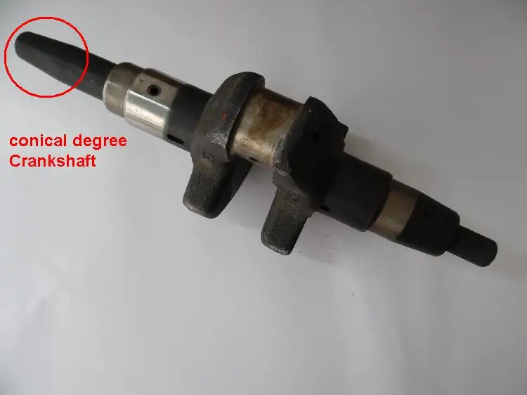

Anyone know how far the sleeve can be bored too on the 186f.. As china is now producing the 188f
@ 456cc.. The 190f @477cc with 90mmx75mm bore stroke. And the 192fb @498cc with a 92mmx75mm bore stroke.. Wondering if the 186f can use the 90mm piston and crankshaft from the 190f to get 477cc's or 92mm piston and same crank for 498cc's.

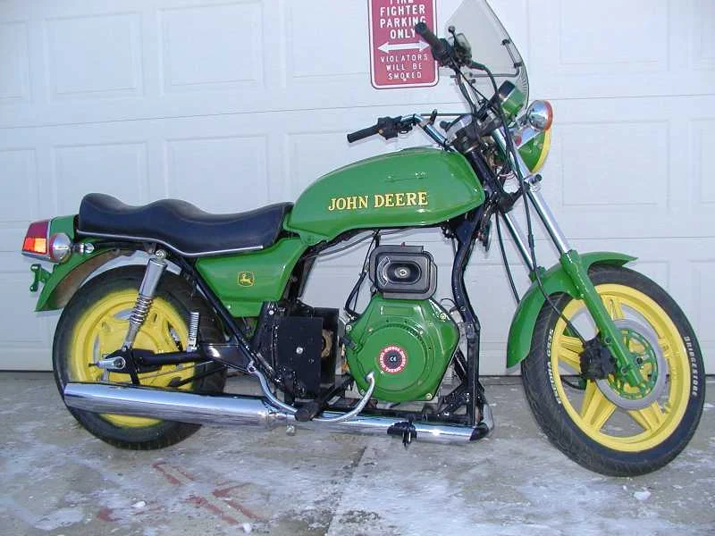

A 2 wheel ONLY YanDeere-da REALLY.
Ben's 1980 Honda CB750C Yanmar Diesel Motorcycle.
DieselBike.net | Diesel Motorcycles using Yanmar and Yanclone parts
Our sub-thread here for Yanmar air cooled engines would be proud to see this one!
Not sure if that is the L100 or L90 engine.
