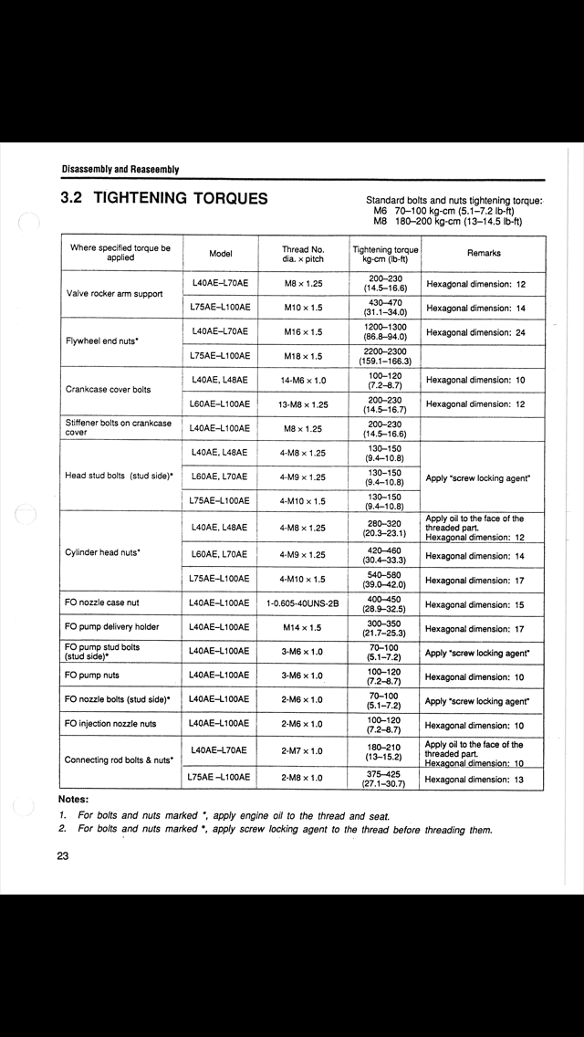

Are all the copper injector washers 1.4mm thick, or does it vary by individual injectors? (Or is it 1.3mm?) I have read conflicting statements.
(I mangled a washer installing it today, and I'm looking to salvage the injector.)
Anyone know the torque on the m10 nuts holding the injector in?
Thanks!

   / Forum for air cooled diesel engines and clones #494
Awesome! I feel like some of the steel on these nuts and studs is a little on the soft side, so it is great to have numbers.
All the best,
Peter
