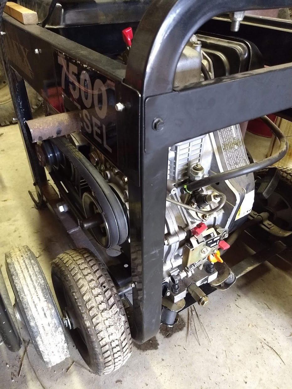

So, I did removed the muffler on my 186F due to it being restrictive at the outlet at the head. I welded up a pipe and stuck it on there. Runs better now but its deafening. I need some sort of a muffler.
Anyone ever replace a muffler with something other than OEM?
Just order something off eBay or go to tractor supply. A small muffler off like a international cub or some small zt lawnmower should work.

Thats what I was thinking but then again thinking restriction. Just looking for ideas....

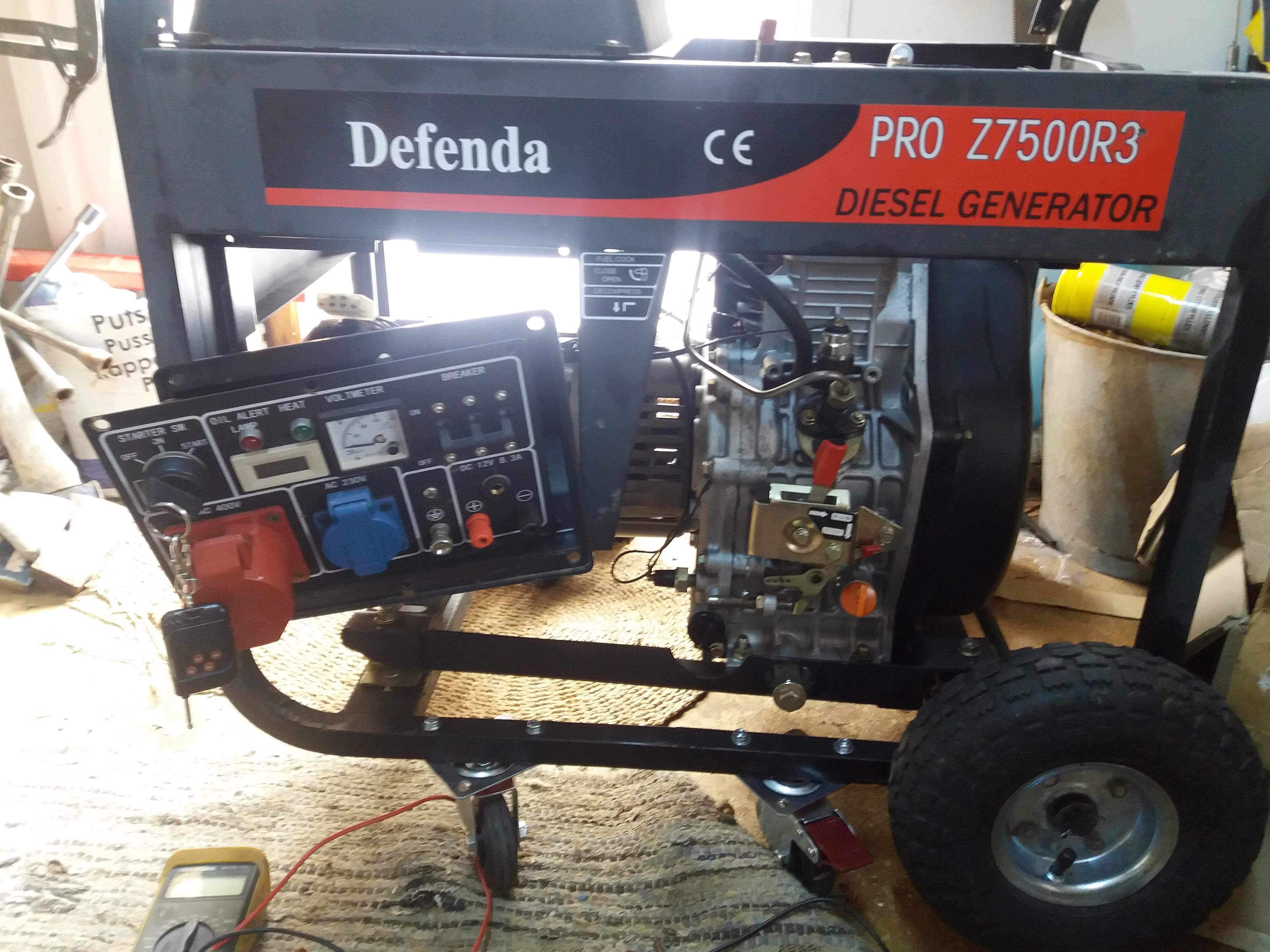

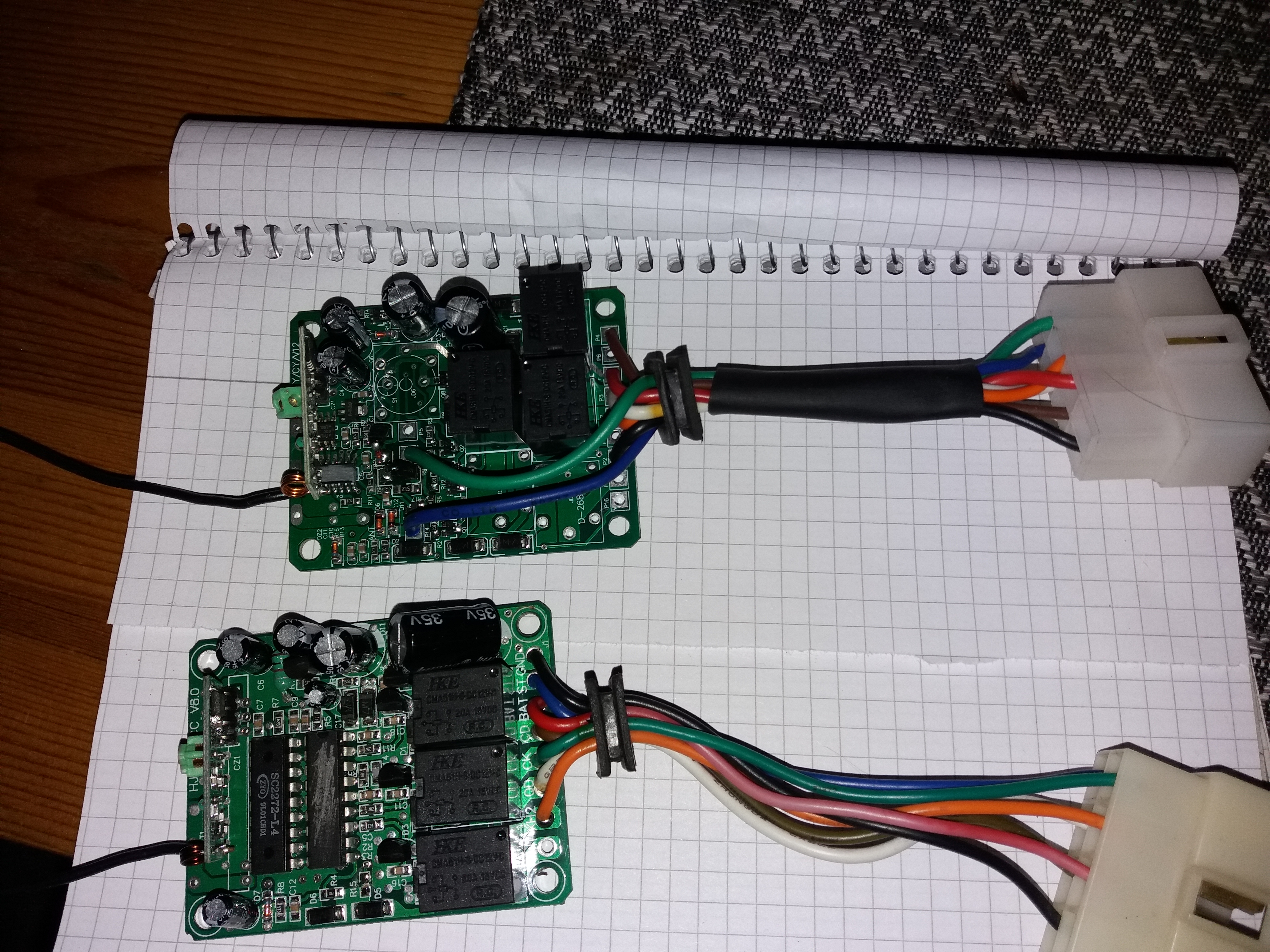

Hello too all !
I am new here and from Sweden.
I have a Chines 186f with electric starter
and a 230/400V 3-phase generator. It has a remote
start that has faild. (yes, new battery in sender)
I found a new used sender/reciver but it not works as suppose to.
First I would be happy to find a electrical drawing for my motor/generator, and a source where to buy a new remote that fits my generator.
The two recivers looks different inside, I will try to put up some
pics. It is the reciver with 4 relays inline that worked fine until it just died....
I have to be back with pictures later.
I hope that you understand my old school English !��

Here is pictures of the recivers and the generator ! 20190221_133539.jpg20190305_185152.jpg

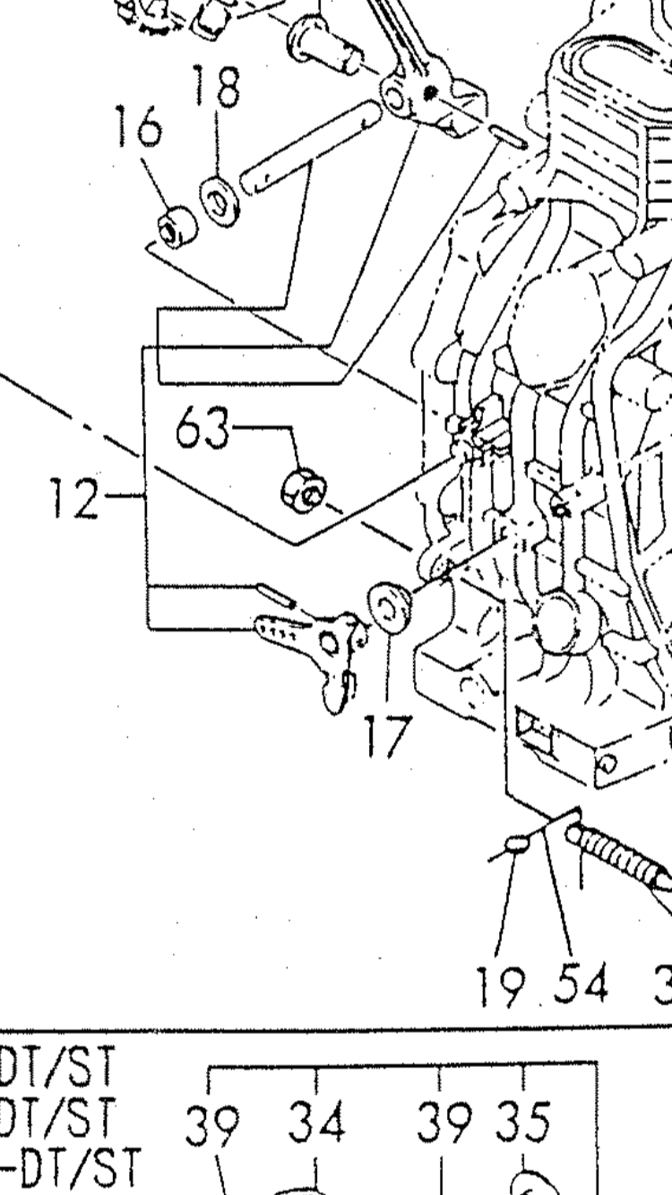

Guys, I'm trying to replace the governor oil seal on my 186F. I took the speed control off to access it. There is a pin that looks like it needs to be popped out. The pin though is not budging. I've been hitting it with a hammer and punch but I do not want to hit it so hard I damage the fork. Any ideas/suggestions?... I am taking this off correctly right?
Thanks
Randy B

Looks like 1 pin secures it.
Support the arm as you tap the pin out to prevent damage.
   / Forum for air cooled diesel engines and clones #449
Thanks, I looked up the pin # and it is a tapered pin so that helps a lot. I'll get back to it in another day or too.
