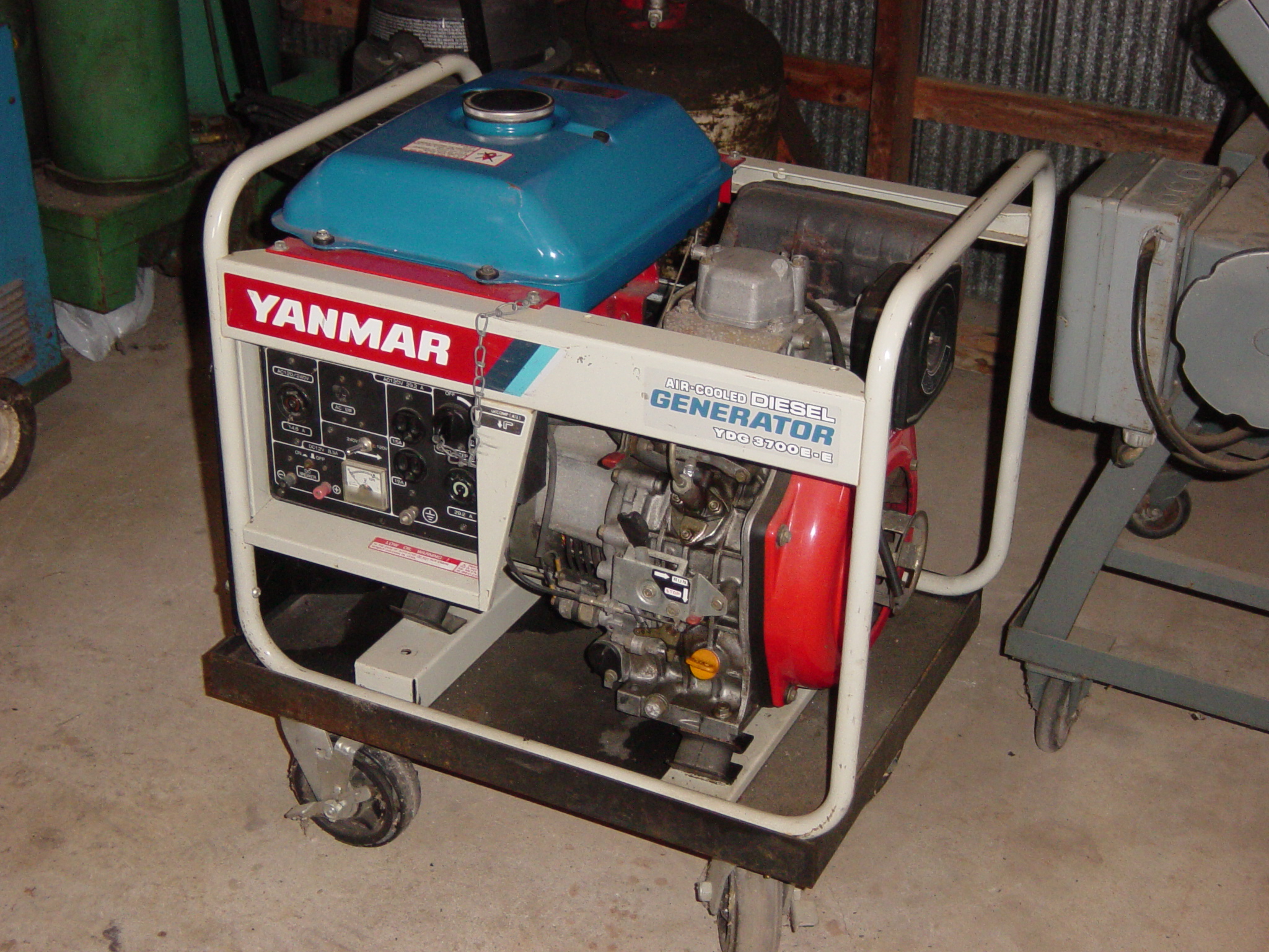

Is your machine a clone of this?
I was right. You can see the return hose flopping around, where the recoil starter went. Never a drop.
This rig will fire right up after not running for months in minus 10c.

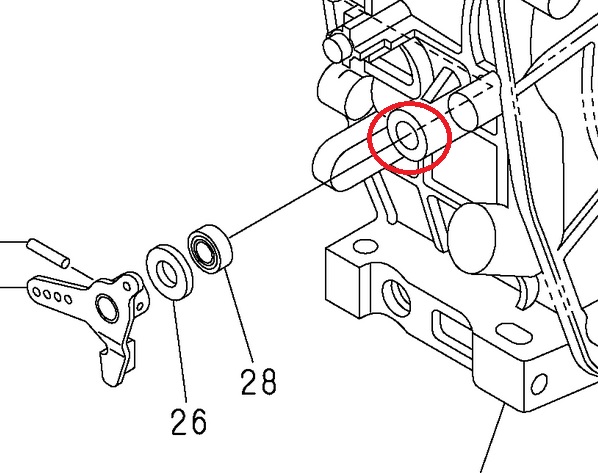

Hi
I will try to best explain the problem with limited (english) terminology.
My 186f motor leaks oil. It looks like its coming out from where the throttle assembly is.
The picture I attach shows where I believe the oil to be coming from. There is a oil seal (part# 114770-61600) and a thrust washer. How do I replace this seal? Is it done from the inside (Need to open the motor?) or outside? Can I attempt it myself? And can an online retailer be recommended that will ship internationally (I'm in South Africa)
I greatly appreciate any assistance.
Thanks
Jak

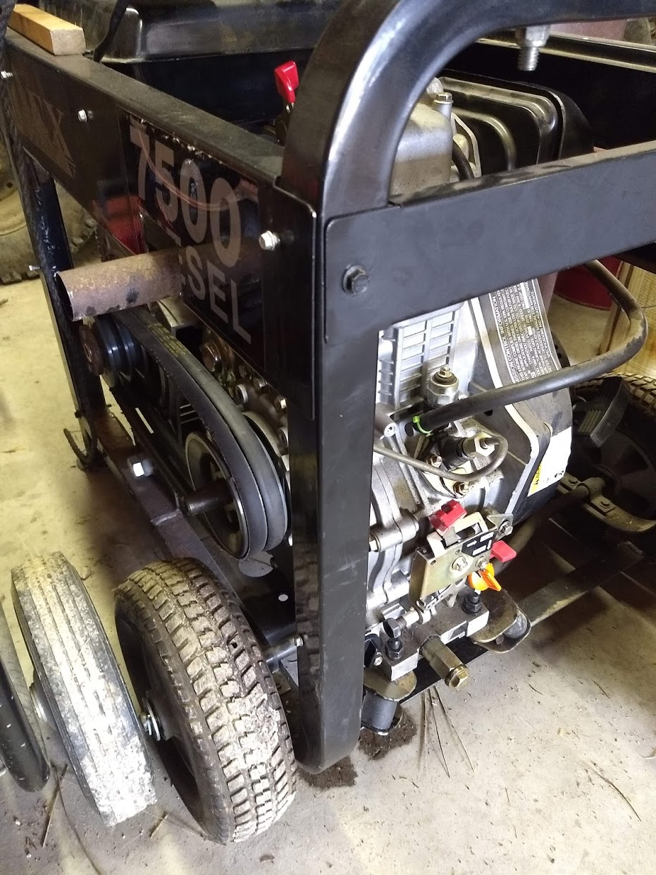

Hey All,
So, I did removed the muffler on my 186F due to it being restrictive at the outlet at the head. I welded up a pipe and stuck it on there. Runs better now but its deafening. I need some sort of a muffler.
Anyone ever replace a muffler with something other than OEM?
