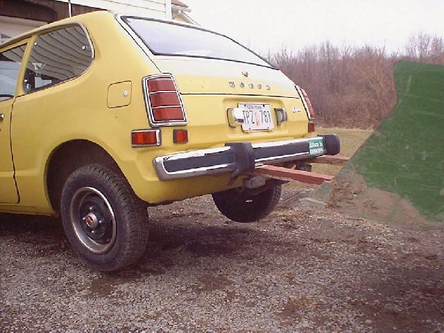

I like your idea. Before I saw yours I thought I'd try pressure treated southern pine 2X4s as forks. I cut a bevel on one end and they ended up 37" long (a little over 2' usable fork) for no good reason other than the length of one I had was 74". I wedged them inside the FEL bucket with a vertical 2X4, and lifted the rear end of my '75 Honda Civic off the ground with it (see attachment). Eventually I'll probably make something more permanant, maybe like yours, but these will certainly move piles of brush.

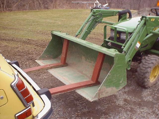

Here's a picture of the what's inside the bucket. The 2X4s were salvaged from a mobile home porch. I wouldn't use white pine or spruce, but southern pine or hardwood should work fine. This was strictly a "test" so will probably put a spacer between the forks and maybe a couple of other refinements. /w3tcompact/icons/laugh.gif

Duane, that is pretty amazing. I wouldn't want to be under that car but still pretty amazing just the same.
Spence
