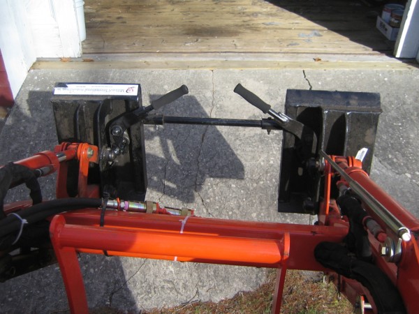

The LA1153 loader utilizes a "universal skid-steer" type mount system. So any implement that utilizes the same system (most of them do) will fit the mount.
   / Fork lift quick attatch #14
im looking to buy a b3030 with the universal skid -steer type mount system, does that mean i can buy skid steer buckets,forks....ect for the tractor and just hook them up or am i going to have to buy kubota implements to mate up to their system?
   / Fork lift quick attatch #15
If it is a "universal skid steer" adapter then you can use any of the non powered skid steer attachments. To operate any of the low flow hydraulic implements such as a grapple, you'd need to install either a diverter or rear remotes. You would never be able to use the high flow hydraulic implements such as skid steer Harley rake type attachments as you tractor doesn't have the hydraulic flow necessary.
   / Fork lift quick attatch #16
ahh well the only thing i plan to add is pallet forks and maybe a land pride post hole digger which the b3030 does have enough to gmp to run. they make a harley rake that you pull behind a small tractor. at least i know now what i was unsure about
   / Fork lift quick attatch #17
What I've been told (when I was looking at the B3030 a couple of years ago) is that the QA used on the B3030 is a Kubota specific QA scheme and that it is not until you get to the L series that it becomes a universal skid steer QA.
To get the universal on the B3030 you would need to buy an after-market kit. I suspect the B3030 owners on this site will be able to provide a more "enlightened" response.
Joe
   / Fork lift quick attatch #19
ahhh the plot thickens, lol
so then i dont need to order the option of the qa if i have to modify it anyway to accept skid steer stuff. there is a auction company by me that buys simi loads of skid steer implements and sells them cheep.
   / Fork lift quick attatch #20
I have a Horst Welding adapter which also works fine and might be less expensive than the ATI version.
