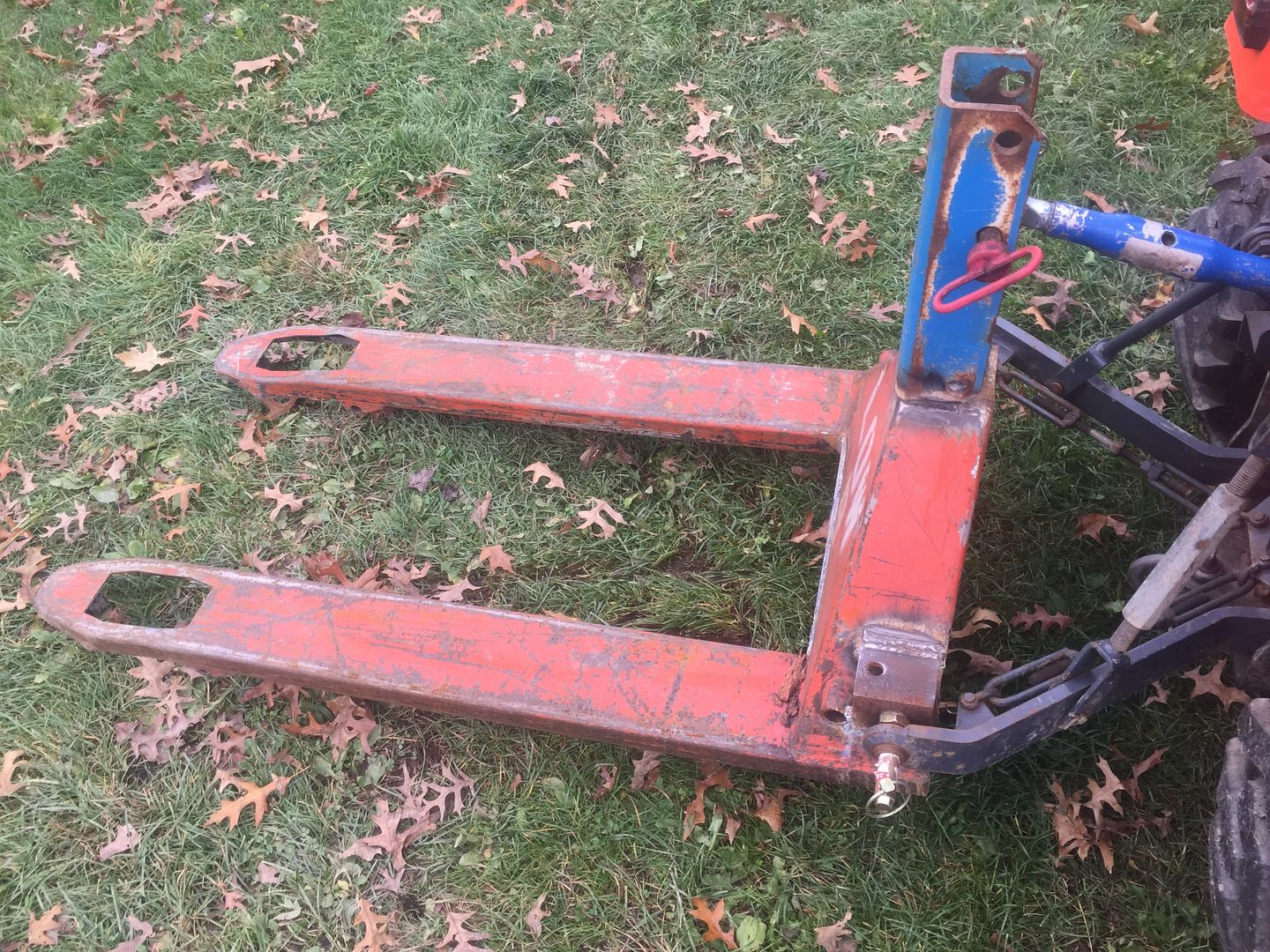

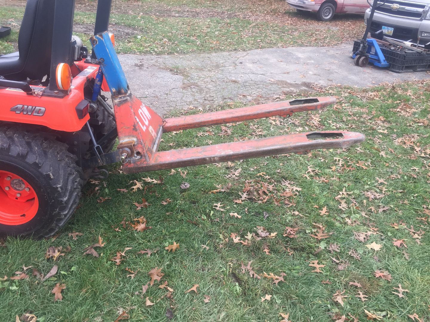

Anyways, I sold that little power house and now have a little kubota BX2230. My fork attachment with forklift 6K lb forks is just too heavy for the Bx's little lift capacity. I made a temporary pallet mover from a old broken pallet jack just to get me out of a bind, but the lack of adjustiblity really sucks,
So not being able to find little forged forks, what are your thoughts on 3"x2" 3/16" wall for my little machine that is rated for 5-600lbs of lift.

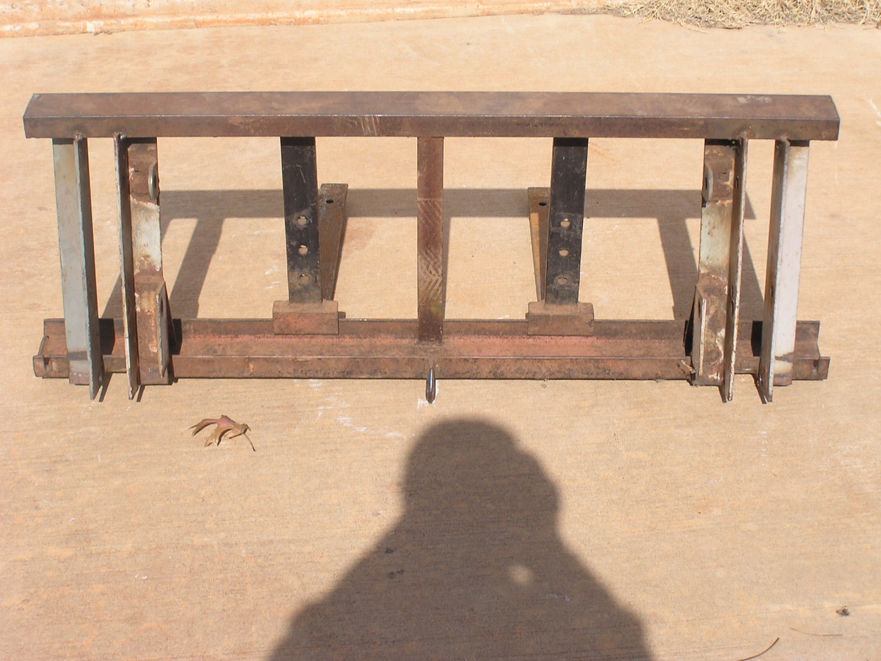

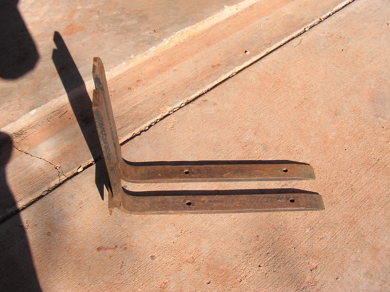

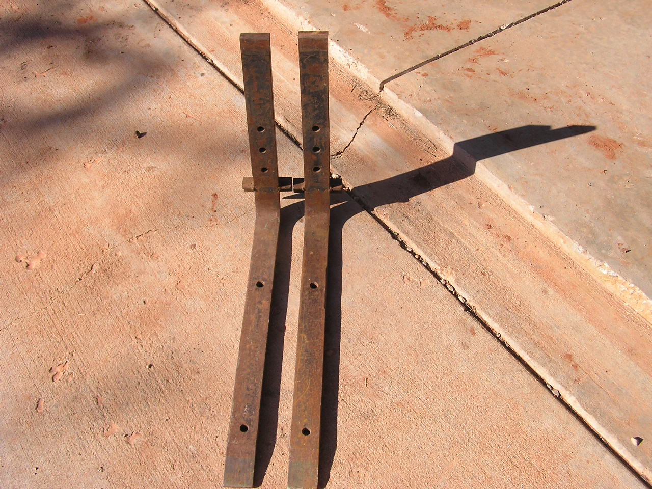

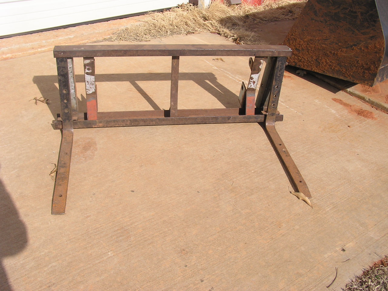

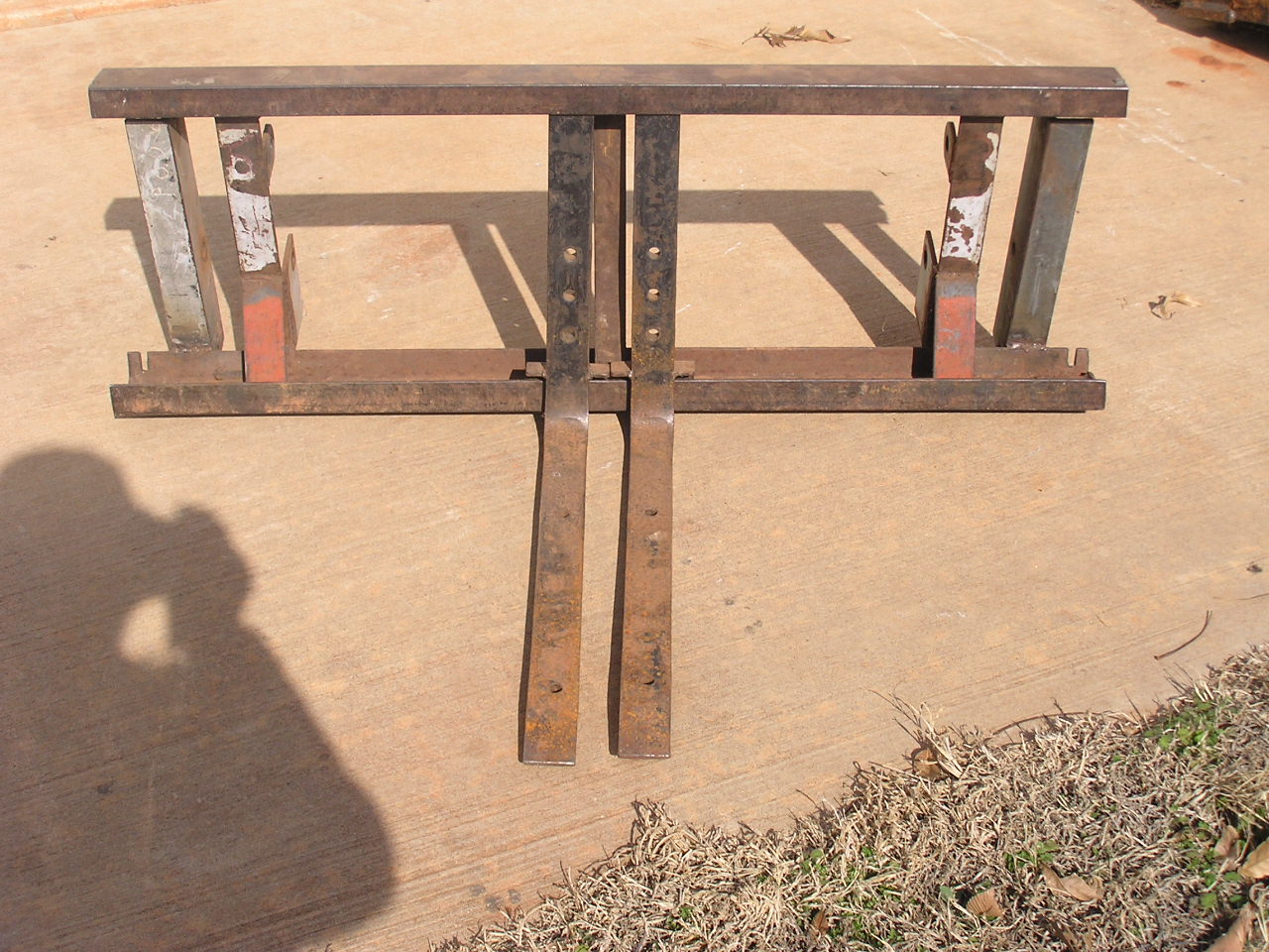

You might consider some flat bar. These are some old Brinly forks that bolted to their 3 point A Frame. I built a frame about 30 years ago to hold them, on a Craftsman garden tractor FEL. Then later added angle iron to use it on the TORO+Loader that can lift 800 pounds. http://www.tractorbynet.com/forums/...ter-put-together-post3204431.html#post3204431

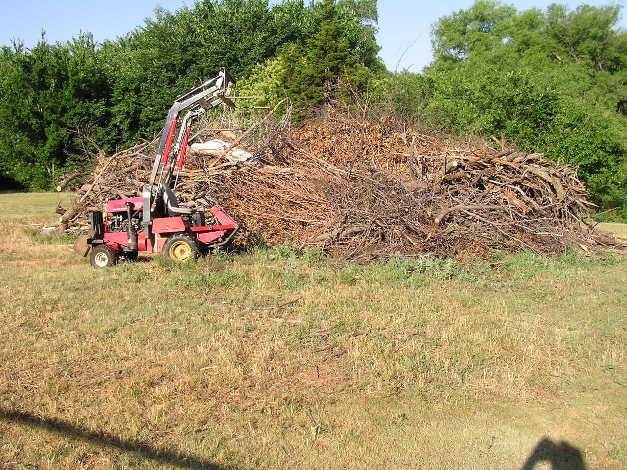

Made some big brush piles with it, "back in the day", here is one from 2006.

When I had my other tractor I built a 2x3x1/4" wall JD style quick attach style cage/frame and used 3/8 thick angle to use as the fork rails. It had well over 2K lbs on it a couple times with no issues, but the forks are forged 6K lb forklift forks and way too heavy for my machine now, I had them on the rear for awhile but the 3pt capacity was greatly diminished. I have since made a set of rear fixed forks from a pallet jacket and it works great on the rear and is light... this got me thinking about making something for the FEL once I do a legit quick attach, but I want them adjustable to make life easier. I don't have a way to weigh them, but the whole pallet jack weighs less than one of the forks....
old setup: (still have them, just too heavy)
