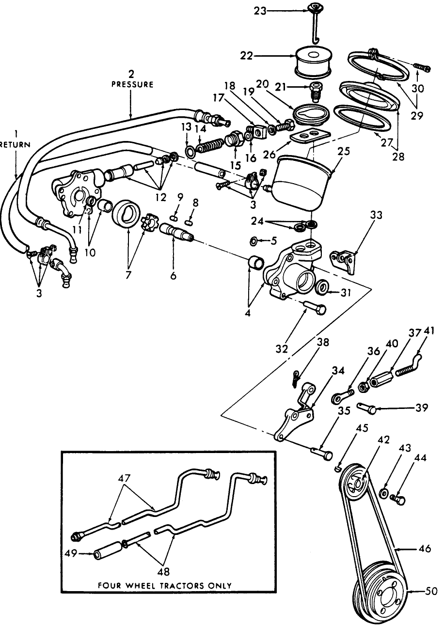

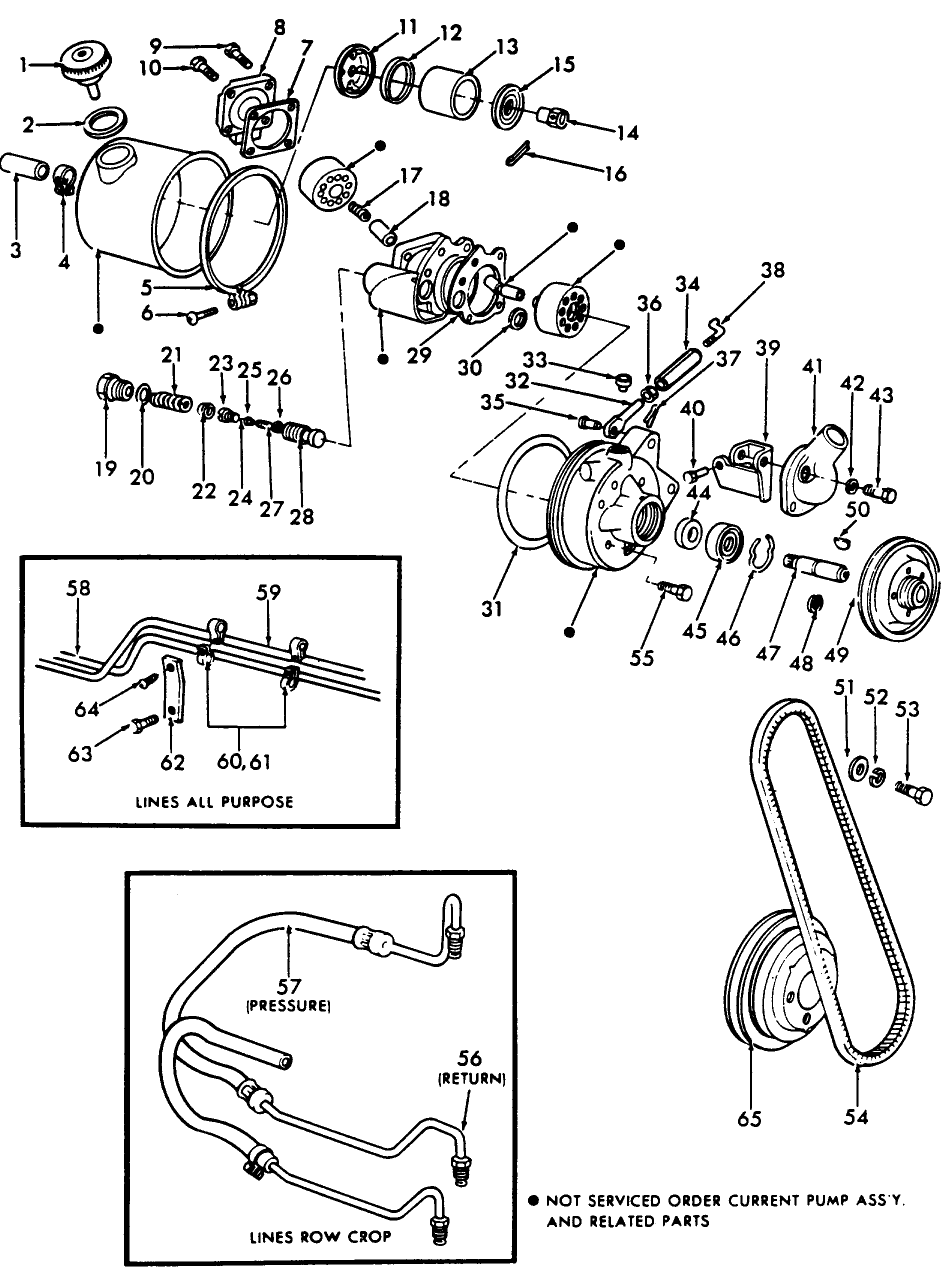

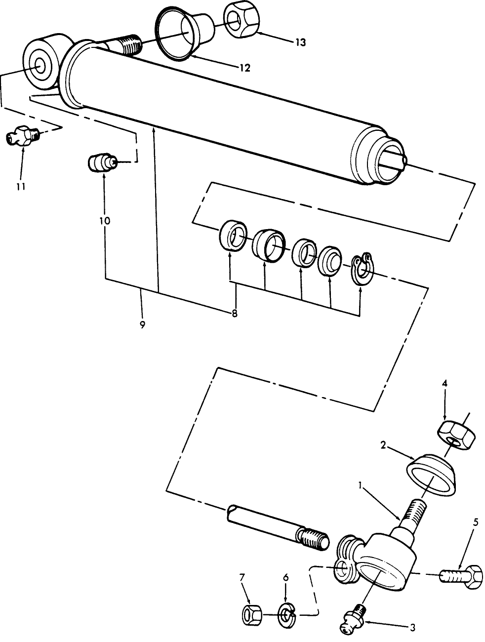

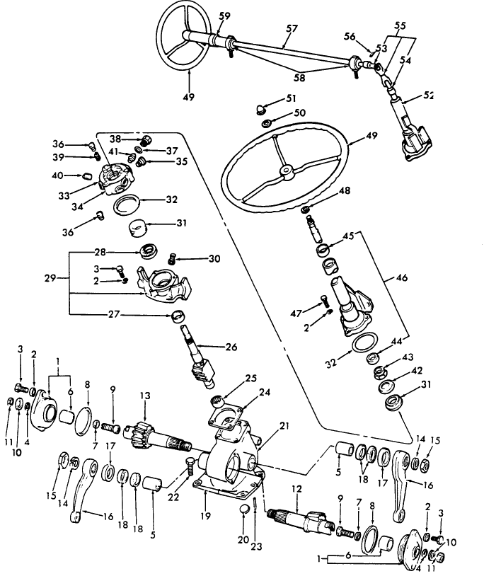

Hey folks,
I am in need of some Powermaster pictures, I have a 821 backhoe and its missing the part of sheet metal that covers the steering colum right under the dash, and also I would like some pictures of the power steering lines and cylinders, Mine has brakeline and I just dont think that is factory because they curve out to far, also any other pictures of a restored tractor would greatly help, I am working on the wiring right now but I took it all out and I am just going to wire it the way it should be, Its such a simple system

brake line is a good substitute.
the oem lines get damaged frequently,. and brake line looks better than hoses.. etc..

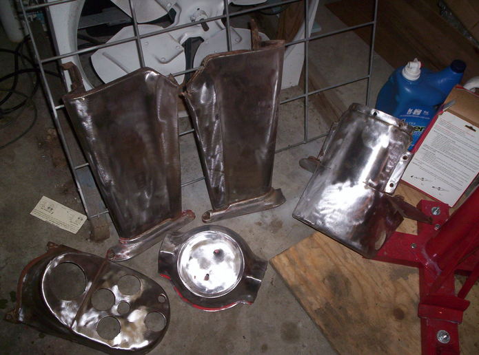

i'll dig up some pics of the cowling. I have fords with ps.. but no pics of the lines. I'll grab a diagram off the parts catalog though.. note: 2 pump setups depending upon sn...
post back if you need more pics.
thise pics are from different 55-64 machines.. but hood at the dash and cowling are pretty much the same for all straight gear models...
