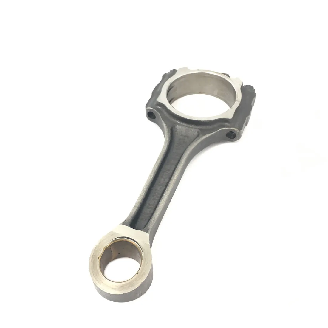

The 3.5l eco-boost is good for the F150 and that's about its limit.
the low rpm grunt of the 6.2l makes this an easy peasy task.
The 3.5l would not last in those conditions, nor pulling a 14k cattle trailer out here.
Lots of turbo load on those cute little pistons and con-rods, yeah don't think the Ford engineers designed them with low speed high torque demand on long stretches of highway in a super duty either.
Now on the other hand I've learned from a fella on a truck channel that Chevy's new 1500 has added a 2.7l turbo that is built ground up on a diesel platform, made to be solid performer.
Yet Chevy still uses a 6.6l gas and a 6.6l diesel, for the 2500.
This may still not be enough to answer your question, but it was the best I had! heh...have a good weekend y'all...
Guess which connecting rod below is from the big tough 6.2L, and which one is from the cute little 3.5L EcoBoost, haha
Every engine ever sold to the public has had to pass durability testing of a similar severity: hundreds of hours spent sustained at peak-power, full-load conditions. The 3.5L EcoBoost is designed to run at sustained full load just the exact same way the 6.2L V8 is. With that said, will it be as reliable in the field doing this for 150+k miles? Perhaps not. My only point is that from a design standpoint, it is robust and intended to work hard every day just like every other Ford engine.
