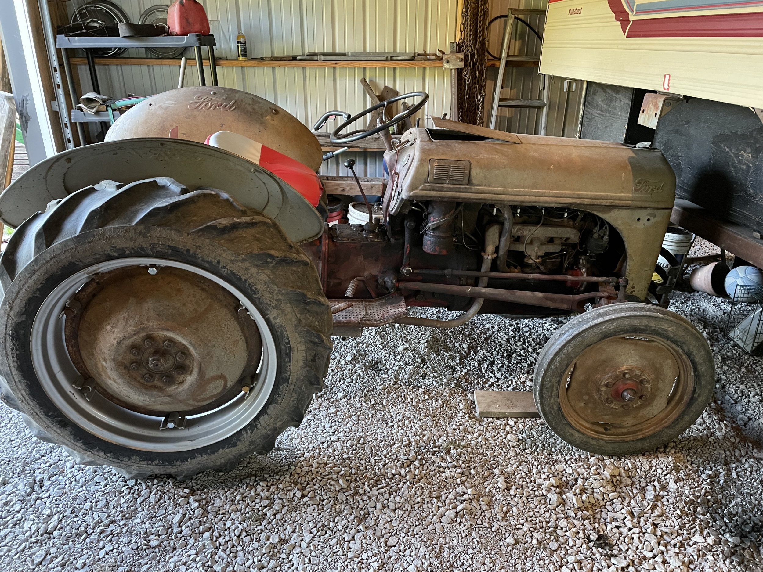

Yes it is, my title is not correct since knowing the serial number and retrieving the tractor. Got this one for free as well.
Runs well after a carb rebuild and oil change. Next I need to clean the old tank and check the hydraulic fluid for water.
They are pretty simple and easy to work on.
Except the pump is in the bottom. So if there is water, it's in the bottom. Freeze and bust.

If you haven't figured out yet the lift system does not use Hydraulic Fluid but Gear oil it is old old school but works. You will probably have to flush it a coupe of times to get all the sludge out of it.

I am glad you said something... Finally getting around to doing this. I pulled the drain plugs, first water, then milkshake!
Reading some other threads, guys cleaned it out with kerosene through the observation plate. My dad wondered if running regular ATF through it would flush it out before running the correct stuff. In my reading, use the common Universal Tractor Hydraulic Fluid? Thanks

It is back home with 3/4 tires holding air. Runs well too!
All the fluids should be gone through, already did an oil change.
It's running on a auxiliary tank until the stock one is cleaned out.
TSC sells the correct fluid.
Look at / replace the gearshift rubber boot. Even if not real cracked, any rain that hits there, will drop into the trans/hyd oil. Reach in and scrape out the built up gunk on the bottom of the case.

Can't remember how many Ford N's I got to drive around the section(4 miles) with diesel in the transmission and rear end to clear out all the built up gunk. Sometimes they took 2 or 3 runs like that until they cleared up. Didn't seem to hurt anything.
Did you cut the fluid with diesel fuel or run that straight?

We just ran that straight. When I was a kid it seemed like we had one come in to the shop like that once or twice a month at least.

I always used straight diesel to clean them out, fill it and drive it. I just DO NOT run the hydraulic pump more than a few minutes since I do not feel like diesel has sufficient lubrication for the pump. Diesel in a hand pump sprayer to wash down the upper case helps.
Every diesel I know of has a pump. And they typically last longer than any hydraulic pump. But I guess you could say an injector pump is a hydraulic pump. :unsure:
