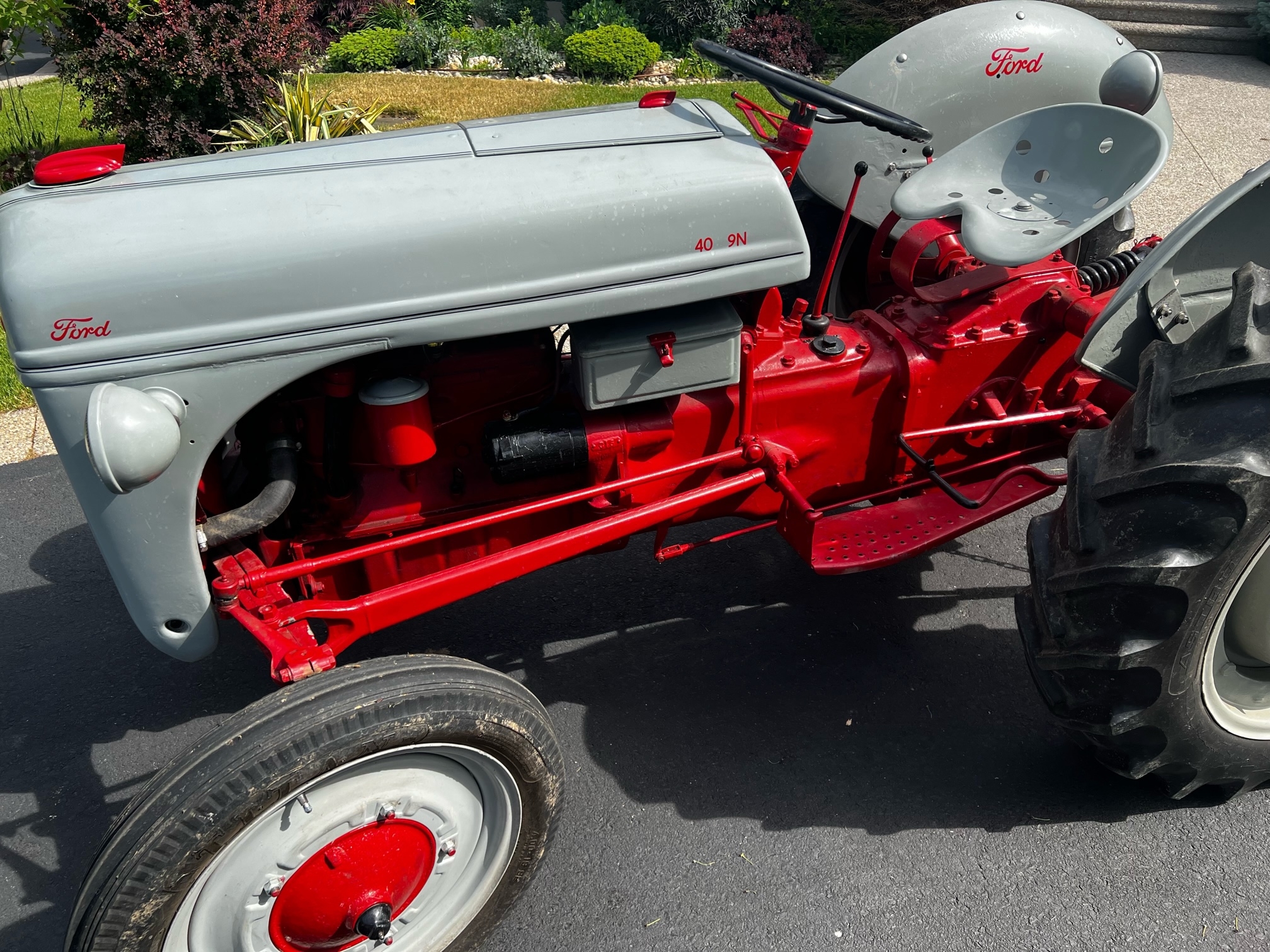

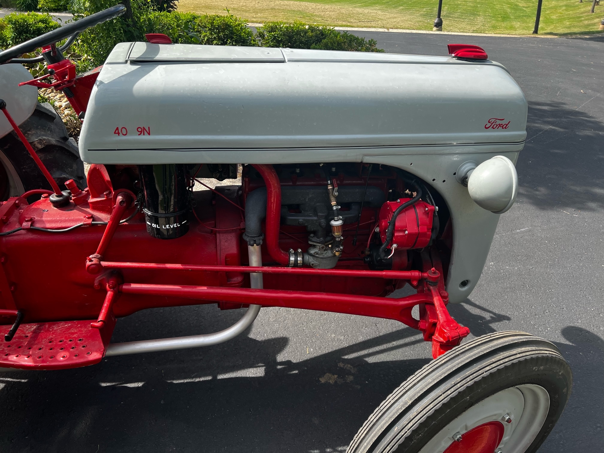

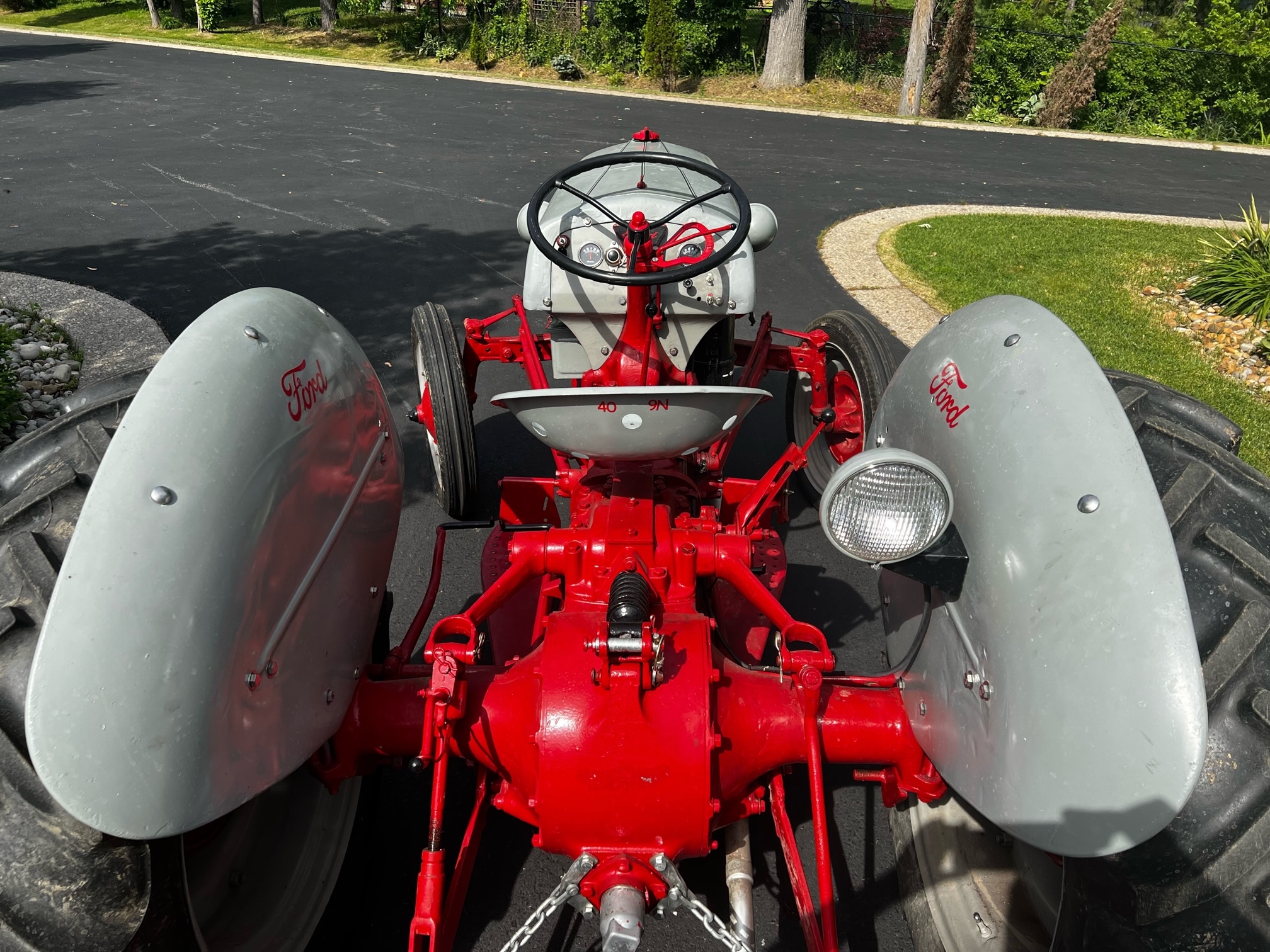

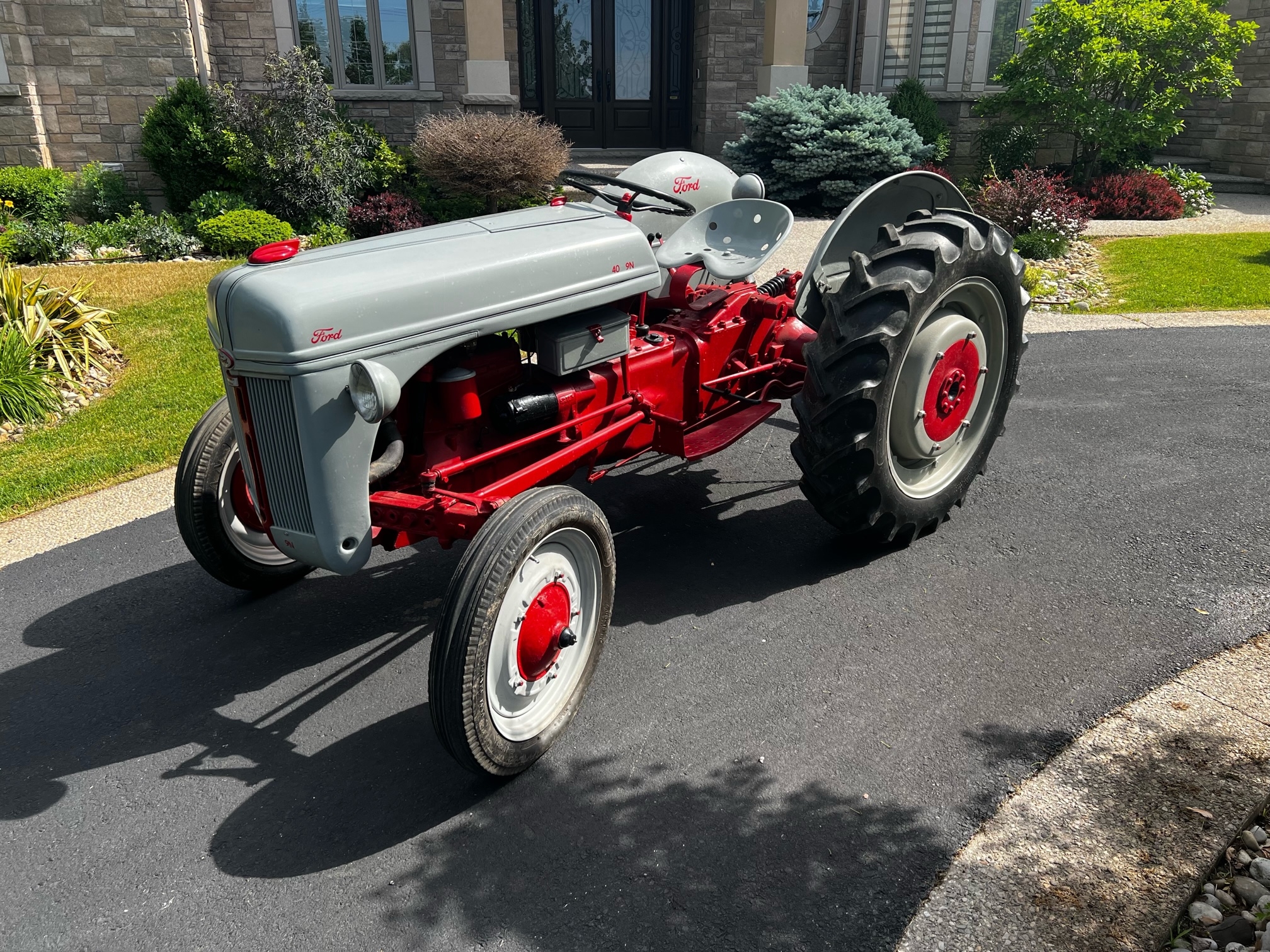

Hello. So, I don't know a lot about the Ford tractors. I have an Allis and a couple Massey's. But I found this 1940 9N for sale.
He wants $6500 CANADIAN. Is it worth it? I just use them for shows and parades. No real work. But anything to look out for?
I see it has an alternator and 12 volt conversion. And I see he added a gas shutoff and inline filter. Any alarm bells you see here?
Thanks.

Nice older tractor, but is that fuel filter in backwards?
If taking this to shows, the fuel filter, shutoff valve & clamps stand out like a sore thumb in what looks like otherwise nice restoration, I suppose same for the alternator.
Yes I understand they are all very practical if the tractor was used for any work.

$4800 USD would put it at the high end of 9Ns around here. If it's a good paint job, runs good and everything works, that's a pretty fair price. But as Art says, the valve and filter make me cringe for a restoration. Easy enough to change or hide though. (y)

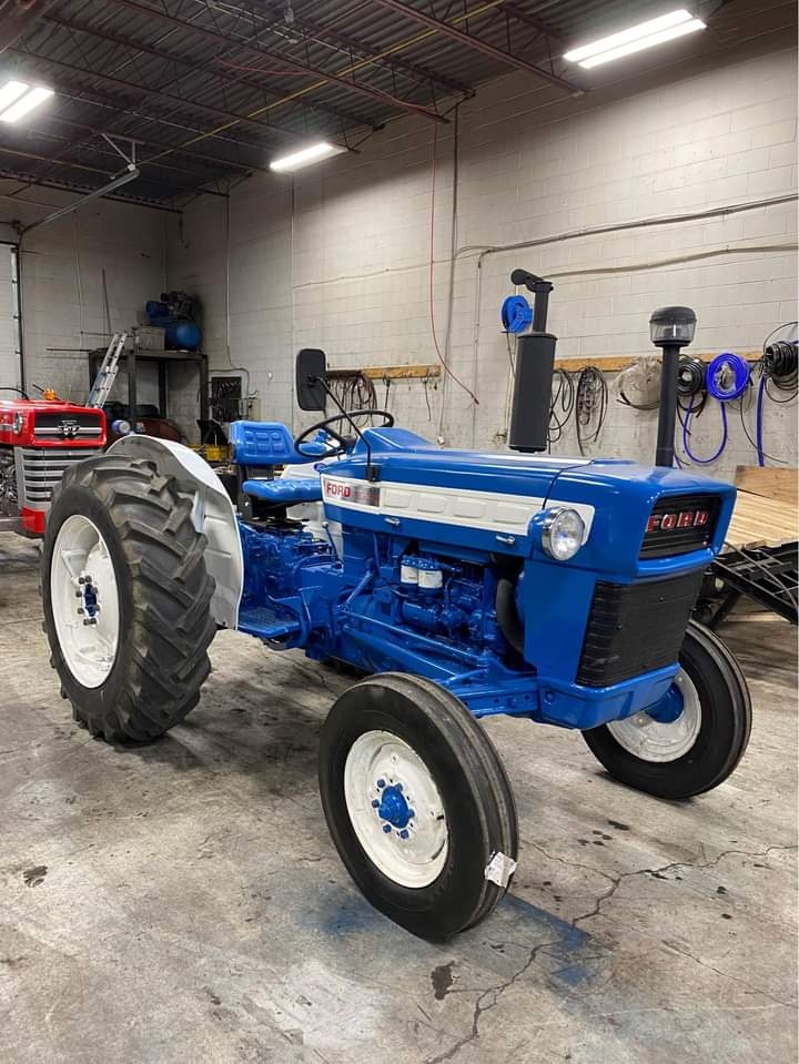

I had found a beautiful Ford 3000 diesel fully restored but he won't move form $11,000.
Let him continue to enjoy that tractor. Maybe 4500 in excellent condition. I don't care if it has air conditioning.

Like you said a video is going to be able to tell you a lot and a live video chat will tell you even more. This day and age even if they are older individuals they probably know someone that can do a video cal or send vids for them. Cold starts, fast throttle response, engine knock, timing or carb issues can readily be picked up.
Changing the brakes on these old fords is pretty simple if you have ever replaced drum brakes before.

A couple of things: from the engine block
#1 Have them send you a pic of the "stamped" serial number.
#2 Find out if it is a 3 or 4 speed transmission. 9N is a 3 speed and 8N is a 4 speed.
Also, the "floor boards" came on the 8N. 9N had "foot pegs".

Here's my 2-cents: If you want a parade tractor, then generally you want a restoration. The original color of a 9N is battleship gray, not red and medium gray. Inline filters like that are not only not original, they can often be an inhibitor to good gas flow in a gravity-delivery fuel system like the 9N. It came from the factory with three filter screens, two in the sediment bowl and one at the fuel inlet. Also, I'm not a fan of using a rubber fuel line that close to the manifold. Pre-made, metal factory fuel tubes are available. Parts are easy to get in the U.S. but shipping costs make them tougher in Canada. The original carb is easy to rebuild, the aftermarket ones from the "land of almost right" are crap shoots. If you can share the serial number (location shown in pic) I can tell you the year.
If you want a worker, the 9N only has draft control - NO position control. It also does not have live hydraulics - you must engage the PTO to use the lift.
I live in a farming community in central Virginia and that tractor might bring $1,500 US, at best. The early 3000 you showed might bring $5,000 US. The 3000 is a strong utility tractor and I really like them.

Ed covered it, as for parts you can get everything to completely rebuild the 9/8 N tractors. Many good sources are out there and if cost does not scare you the Dennis Carpenter has many of the original dies and castings for the old tractors to make the parts.

That Ford 3000 diesel was really nice looking, but I just don't know if I want to pay $11,000 Canadian for it? Everyone seems to think that is steep.
