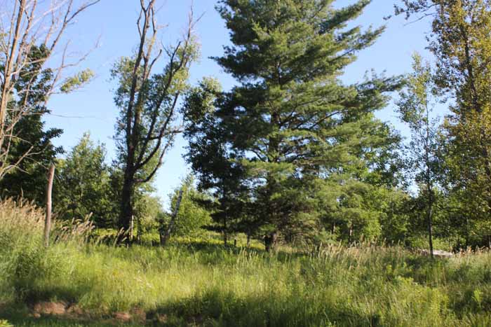

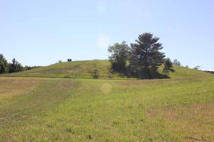

I purchased a Ford Flail over the weekend and noticed it was out of balance
so I checked on the cutters and noticed some missing.
I used what were on the machine to balance out the cutters and it worked great.
It is a 72" machine that had 9 cutters per row for a total of 27 cutters.
I took off the outside cutters taking it down to a 60" cut.
I am using a small tz22 with this and did not have any issues with cutting
even going up a large hillView attachment 271821
I am wondering if adding the outside cutters back on if it will cause it
to bog down a lot more or will the force already created keep it going smooth?
I know this is a small tractor for such a beast but it is able to lift it and cut some
very thick grass if I slow down enough. [
ATTACH=CONFIG]271822[/ATTACH]
The machine ran very smooth until I threw another blade,
now trying to find replacements through flailmaster,
but they are not answering their phone today.
