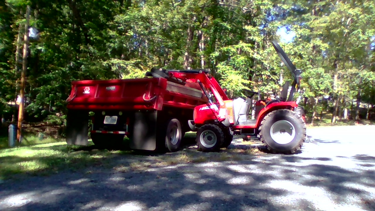

The new compact tractors are a good way to go & they are emission exempt if a diesel 25 or less horse power no regen required or def & the torque is awesome along with power at the PTO & you pretty much need 4wd if you get one with a FEL & the weight of the tractor is another factor & on my M-F 1526 with a 3 cylinder Iseki engine is a proven power plant & they don't need a turbo , & they are easy on fuel consumption. They are as close as you can get to the older utility tractors & the newer one without all the problems previously mentioned of a bigger diesel engine.& on my 61 year old M-f 50 I like the the gasoline engine at 34 HP & that it's a 2 speed high low manual transmission making it 6 forward & 2 reverse & being gear driven you can start off in any range you want & with the newer hydrostatic tranmission your speed range is limited when working in 4wd & using the FEL . But these 2 tractors working together compliment each other on what they can do & can't do & both tractors work year round & both have there assignments & 2 tractors are better than one when it comes to not having switch out implements for different task & yes I know about the quick connects But we are beholding to the weather & I don't want to rely on a weather man who gets it 50/50 most the time & as far as the old & the new tractor I'll keep them both, after all there a work saver.
