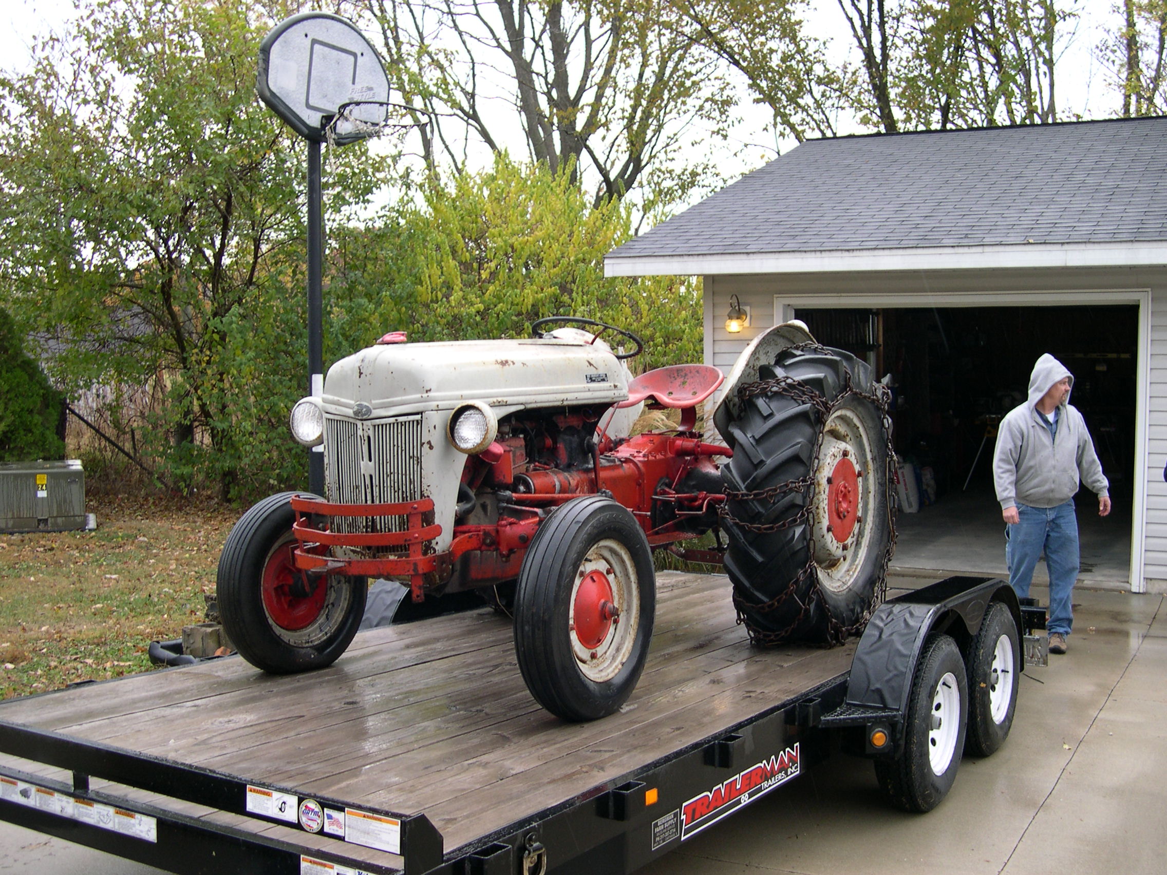

This was what I think was a 9N I towed home for a buddy years ago, he never did get it running, it just seemed very primitive to me.
