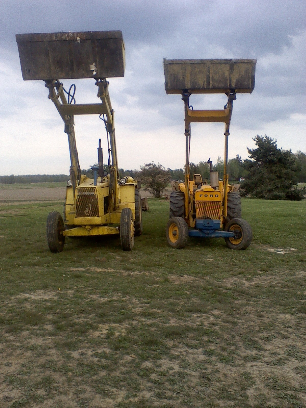

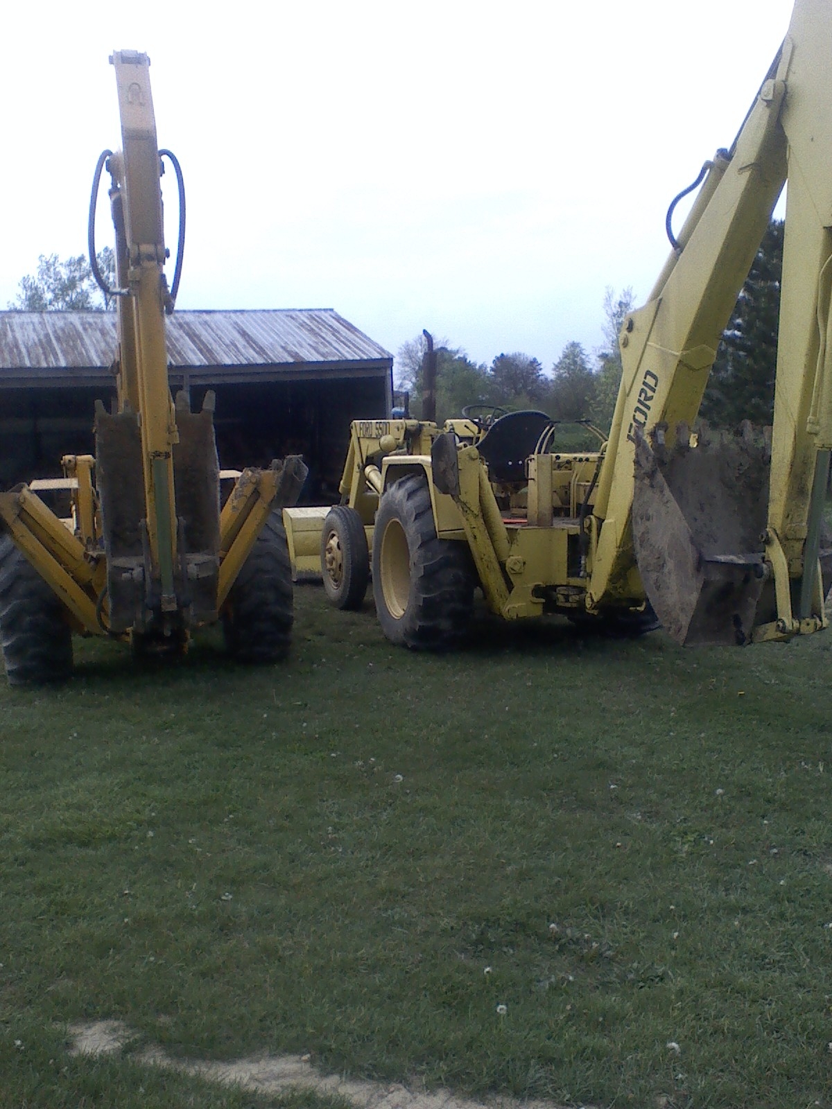

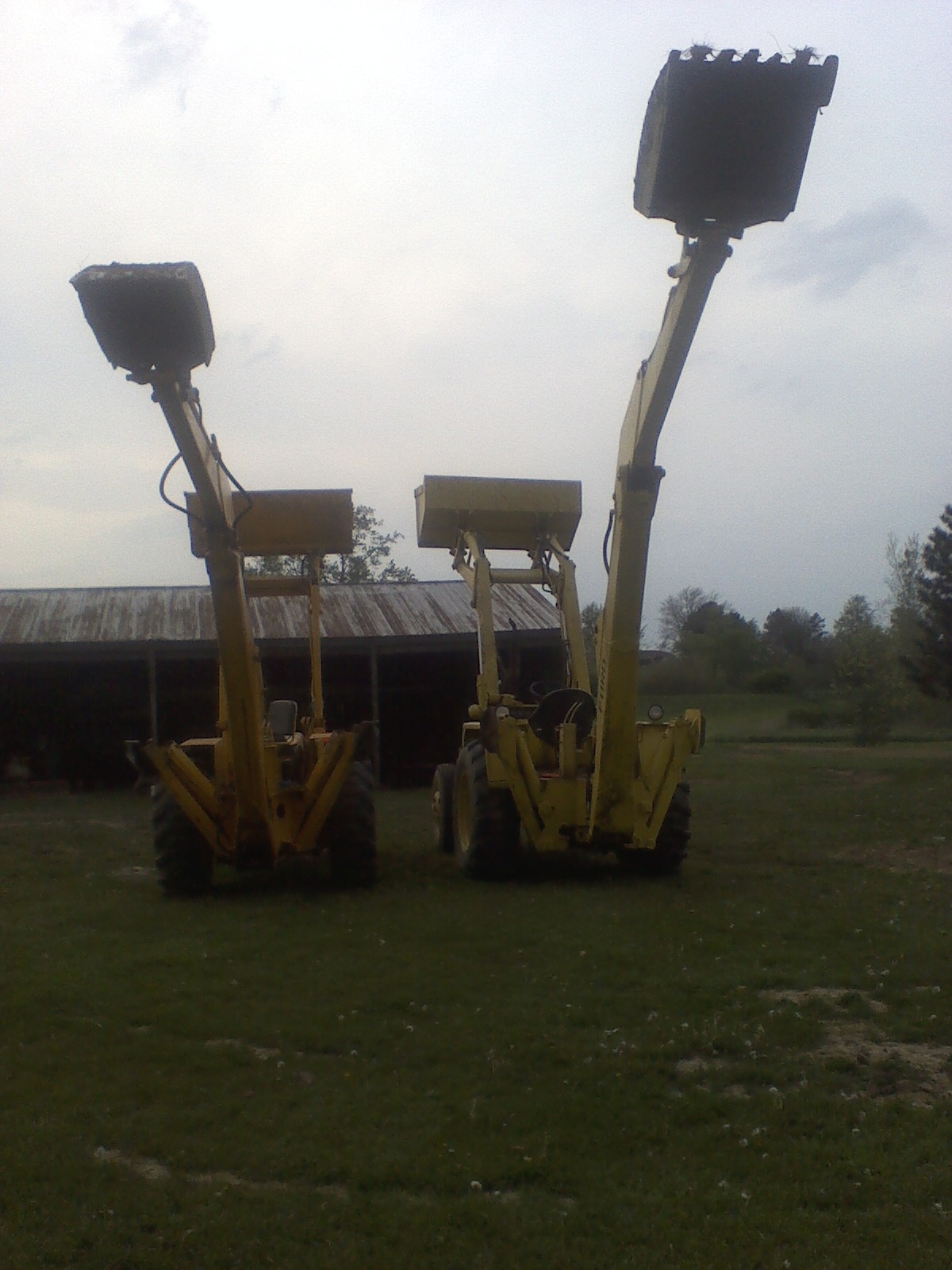

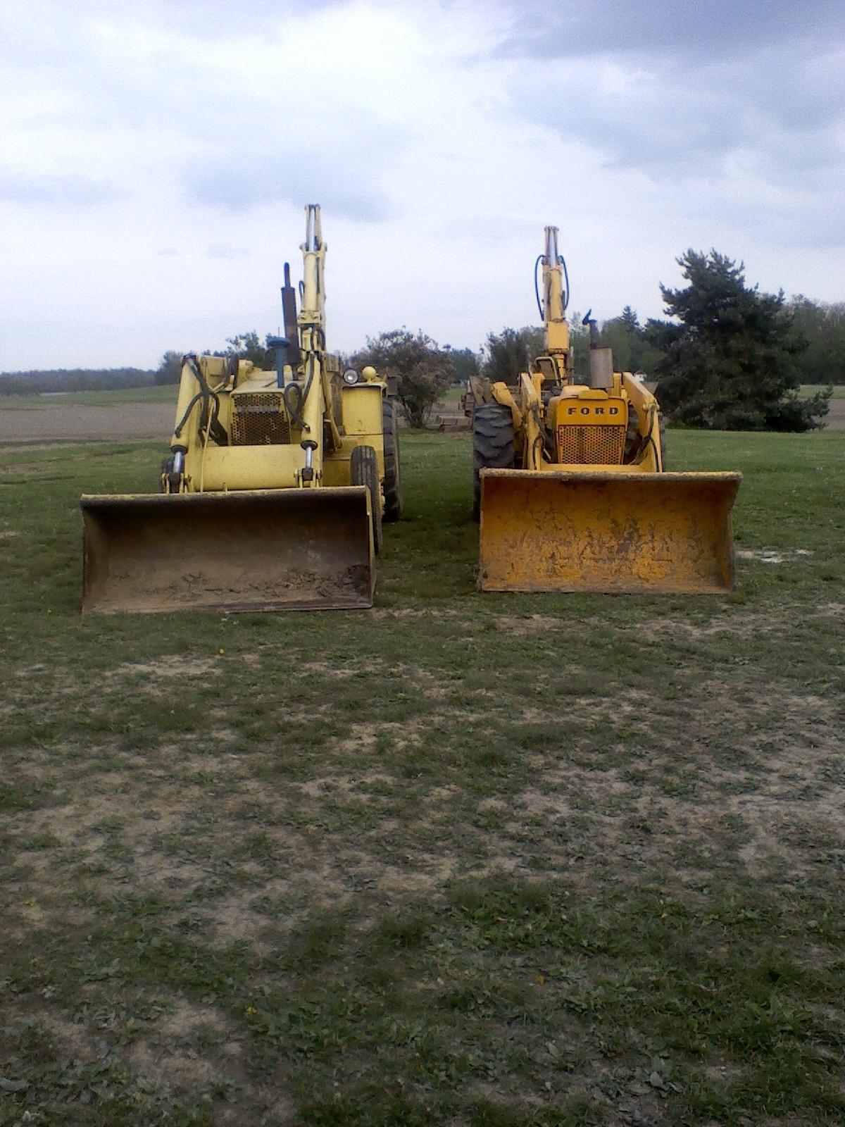

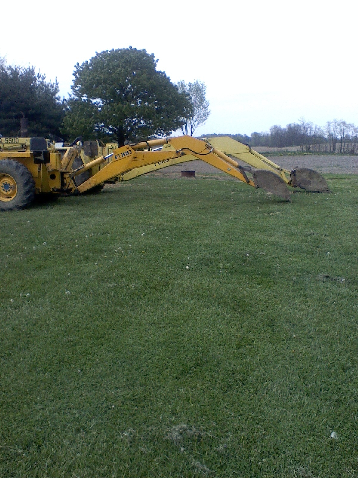

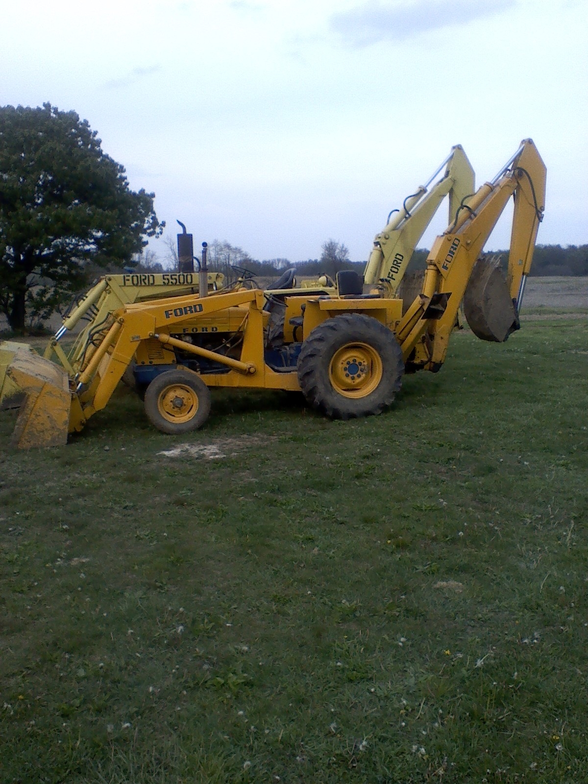

OK. Now that we know what it is... maybe.... or at least that the hoe is a 755. And 4500 will do for the rest until you find out differently
So the important question....How does it run? Does everything work?
And is that paint job yellow on blue or vice versa?

Enjoyed the video. Haven’t figured out how to post mine .The adventure will continue tomorrow. Twenty mile drive mechanic following.The paint is yellow on blue . I will be driving over newly done cobblestone driveway.I’m bringing plywood and have asked driveway guy to be there.funfun

Well, yellow over blue and the C7NN casting number in the block would make it a late 60s early 70s model. The very early industrials or at least the 3 and 4000 models had blue powertrains.
Also, canister style engine oil filter is pre spin-on.
6x4 manual reversing transmission is simple and reliable.
Make sure you inspect and grease the hydraulic pump driveshaft on the front of the engine. Also inspect and grease the steering mechanism in front of the radiator. Hopefully it has been greased previously and not worn out.
