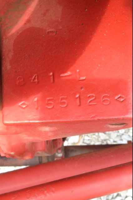

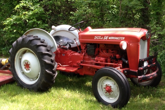

Hi everyone,
I am new to the site. Does anyone know if Ford made a 641 Workmaster with a 172ci engine? My tractors serial number says its a 1961 and right above that is 841-L. the hood and grill do not look like an 841 powrmaster, they look like the 641 workmaster. any help figuring out excatly what i have would be appriciated.

Dave is it a four or five speed. 1962 was the last red/gray ones sold so I guess anything is possible. Is the 841 number on the bell housing/transmission area. I am almost certain that part was make for an 800 based on on we had.

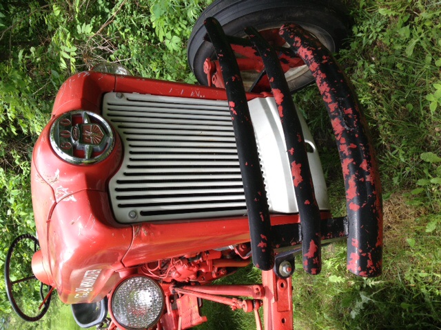

These are some pics of my tractor with the serial number.
   / Ford 641 Workmaster Questions and Advice #58
It's a four speed tractor. The numbers are on the left side, right behind the starter on the transmission case.
   / Ford 641 Workmaster Questions and Advice #59
Thanks for the response Gale. I have attached some pics.
