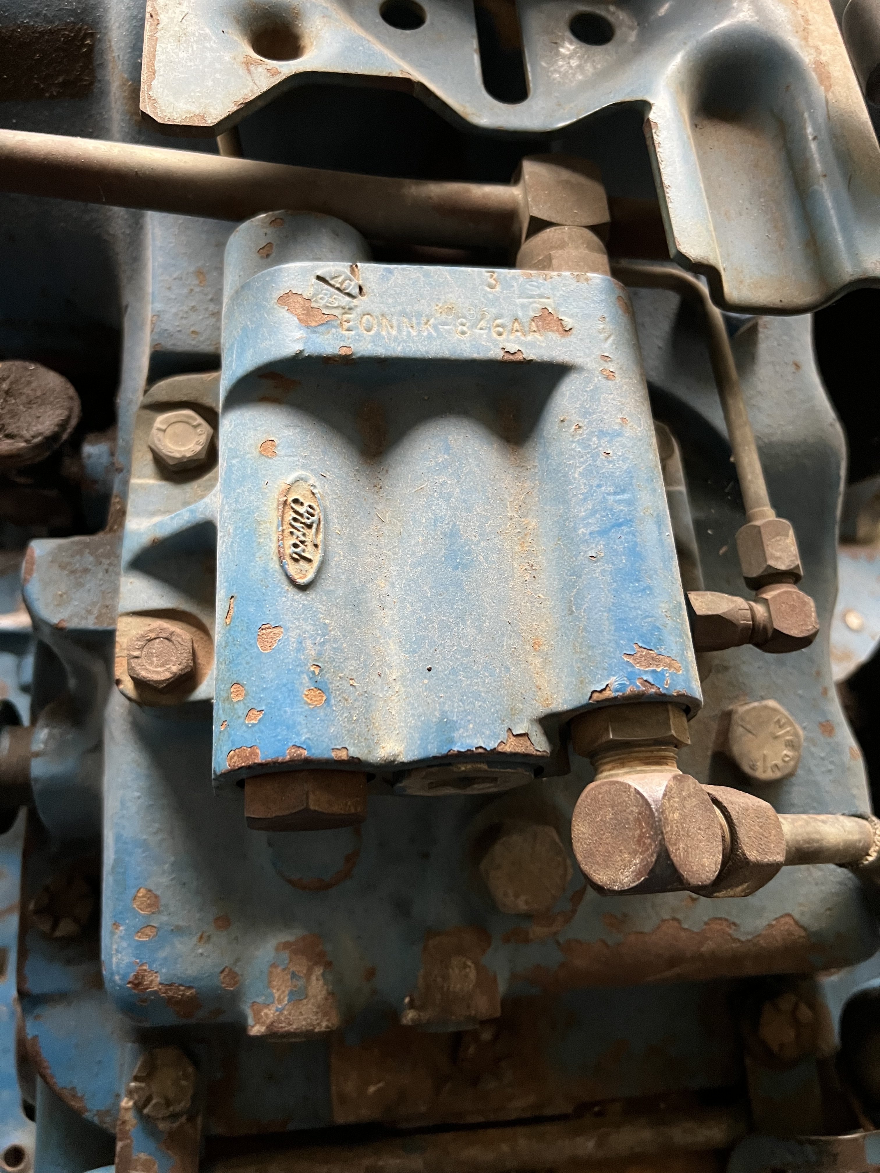

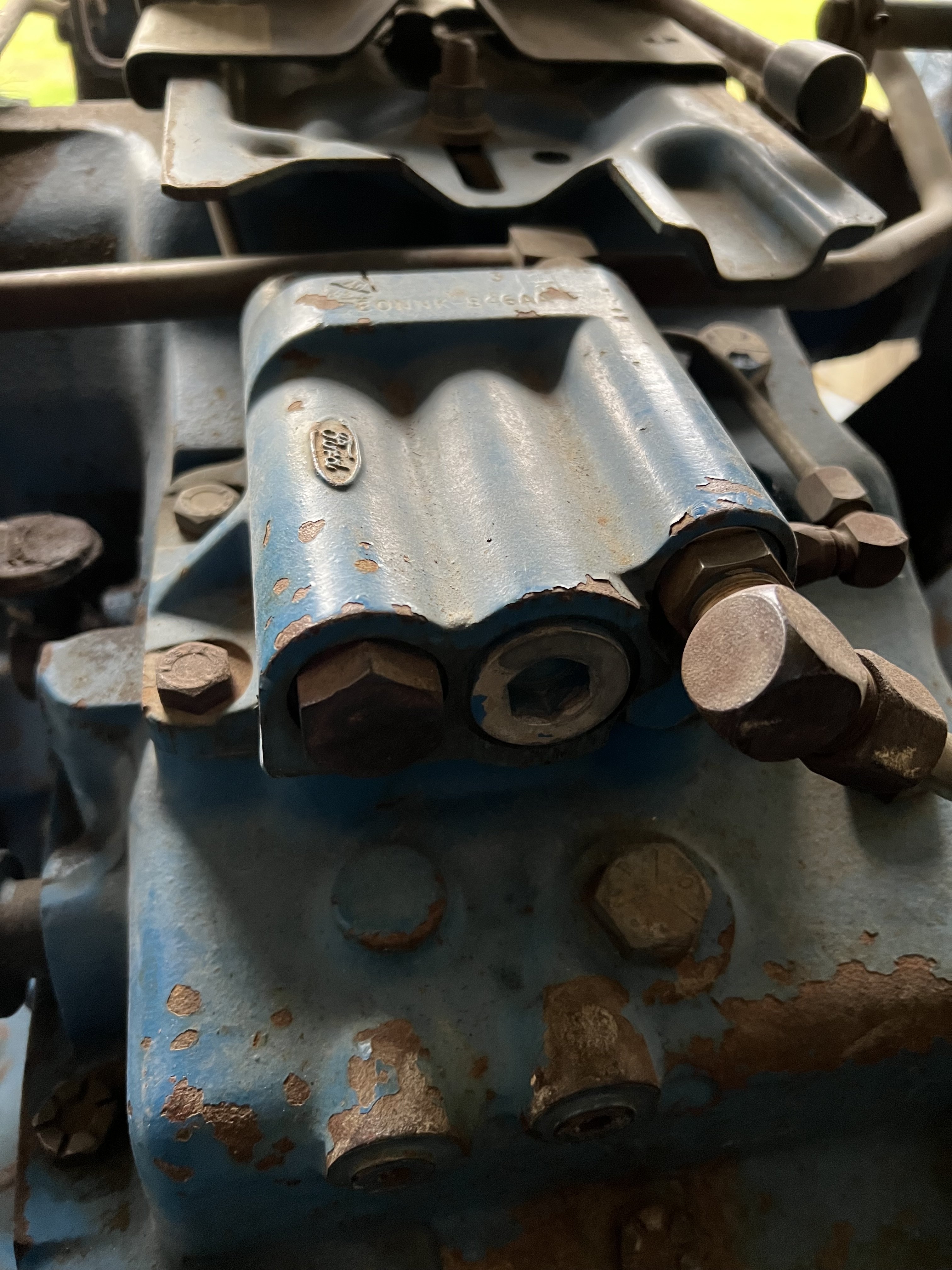

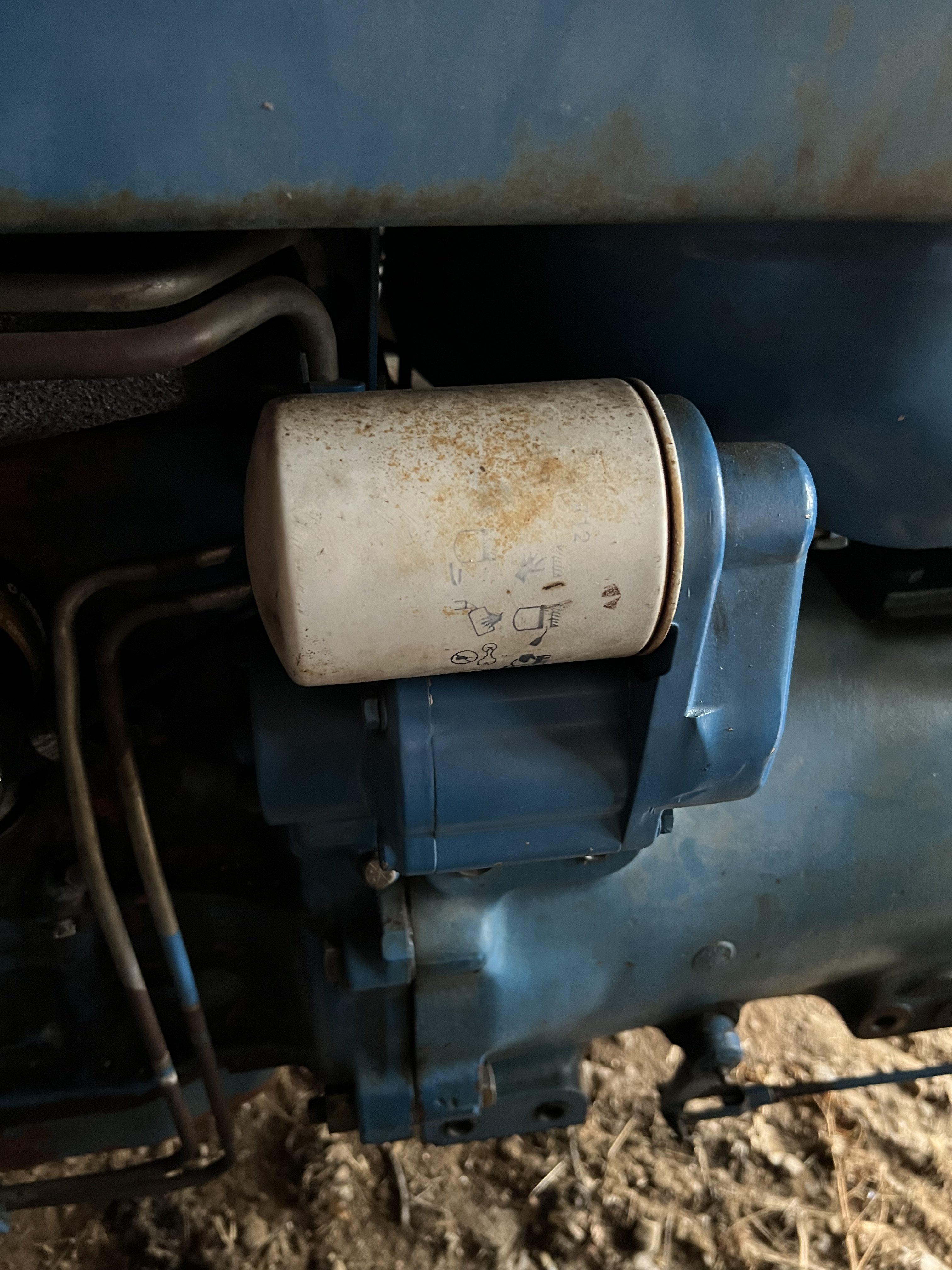

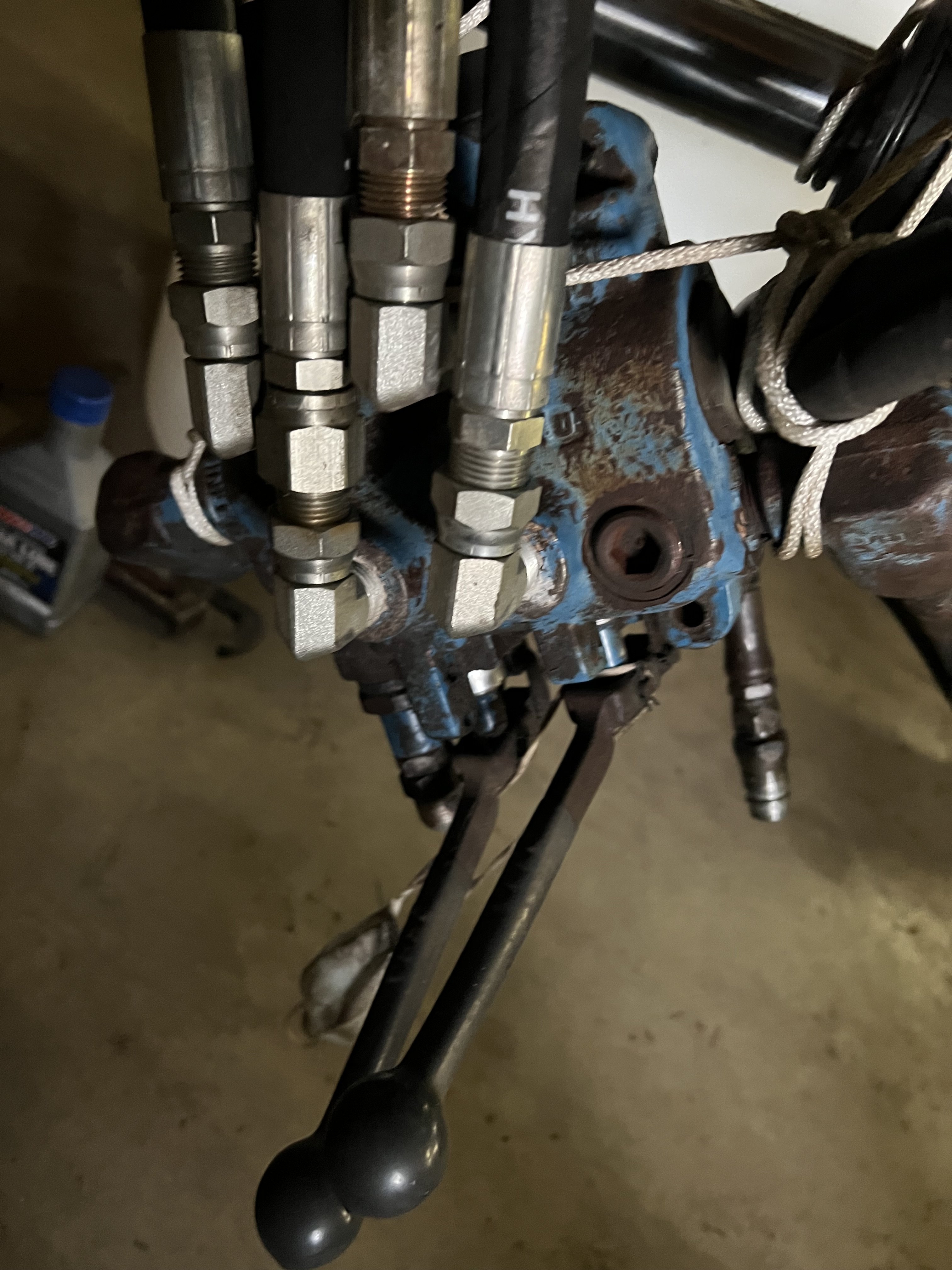

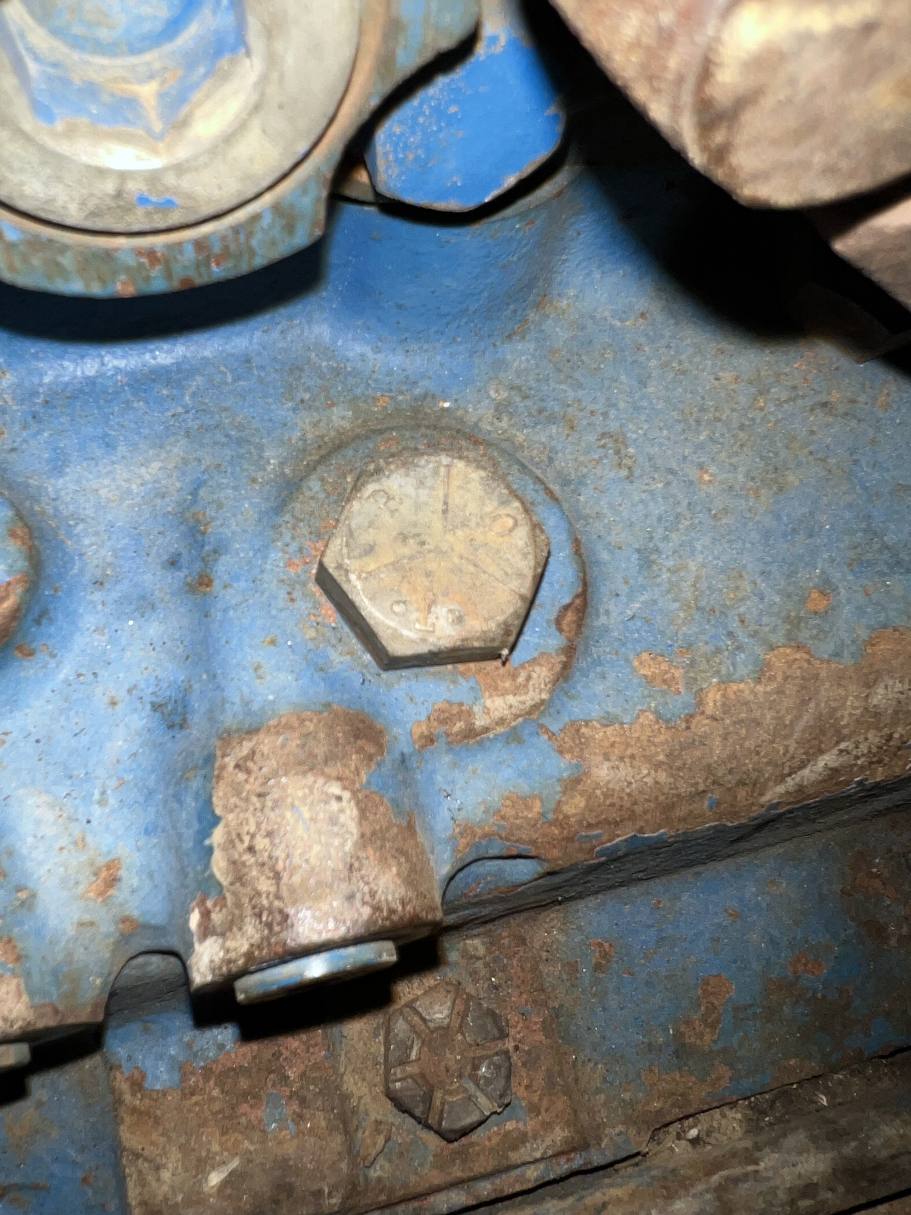

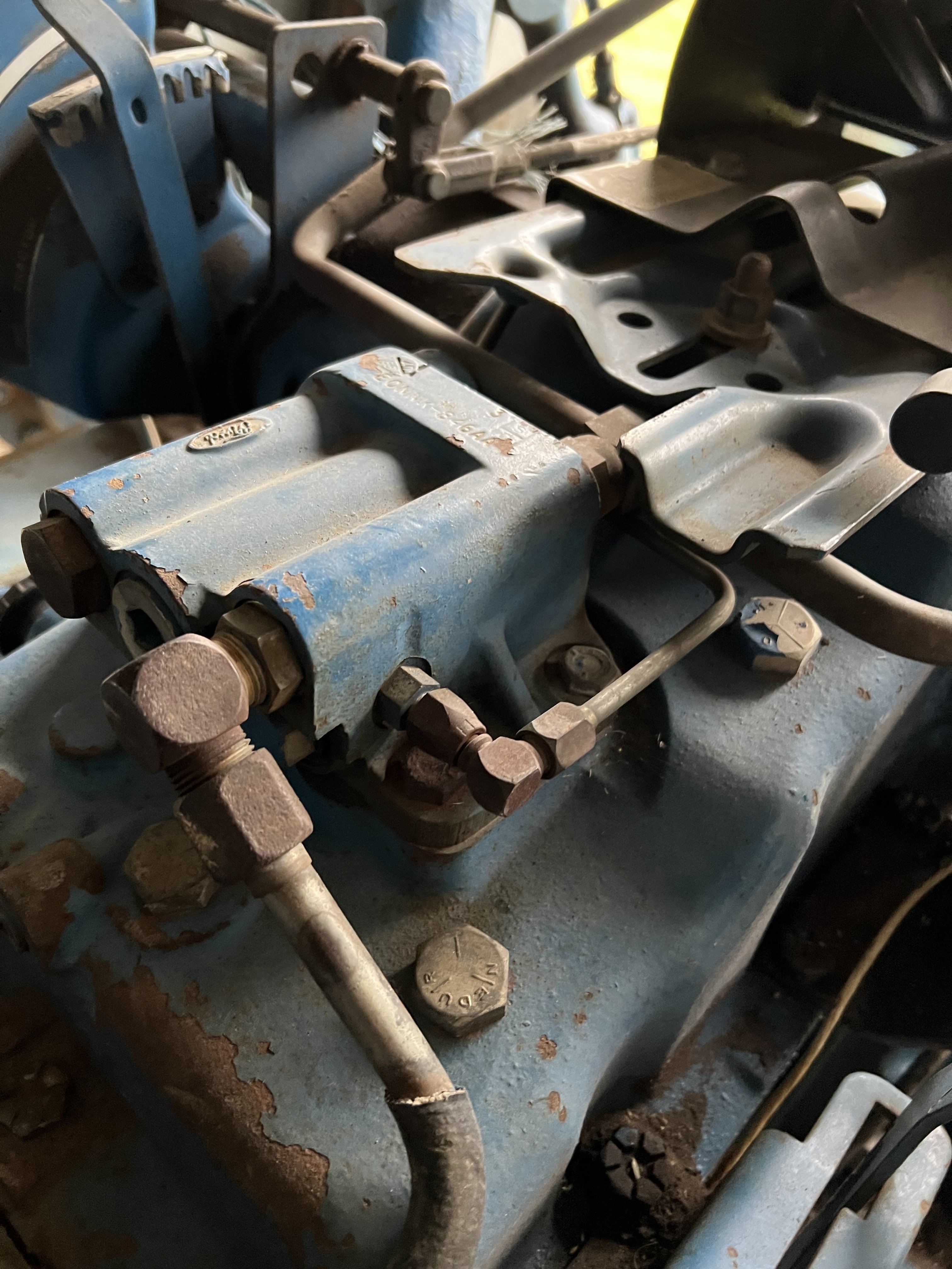

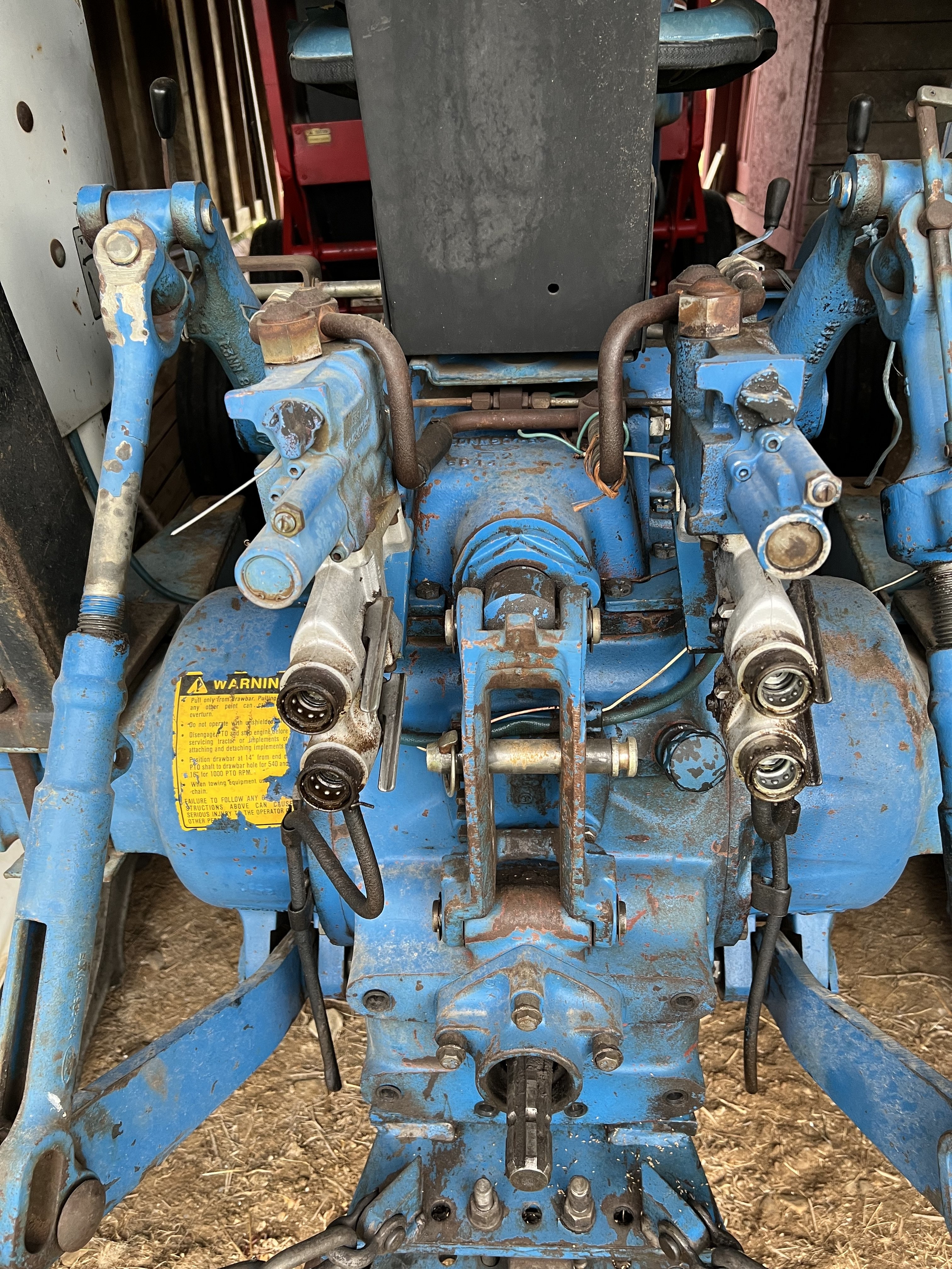

Got some pics for you guys if I can figure out how to send them.
/ Ford 5610 tractor , hydraulics
Hope they made it out there .

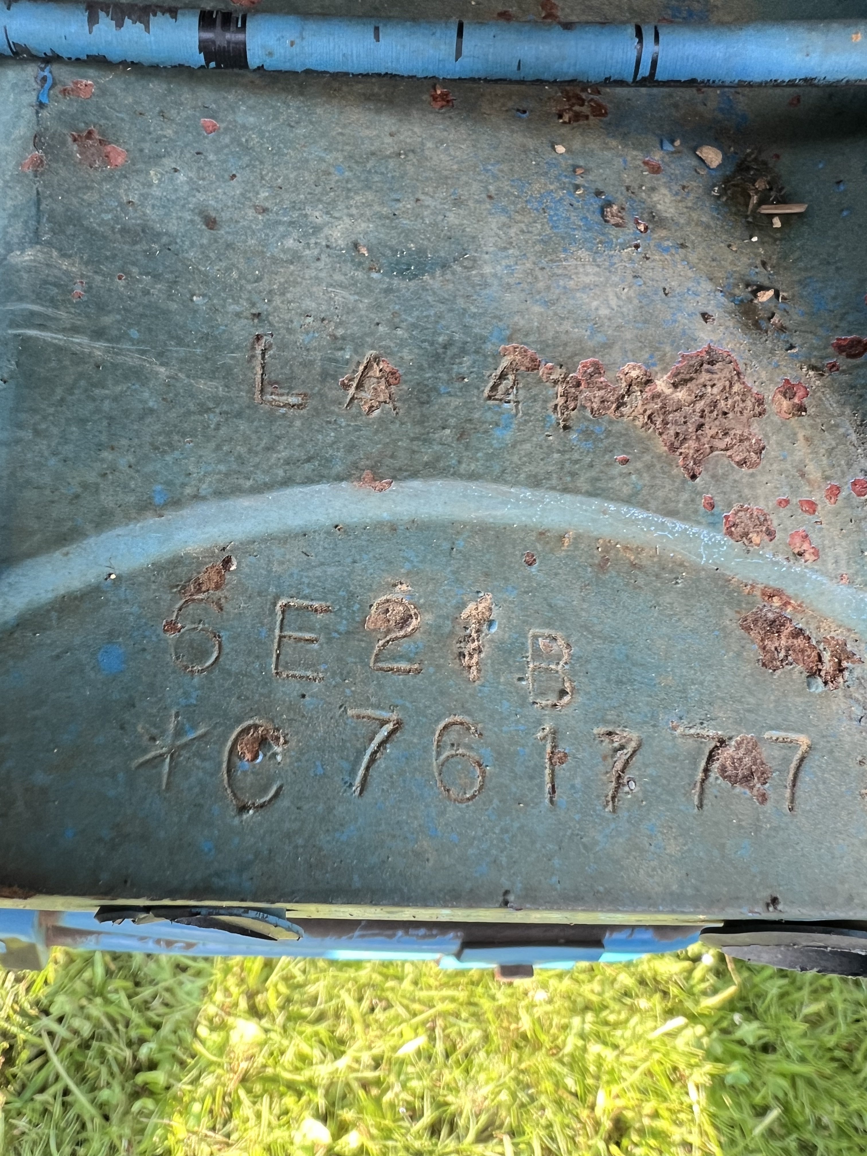

Here’s a picture of the serial # I have been trying to find out if there’s another high pressure outlet on that unit under the seat or around that area . I have had the loader on for many years but had it hooked into one set of the quick disconnect units in the back. I have the loader off now so I could put a new clutch unit in the tractor. Thought this would be a good time to free up the back spool

Series 1 5610 manufactured in Michigan, May 21, 1986. It has the CCLS or closed center load sensing system. A hydraulic outlet sandwich plate can be added to the unload valve in front of the seat, but, as mentioned in other posts, it will only make available one pump rather than both. There are some other ways to plumb to get both pumps as previously demonstrated in other posts.

/ Ford 5610 tractor , hydraulics #12
Probably the best one is this:
Prince valve info:
There is also a valve that Ford New Holland used/uses and someone said they get it from a company called Quicke
Here are instructions and layout for installing the Wavoil valve that New Holland uses. Unfortunately, the SML part numbers are no longer in existence from New Holland, but those fittings do exist elsewhere.
Also attached are instructions for adding additional remotes, but I know that won't help you other than it gives another plumbing diagram.
  • CCLS Plumbing Add on.pdf
/ Ford 5610 tractor , hydraulics #13
All the options that I previously posted are expensive. One option that might be less would be to buy a closed center loader valve for the loader, purchase a used double deluxe remote manifold and another deluxe remote set for the tractor. Install on the left or right existing remote stack. Plug your loader supply/return line into it and put the remote in an always on position.
