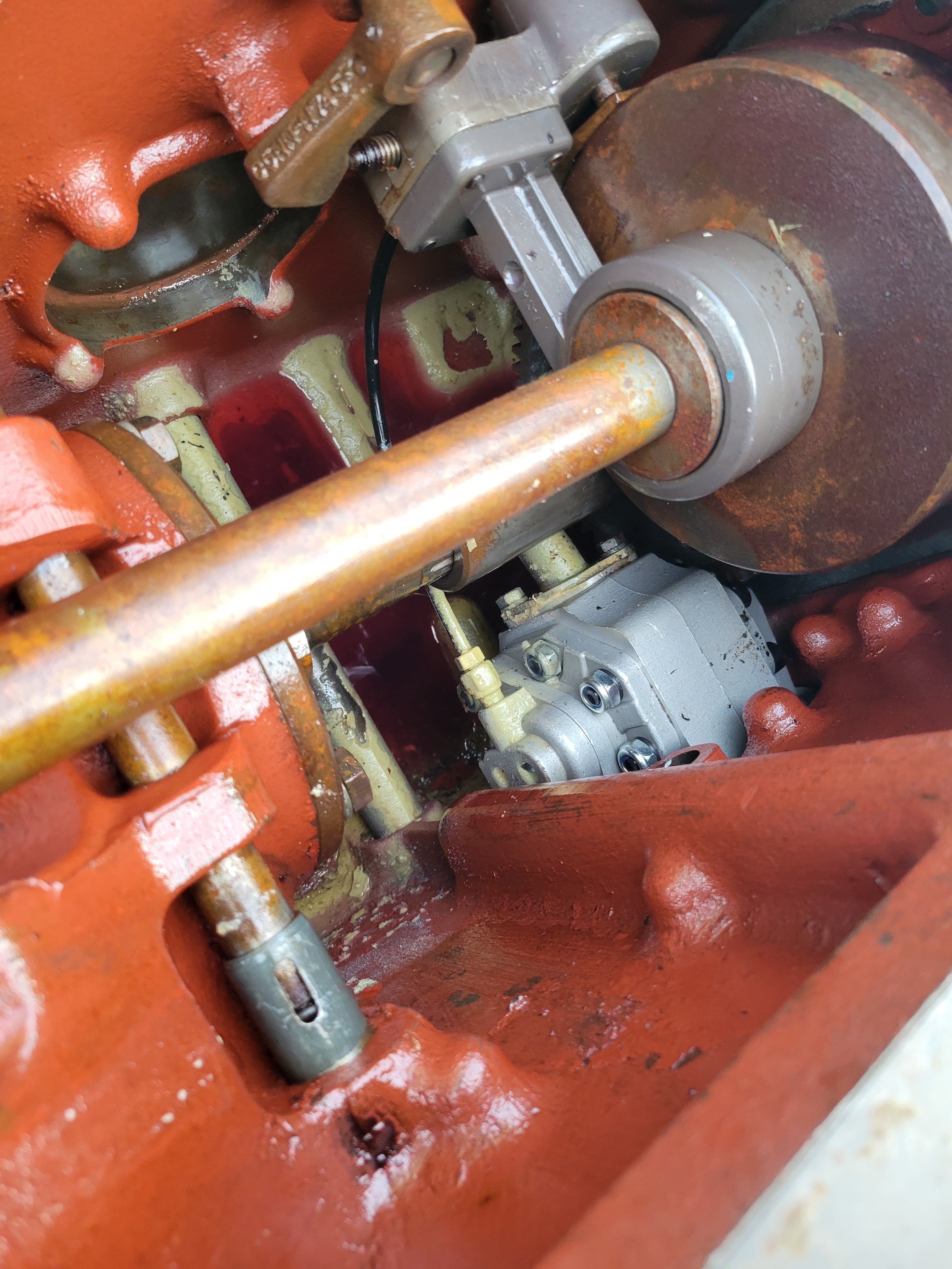

What is line going from pump to pto lever/detent?

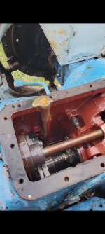

Pump works! Excuse the quality of rhe fluid I had some oil i thought was clean I had added after washing out the case with diesel. It had some junk in the bottom of the pail, it will be changed. Tried to upload video but it wouldn't attach.
