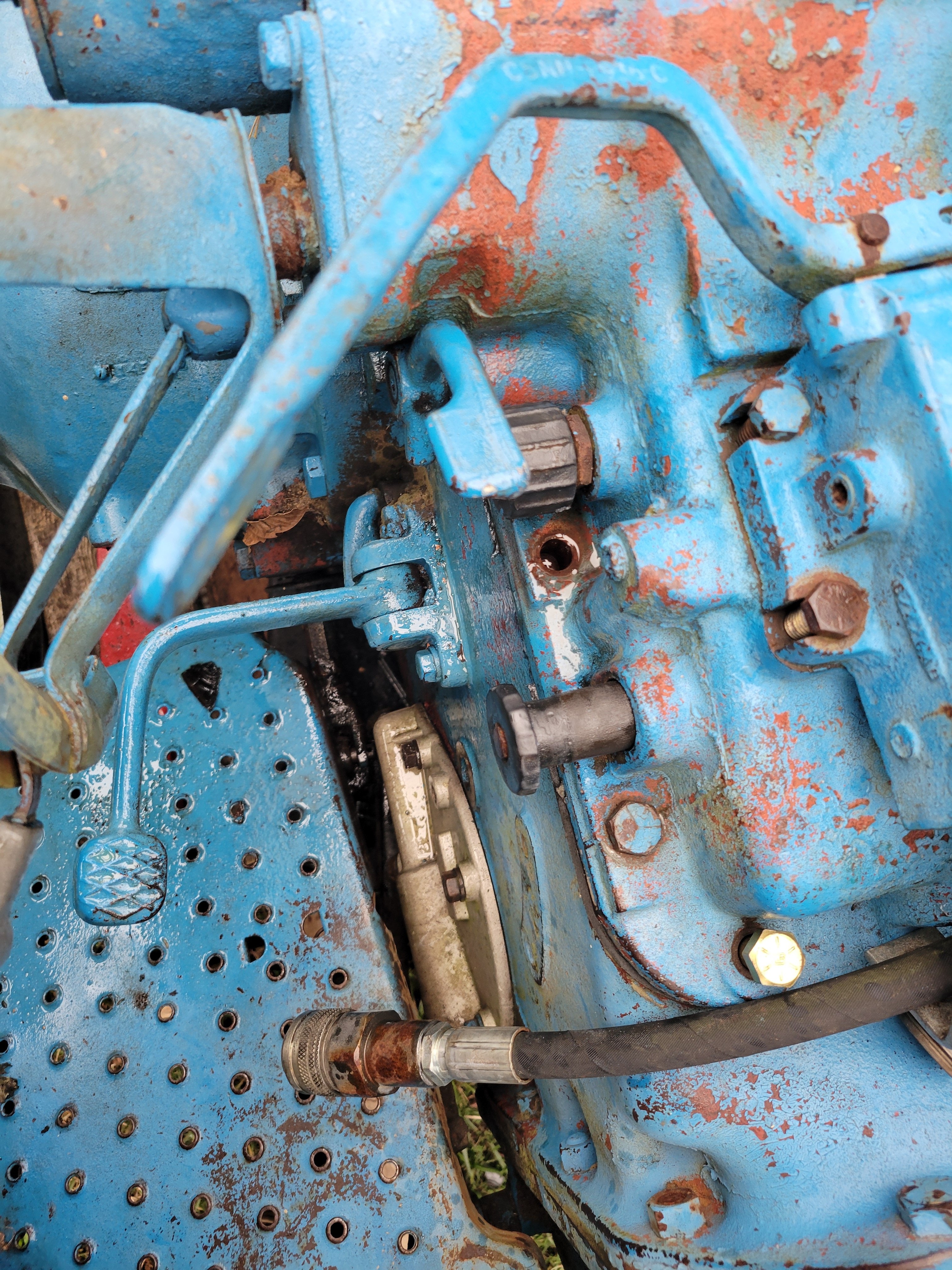

Its just the one pump thats gear driven off the trans. I'm not getting flow to the remotes or the lift. I had a few bolts out of the top and I could see through and the fluid churns when the tractor is running. I havent been running it for long intervals. I'm not really sure how to check the hydraulic pump without pulling the top cover off to see if its sending fluid through the "gallery" some of the top cover bolts have been out for some time and water ended up in the fluid so I went ahead and drained it. Figured I'd start back with some fresh fluid when I pull the top cover. I'm going to take some pictures and upload them when I do that. Any tips/pointers?

What is line going from pump to pto lever/detent?

Pump works! Excuse the quality of rhe fluid I had some oil i thought was clean I had added after washing out the case with diesel. It had some junk in the bottom of the pail, it will be changed. Tried to upload video but it wouldn't attach.

I think this is the one you were talking about? Mine either fell off when I pulled the lift cover today, or it was never there. I guess that could be a big problem!
