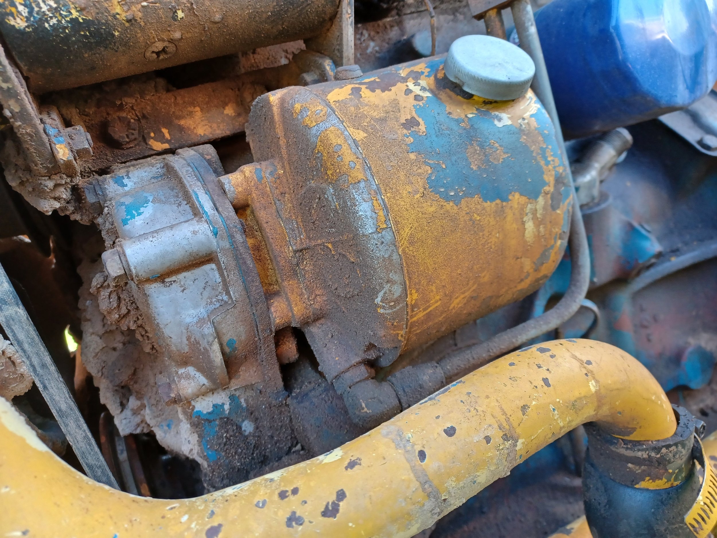

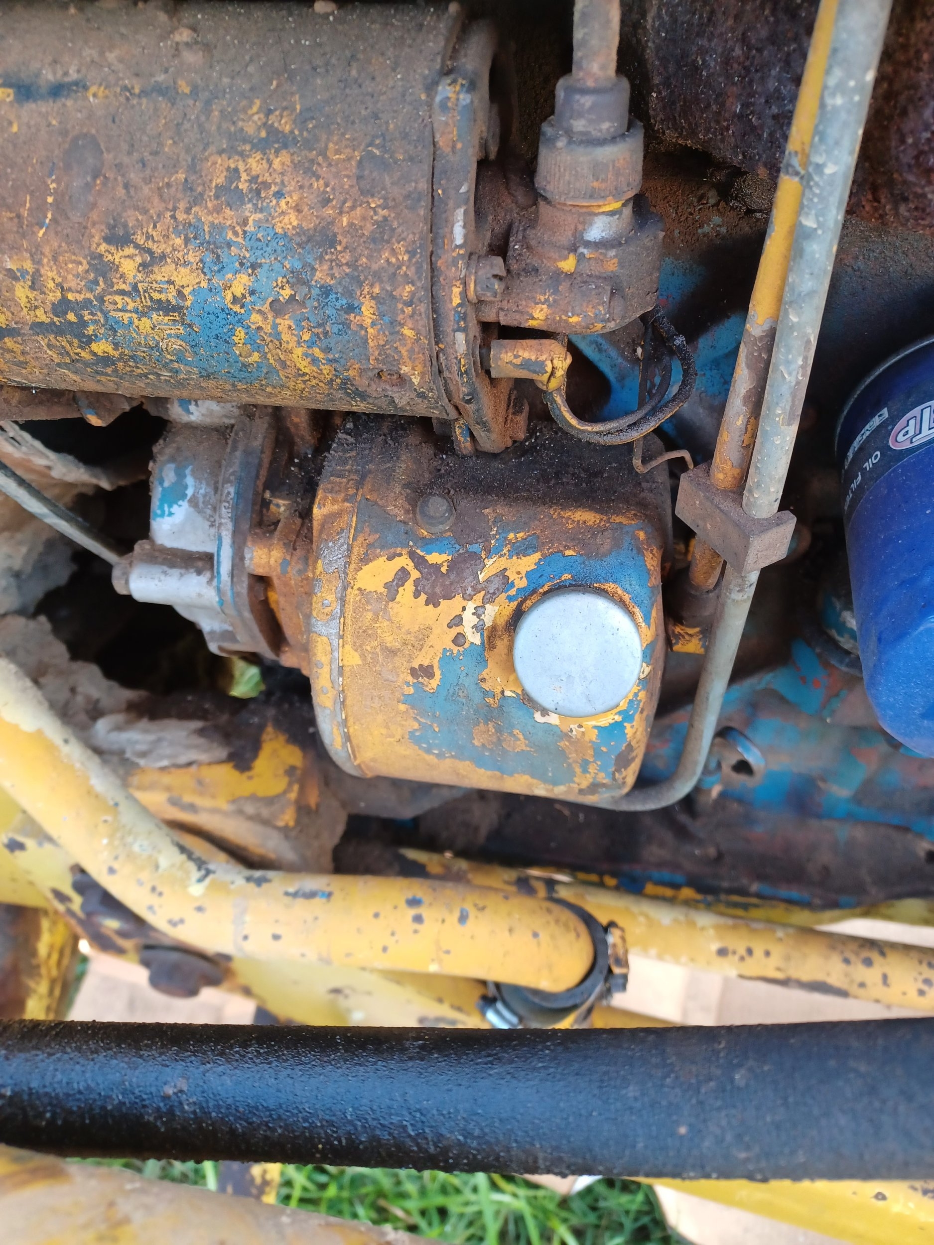

I've got a ford 4500 with a power steering pump that's disappearing all the fluid out after a few hours. If you are sitting innthe tractor it's the front left side, it has it'd own fill cap. This is a 3 cylinder diesel. The power steering works great until all the fluid is gone. I don't see where it's leaking and I've heard it can leak into the case. I'd like to go ahead and rebuild this pump. What's the process and will I need any special tools? I see the rebuilt kits for inexpensive online. Thanks in advance for any helpful info. Yall never disappoint!.

If you are not seeing oil on the outside of the tractor then the pump must be leaking from the front seal on the pump to the motor oil. Are you seeing a increase in lube oil level?

I thought my original post had the photo attached. I guess it did not!

No we aren't adding any oil in the case, it subtracts a little over time lol
I'll fill it back up see if I'm losing somewhere else. Down the line on a hose fitting or something, I probably should have started there.

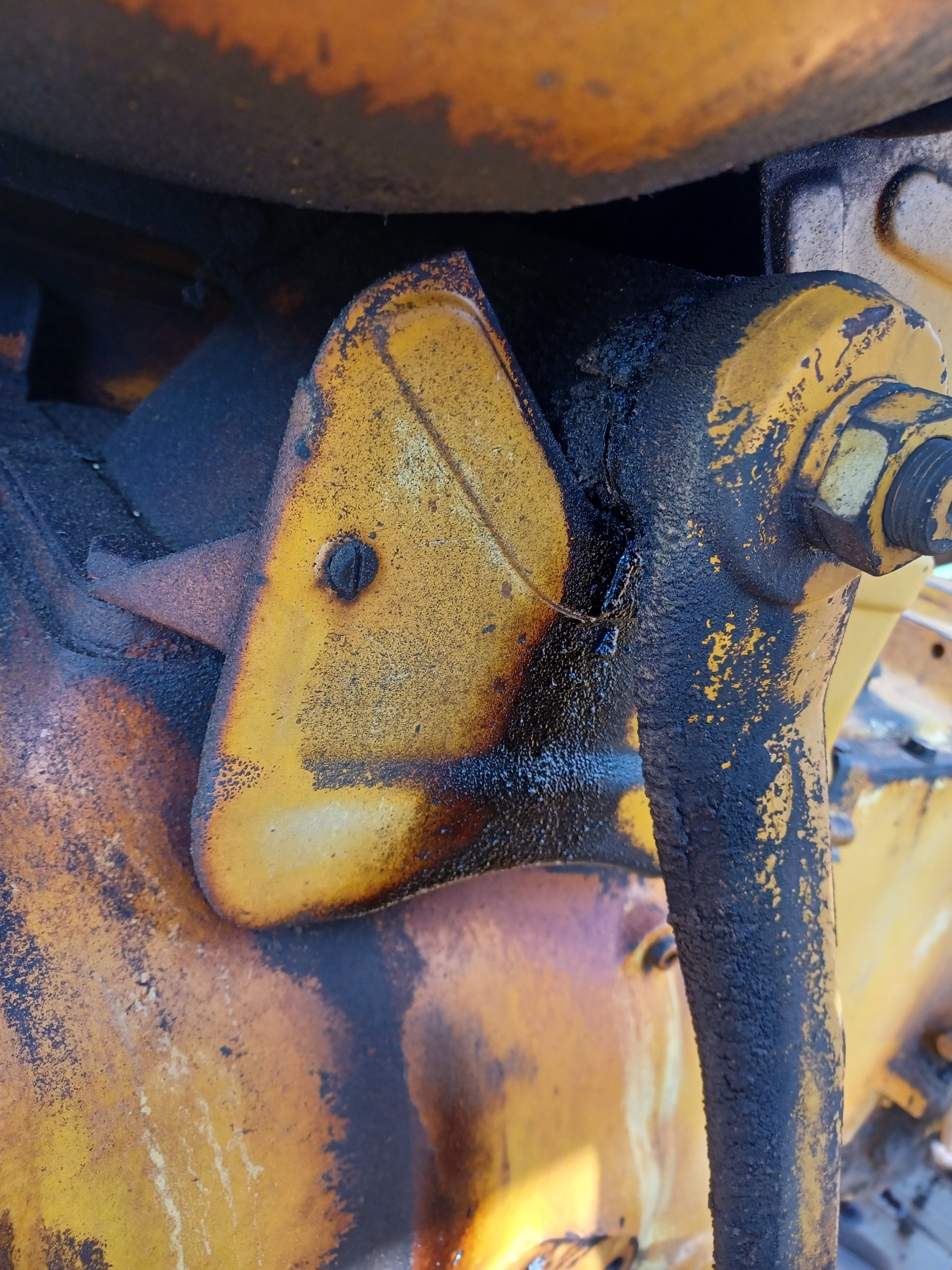

could it be from that arm? Looks like a leak to me.

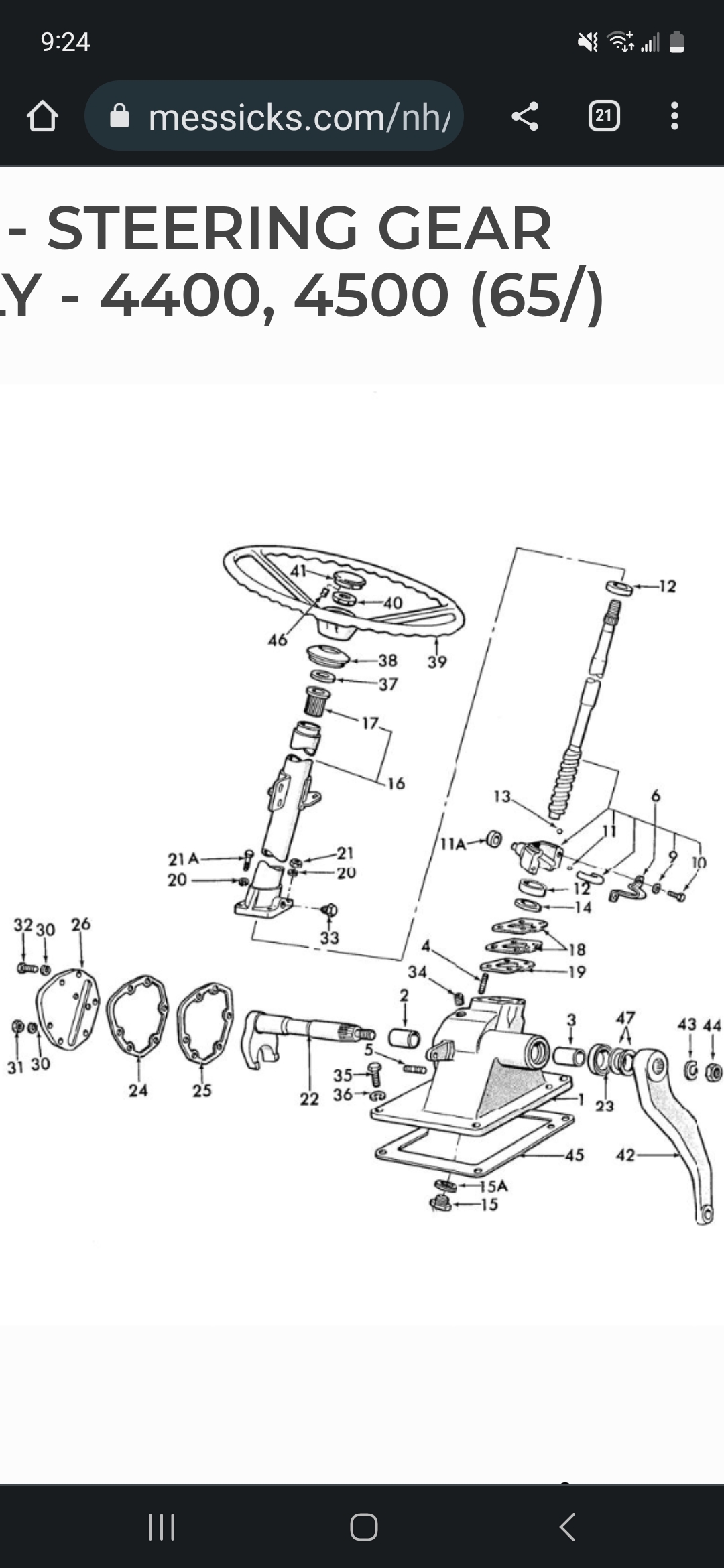

No. That is essentially a manual gearbox with gear oil (which you need to check that it has gear oil).
The PS pump pressure is piped to a power assist cylinder located in the front bolster. To access, you will need to remove the radiator grill and look down in front of the radiator in the dark, greasy abyss for leaks. Chances are the linkage is sloppy, but it definitely probably needs to be greased if the steering is working decent.

Is there a fill plug or anything for it?

Yes, but not always easy to get to or check the oil in it. See attached picture
80w90 or 140 works well in it
I keep a 5 gallon 80-90 for these type things! Perfect I've got a pail pump so hopefully I can get it right to that fill plug. Guess I'll ve replacing the seal at some point this winter.

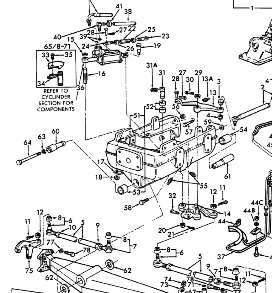

Here is what you are looking at in the front of the tractor for steering mechanism

View attachment 813035could it be from that arm? Looks like a leak to me.
Sure does! I had a leak under the steering wheel on our Ford 4610 and when i changed the pump filter it stopped. I figured the pump was being restricted by the dirty filter and it was over pressuring the system. I replaced the filter and never had another issue.

@Jerry/MT not the same on a 4610 as a 4500.
The 4610 used a steering gearbox that had a power assist piston within the gearbox. The power steering is delivered out of the steering box up the draglink to the wheels. The steering high pressure goes into the column and can leak out the pitman shaft.
The 4500 used a manual gearbox, no hydraulic pressure there. The steering pressure line goes into the steering piston in the nose/bolster. A valve mounted on top of the cylinder activates when it senses input from the drag link to offer power steering assistance to the manual input by the driver.

I know this has been 2 years ago but I'm finally circling back to this. I have just been keeping it topped off because I use this machine so infrequently. I've got new leaks and one is likely from the front hydr. pump. Also located in the Ford hydraulic leak abyss. I'm going to see if I can find a seal kit for the pump just to have on hand but I like the culprit is likely down the line.

I know it is a mess in the front bolster, but are you sure it isn't the steering cylinder, valve or line?
