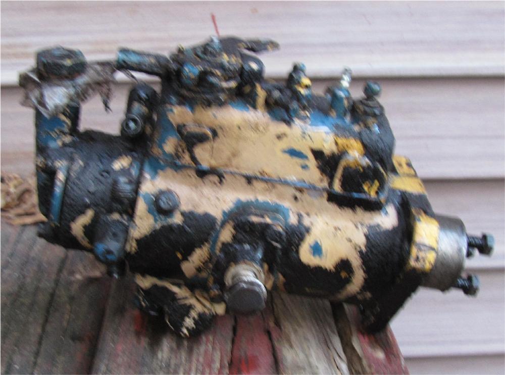

So here's my pump.
Is trhis the right kit for it?
7135-11 Ford Massey Ferguson CAV DPA Injector Pump Repair For 3 4 76 + | eBay
There's another one thats 4 times as much but this one looks like it will fit while the other one doesn't
/ Ford 4500 injector pump not pumping #9
The -11 doesnt have the gaskets & orings for the advance OR the front seal.. u want the -110.
