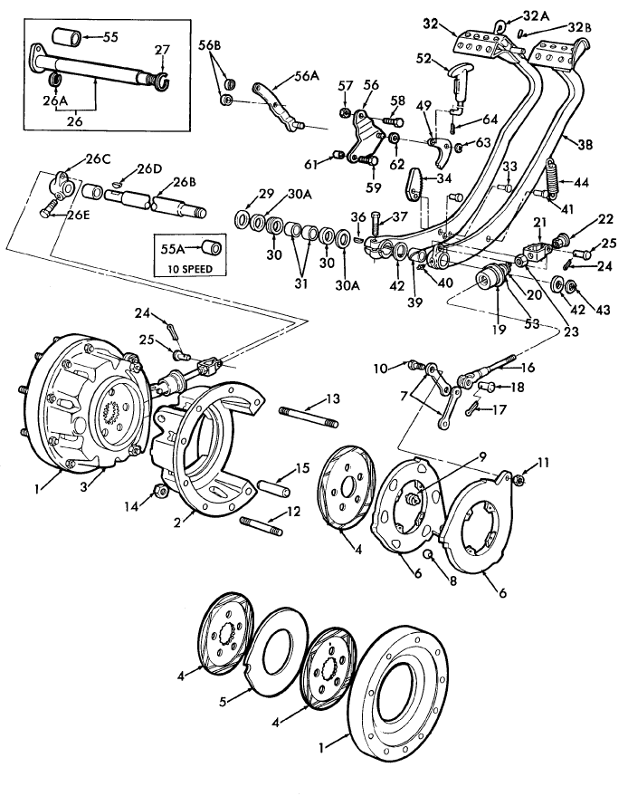

I have a ford 4500 work horse tough old tractor and I'm not a ford man. I've got four more that I would like to bury maybe make one a head stone. My question is on the 4500 ford Loader/backhoe what's exactly involved on changing the rear brake pads/disk/ not shour I've heard that they aren't wet and then i've heard they are. my 4500 brakes they are raising cain did I say they were rasing cain. I use this tractor religiosly it's the only woking thing around here other than me. I really don't won't to do any damage that I can prevent but staying of it about impossible. I am a mechanic by trade when I pull the wheels what do I need to expect. New one on me. thanks for any info
/ ford 4500 brakes????? #2
Here is an exploded view of your 4500's brake system.
You can find the same picture at New Holland. New Holland
Put your cursor on New Holland Construction at the left, then slide down to "english" in the column at far left bottom, and click on it. This will take you to NH North America.
On the next page that appears, there will be a white box at the top left to enter your model number. Select search, and a list of sections of your tractor will appear.
Select which one you want, and click. An exploded view of it will appear. Below is the part descriptions, with part numbers.
Hope this helps..!!

I worked at a Ford dealer for over 15 years and yes they are wet brakes. They were also prone to making some really bad groans and noises if the hydraulic oil was not one they liked. At one time Ford sold a two quart bottle of what they called then "Anti-chatter Additive" to stop this. This only applies if you're still stopping good, just with noise. I don't know if they still sell it, but it's worth a try.

I'd be lookiing at the adjusters on the brake linkage. If the adjustment isn't all used up, I think I'd try some anti-chatter additive or draining the oil and using a decent quality UTF meeting MC134D specification. For all you know, whatever passes for oil in that sump may be 100% of the problem.
I won't say that nobody ever replaced the brakes on a 4000/4500, but I'll wager there are a lot more of them stopping with original brake parts than not.

I've checked the adjusters not much left there to adjust. I went to napa yesterday got the right fluid. I believe before I put it in I'll go ahead and replace the brake disks. I just dread pulling the rear tires by myself but I have 2 fairly new one's I need to put on it anyway just been puting it off but now I have good reason. Appreciate the info
