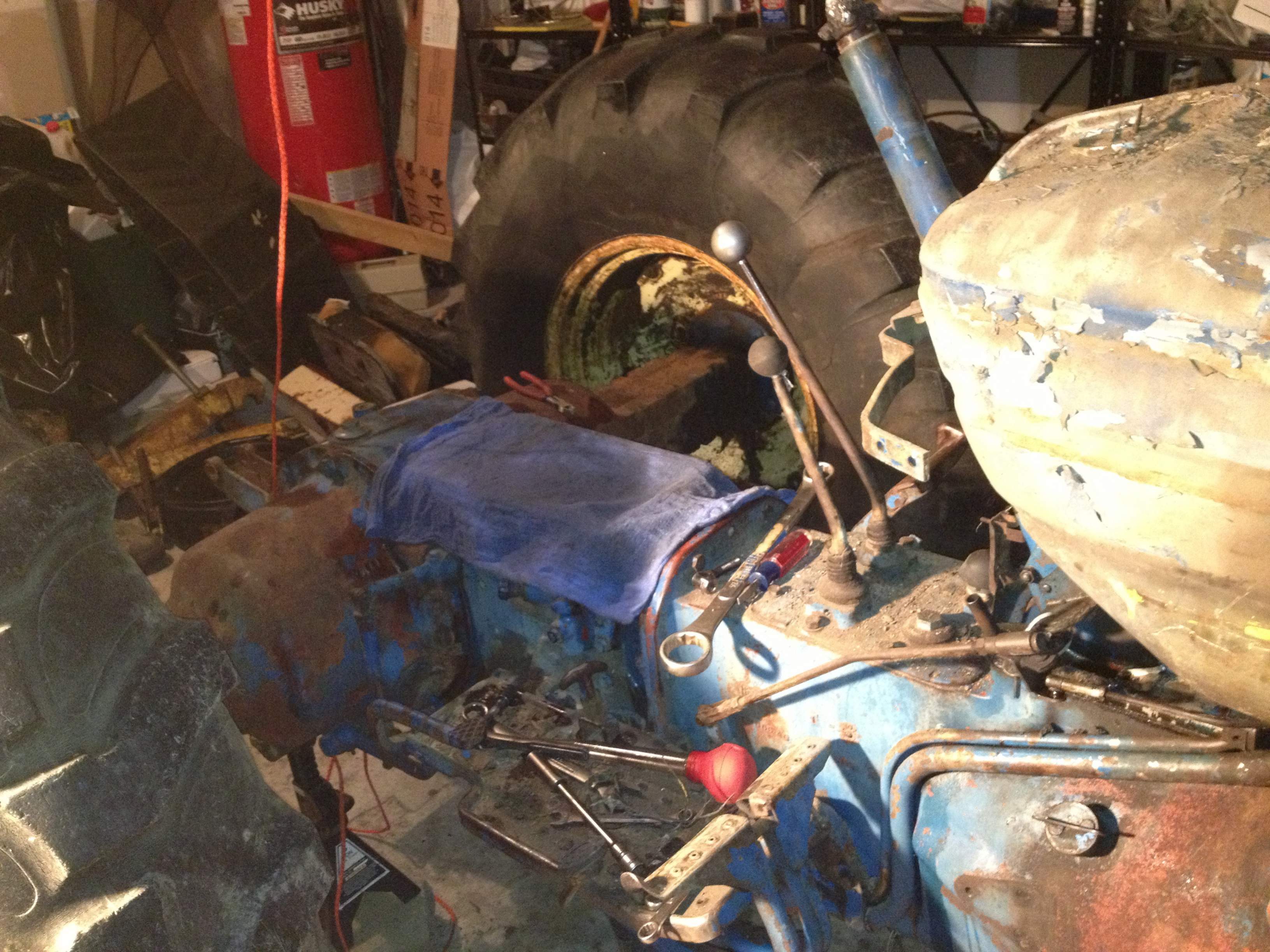

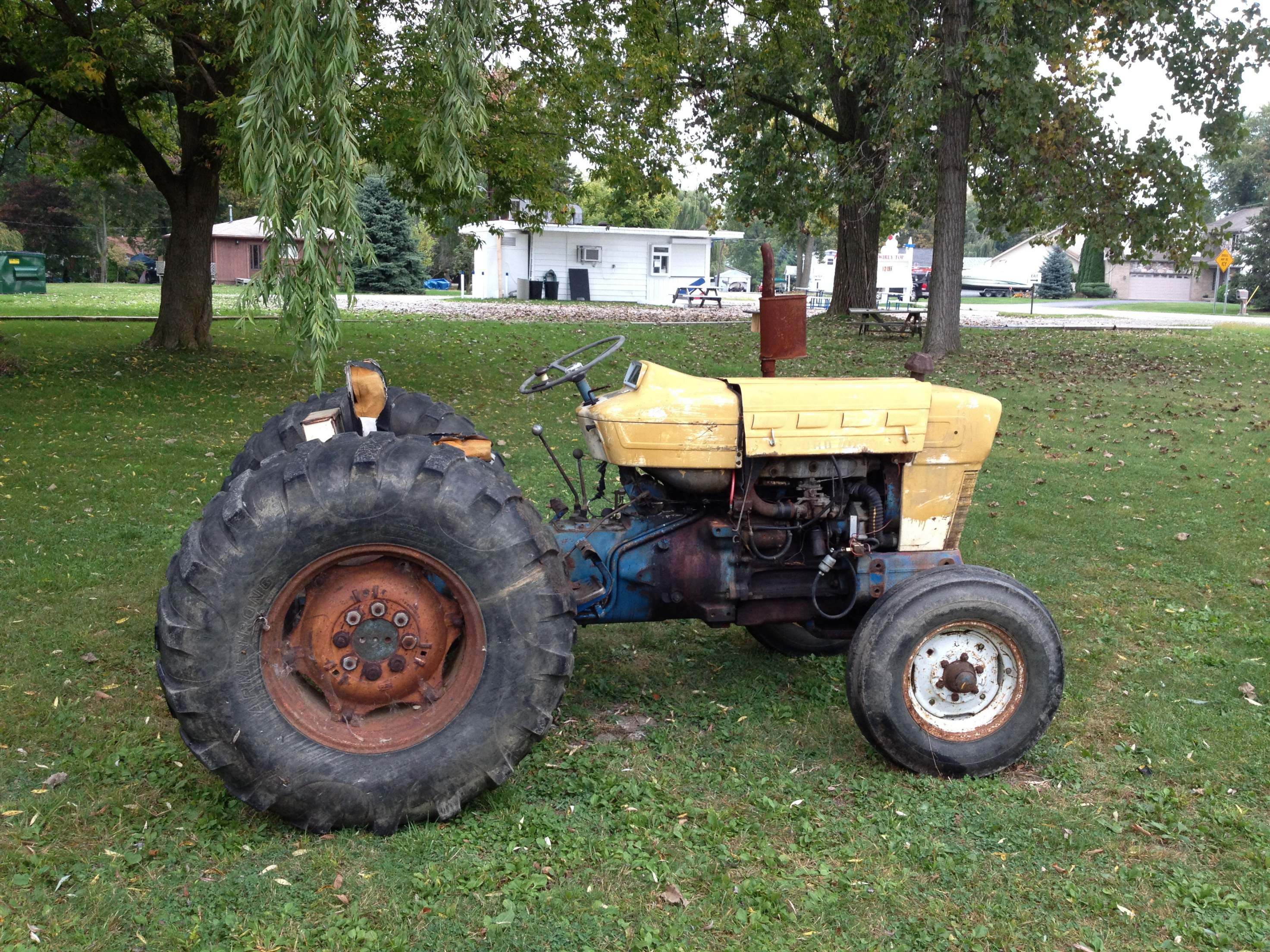

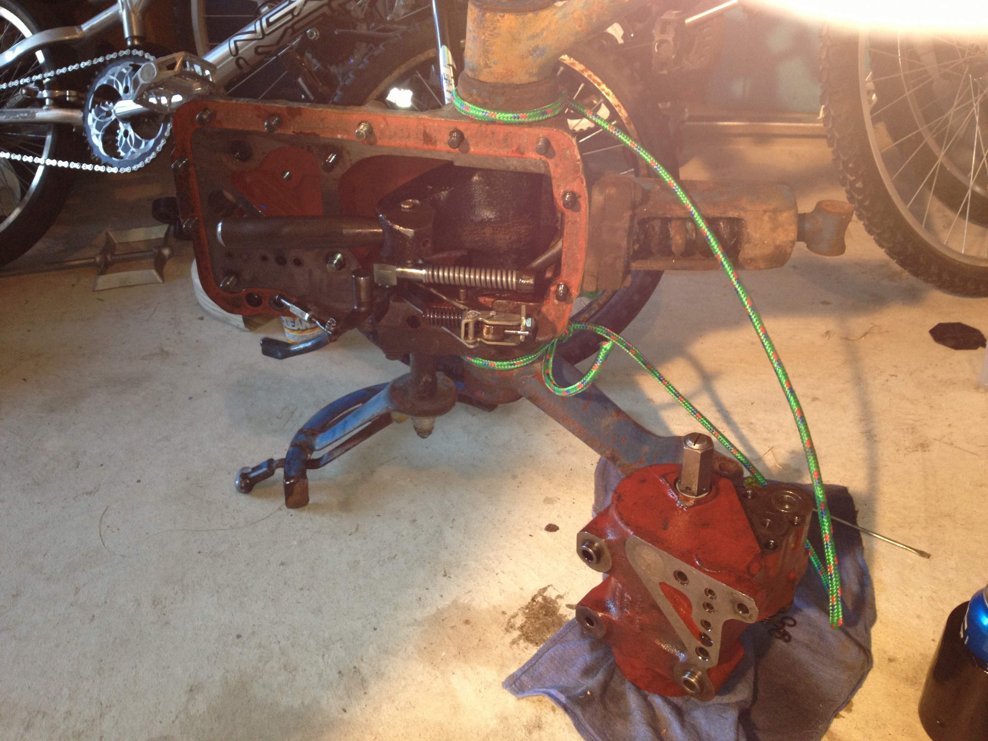

I've had this tractor for almost 2yrs and now I finally have the time to start getting it in working order. I bought it for the loader and some other parts, then I was gonna scrap it. It runs so good I decided to keep it and fix it. She's far from pretty and needs a LOT. To start: 3PH doesn't work, left wheel seal is bad, steering is completely shot , the electrical needs to be gone through and to many oil leaks to count. To give you an idea of how bad it is, when we were putting it in the garage, it caught on fire(little fire). I have the service manual but I'm sure I'll be picking everyone's brain trying to fix'er up. I have no plans on doing a complete restoration, just make it mechanically reliable/good.
Here's a few shots of the beast.

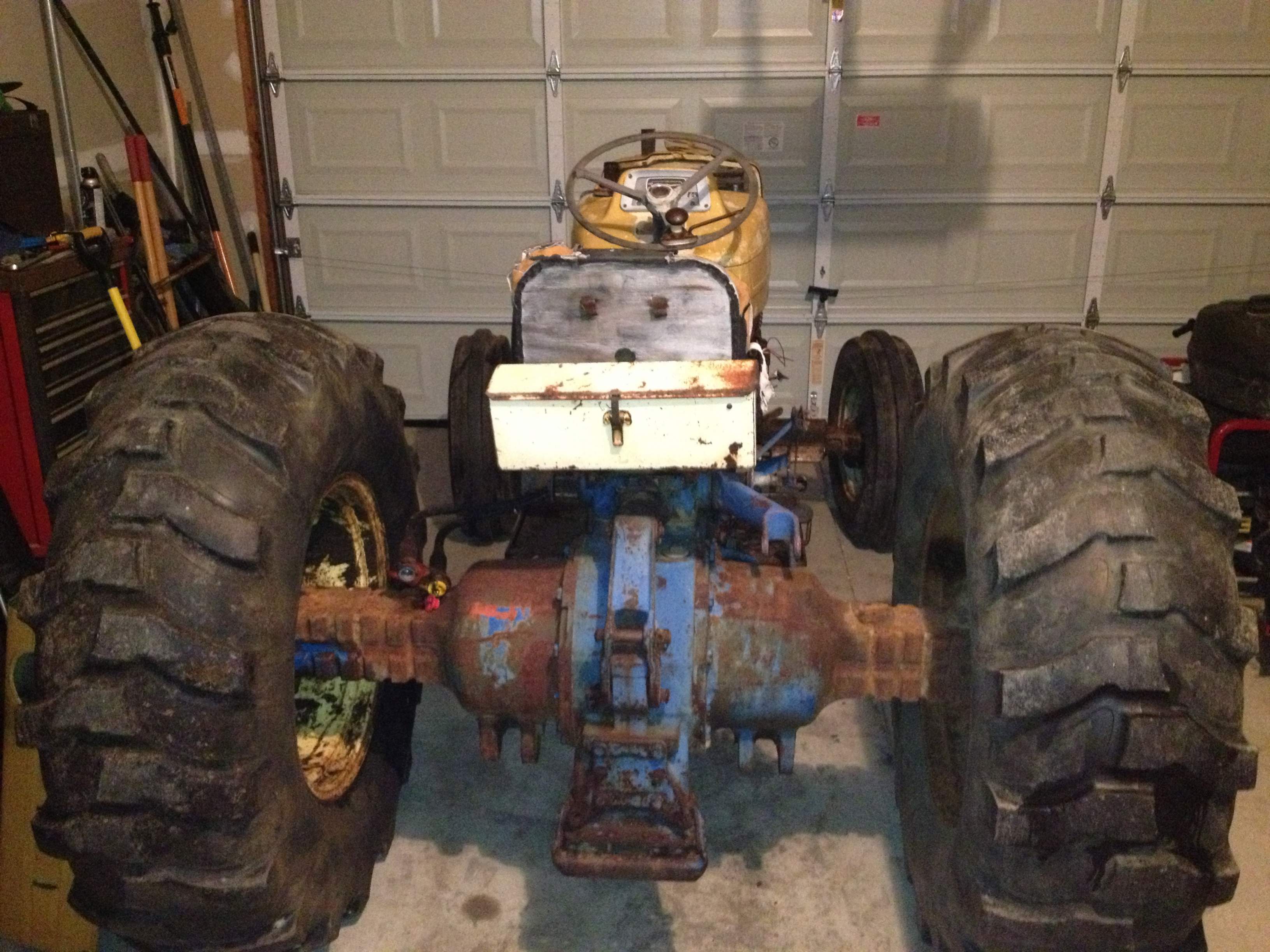

I guess I didn't realize the the trumpets on the rear of those tractors where so big.
I'd fix it up. Looks like it has a lot of potential.
/ Ford 4400 restore
Those trumpets are 2x bigger than my 3000. I made some headway today.

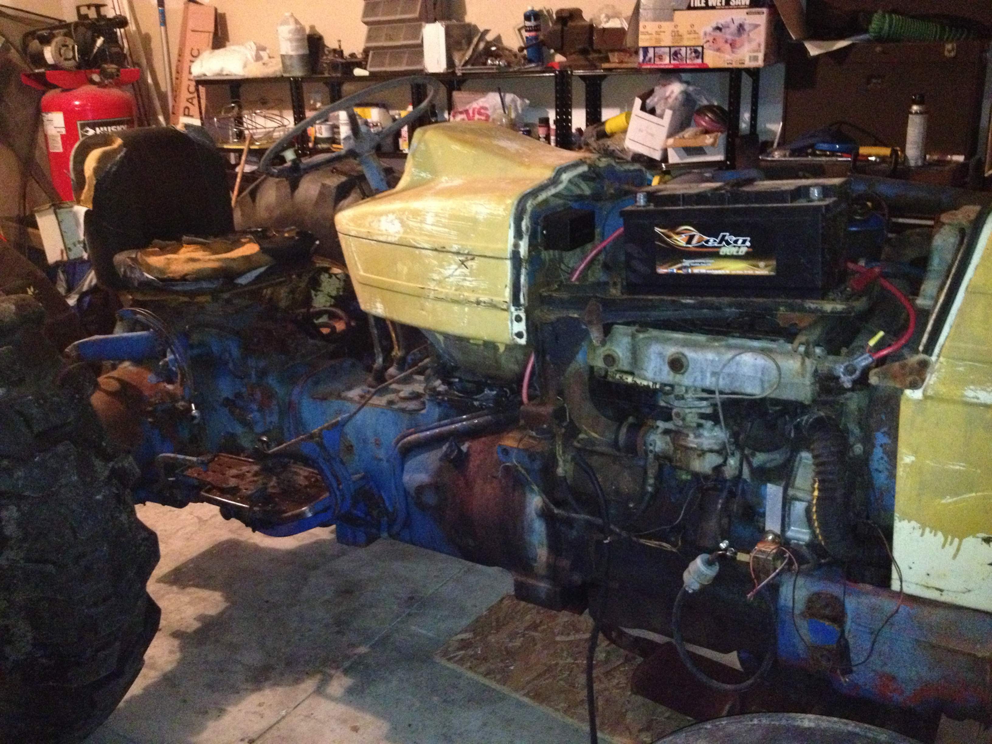

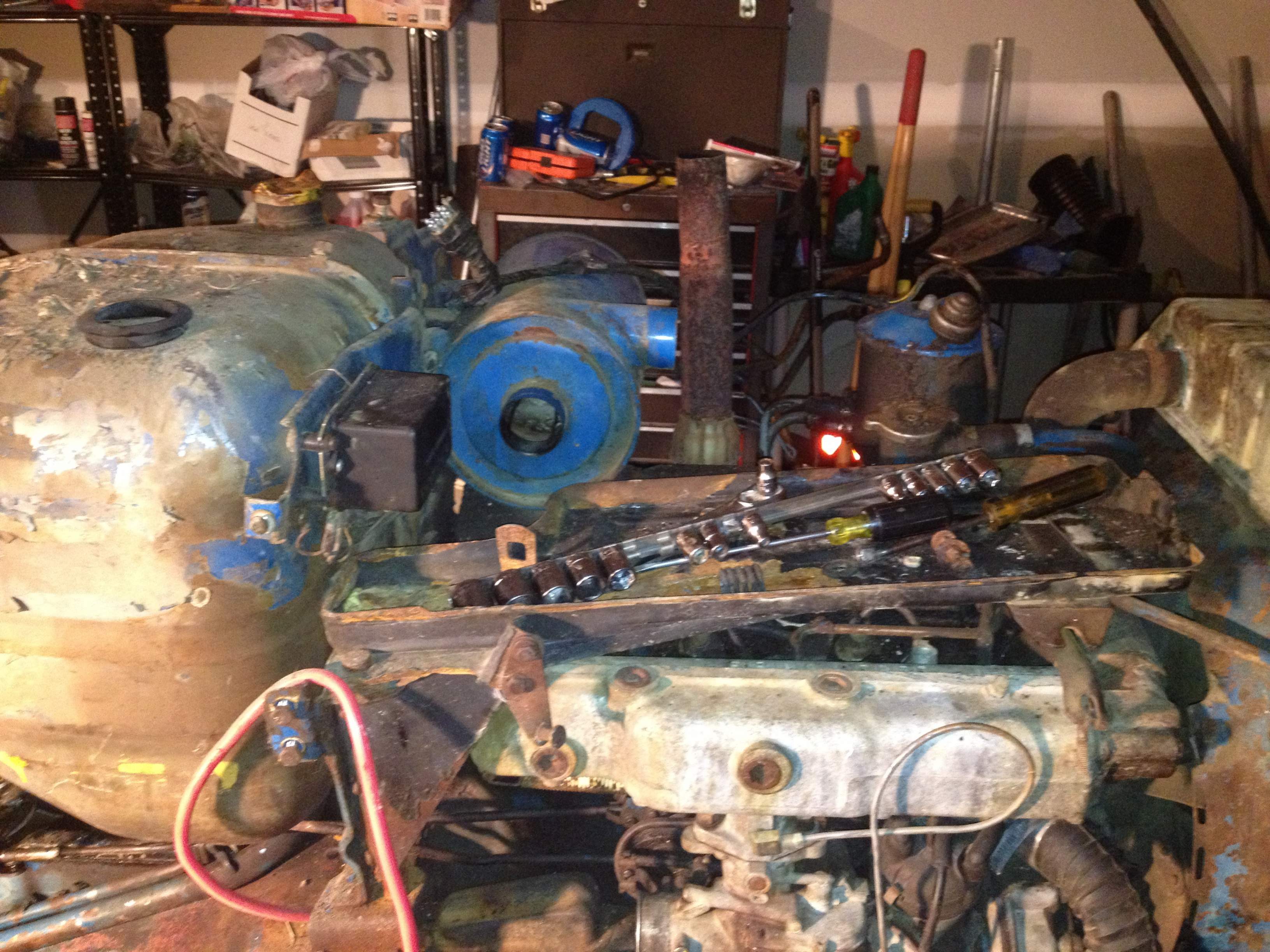

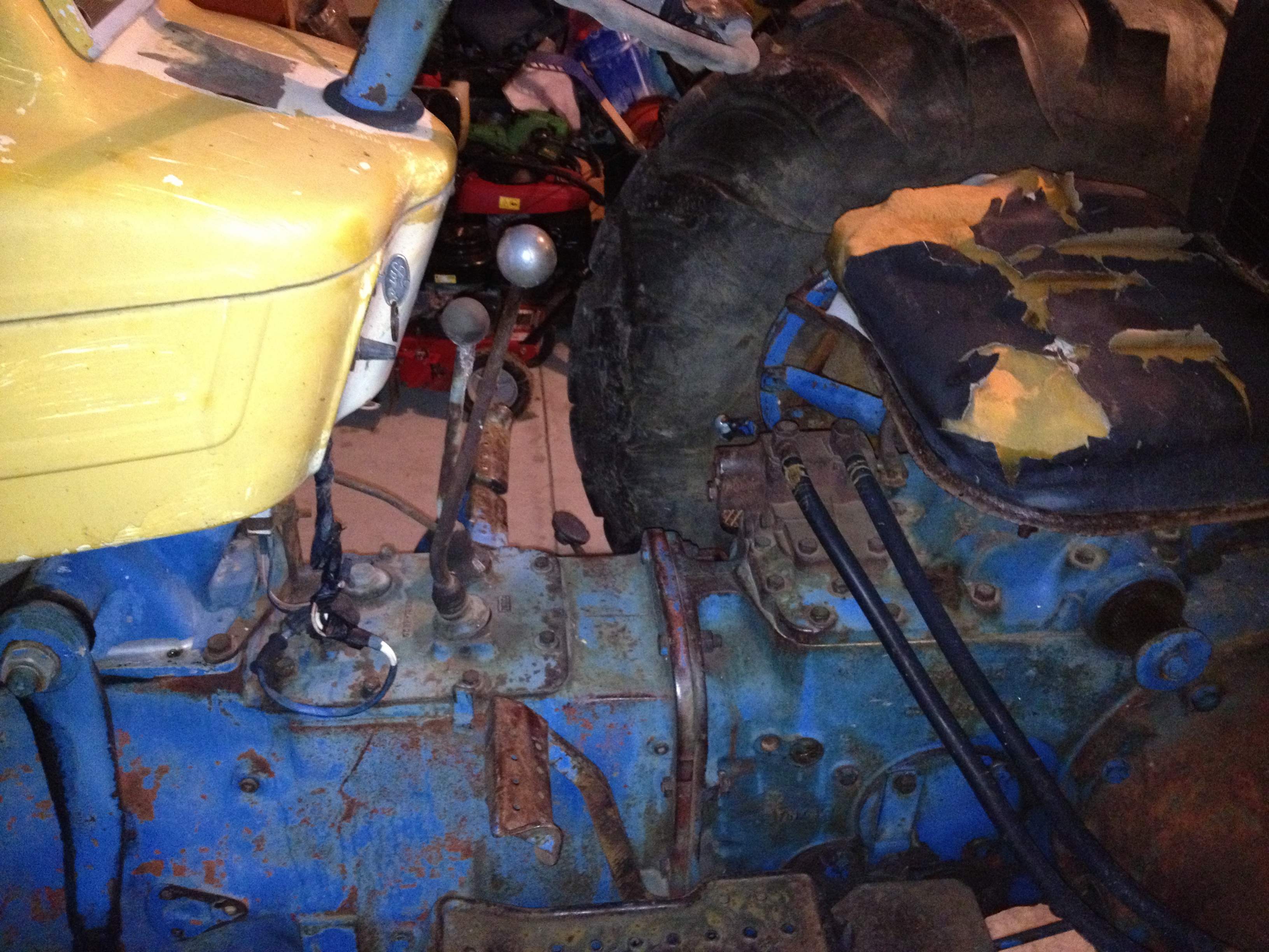

I decided to work from the axle forward. I rebuilt the top cover today, the piston sleeve looked brand new but the o-rings were shot. The hydraulic intake was completely clogged, hydro-exhaust filter was clogged and the bracket was broken, can't get the steering wheel nut off (any ideas). My buddy and bro stopped by and took off some sheet metal off. Its going a lot slower than I want because I about cut my thumb off 2 weeks ago but I'll keep at it.

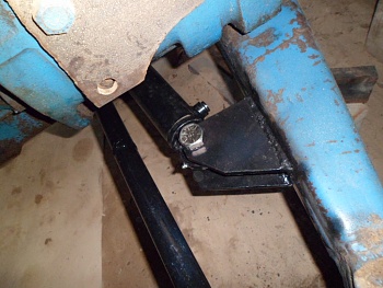

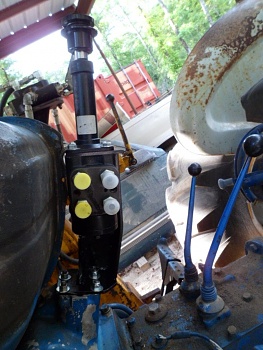

Those are good old tractors for sure, I love my 1968 4500. My whole steering system was shot so I converted it to full hydraulic and gutted the steering gearbox and linkage.
Awesome, That looks great! Do you have a build/repair thread? If not, could you tell us where you got the parts? If your able, A few more pictures would be greatly appreciate too. The front end on mine is completely shot too. I'm thinking I'll spend more money and time trying to fix whats there instead of just ripping/replacing it. Were you able to use the power steering pump for pressure or did you tap in to the tractor hydraulics?

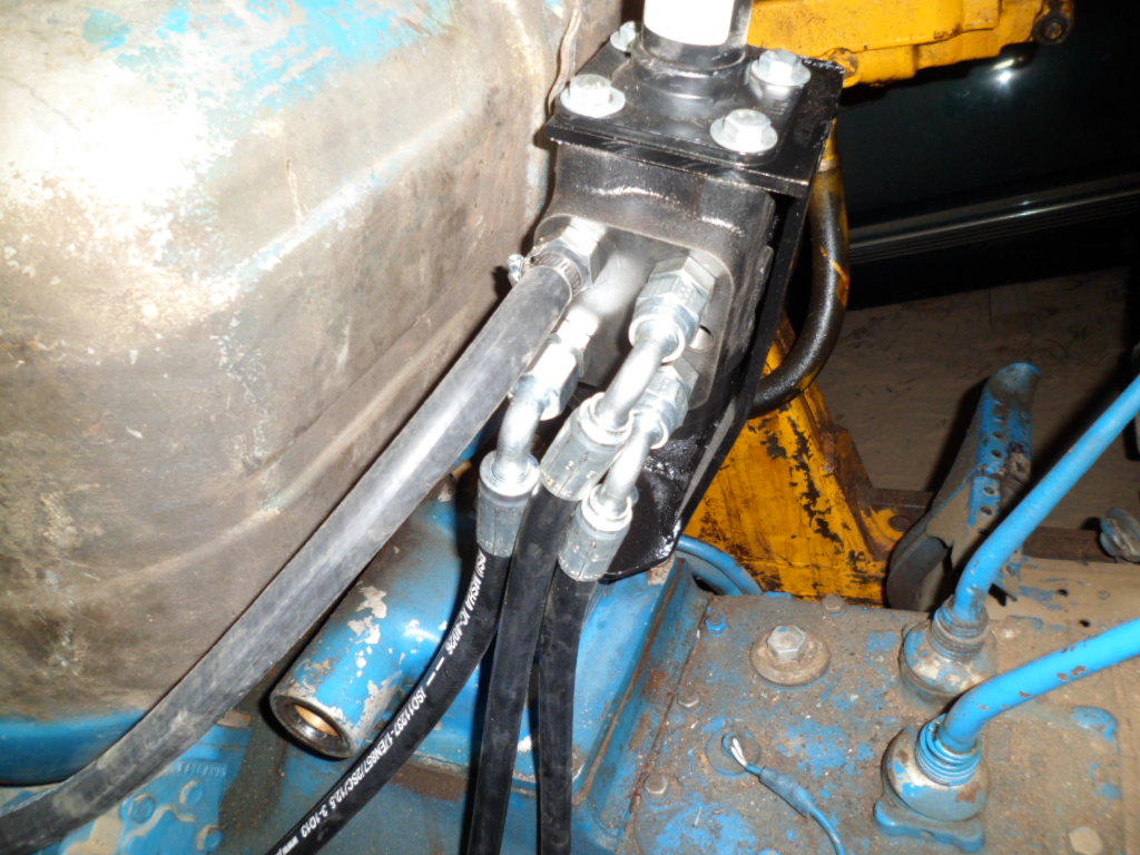

Hey Davo727, that is a very interesting conversion. Wouldn't mind doing that myself. I have a question though, "How much did that cost?" If your tractor is a gas would you mind sending a pic of the system from the tank to the carb? Thanks.

Here is the steering conversion http://www.mytractorforum.com/showthread.php?t=211740 The parts that I used are listed in the 4th message , not the ones in the first message. Prices: steering valve $343, column $94, actuator cylinder $160. Had all the hydraulic hoses made up at Hufco in Conroe Tx, they are the Parker Hydraulic store here.
I used the power steering pump on the engine and it works fantastic.

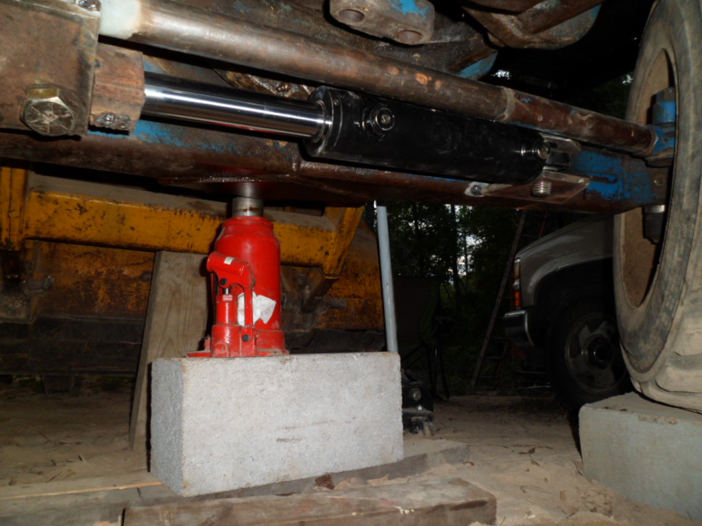

Couple more pics

Thank you Davo! I'll be doing the same thing. I really appreciate all of your and everyone else's input. From what I gather you recommend using a 7" cylinder instead of the 8", right? Were you able to fit the cowl back on without to much trouble?
/ Ford 4400 restore #20
Yes on this industrial front axle 7 inches travel is what it needs, you want to get close to the stops but not hit the stops with cylinder travel left or you will break the stop or break the spindle. I would recommend asking Bailey Hydraulic online if they will make you up a 7 inch travel cylinder using the one I used as the starting point.
The cowl fit fine, I did have to fold over the rear seam on the gas tank though. If you use a little longer steering column then you could make your steering valve mount shorter so the valve is lower and it would give you a little more room than mine.
