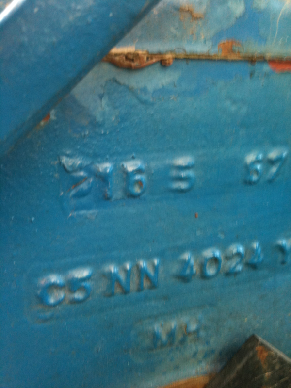

Maybe you can tell me what these numbers mean.

u have to get the numbers off the to of the bell housing behind where the starter bolts on but the part number is all the part numbers is for the same seal
86576339,
C5NN2N336A,
E7NN2N336AA,
85999093

Finally got around to getting the numbers.
They are;
M4000
7J01B
A157312
Maybe you can tell mr what they mean.
Thanks

whodat526 said:
built in atwerp belguim
1967 model
and it is a 4000 ford
Man, you're on the ball, I appreciate all the usefull info.
