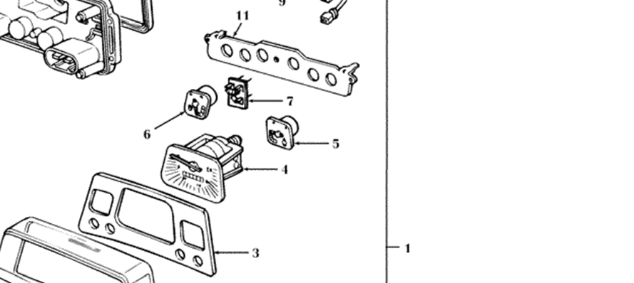

Can you swap out the fuel guage on a Ford 3930 without having to change out the entire instrument cluster? I'm finding plenty of clusters for sale on one but no single fuel guages. I checked the sending unit and at the current fuel level (about half a tank) I read 225 ohms resistance across the terminals on the unit. I checked the wire at the guage and got the same reading. The red wire at the guage is hot and the ground wire checks ok. I am assuming the guage itself is bad. Not having a manual I've no idea what the resistance should be but 225 ohms seems rational. Any experience with this or technical info would be appreciated.

know nothing about your particular tractor , But in looking at parts for it on Messicks , Your in a better situation than Me on My TC 30 !!
When my guage went out . it was right at $100 for new guage . Now they are $180+ .
Yours shows the following :
Assy., Fuel, L/Auxiliary Fuel Tank, Start Year: 01-MAR-90 E5NN9207AA $114.46
Assy., Fuel, W/Auxiliary Fuel Tank, Start Year: 01-MAR-90 E5NN9207BA $123.58
In drawing , First one listed is on the right side of panel .
In looking at drawing , it just appears that you would have to disassemble cluster , I assume , to the degree that You could remove , replace gauge .
Since gauge is listed seperate , Then I assume that " Yes " it is replaceable .
