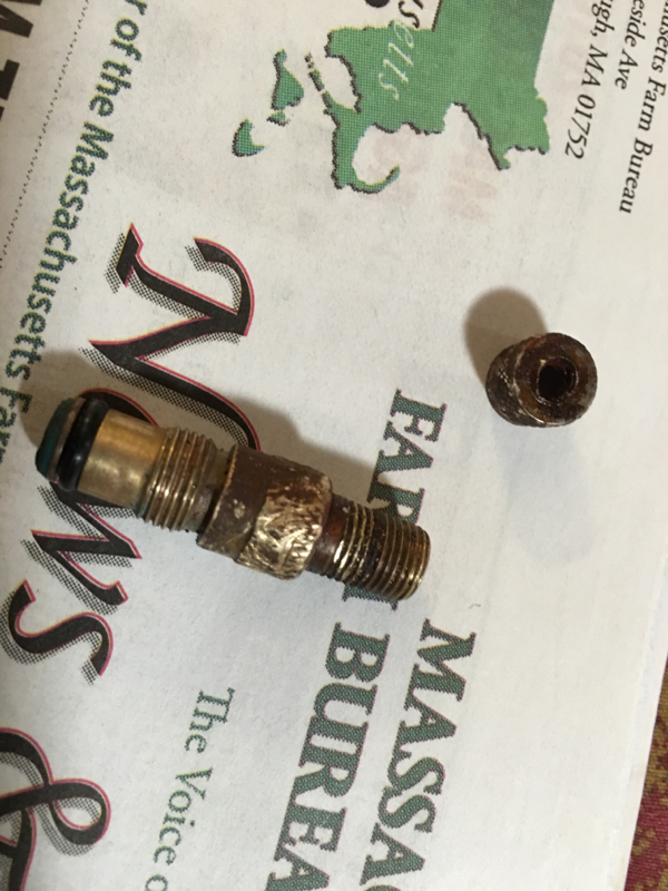

Good eye, I checked it out tonight, valve stem had a slow and I'm guessing intermittent leak that had probably gone on for a while. The tool end of the cap had rotted off and the calcium chloride must have occasionally leaked out through the hole, it was dry on inspection. I pulled the removable core, wire brushed everything and replaced the core assembly. Rim had rust scale on the outside around the stem, but seems solid after I got the scale off. Glad you noticed it!! That's the beauty of this forum and sharing!!
View attachment 462948 The culprit
Having bought several older tractors I am quite attuned to the CaCl problem.
It would be a good idea if you make a plan to have your rear tires removed from the rims for inspection.
Your rims have likely had at least 26 years for that CaCl to do it's destructive work on them.
I think you will find that the rust is quite severe all around the outer edge of that particular rim.
My suggestion would be to sand blast the inside of both rims, and then apply two coats of two part epoxy paint.
If you don't like that idea, just save up some money, because in 3-5 more years you will likely be buying new rims.
Whatever you do, I would get that **** CaCl out of there.
I would also suggest replacing the tubes (about $45 each).
I have found windshield washer fluid to be the most economical freeze proof tire ballast.
Last fall I picked up 80 gallons of windshield washer fluid at the Home Depot in Hyannis.
$1.50 /gal. including tax. That was a good deal for the Cape (Probably the same in Wareham, or Plymouth).
"Rimguard" is the best, and you can get that in Carver, but it is VERY expensive, and they will charge you PLENTY to put it in ($430 total for 2 - 13.6 x 24 tires)
You can put windshield washer fluid in yourself, with a $10 fill attachment from TSC.

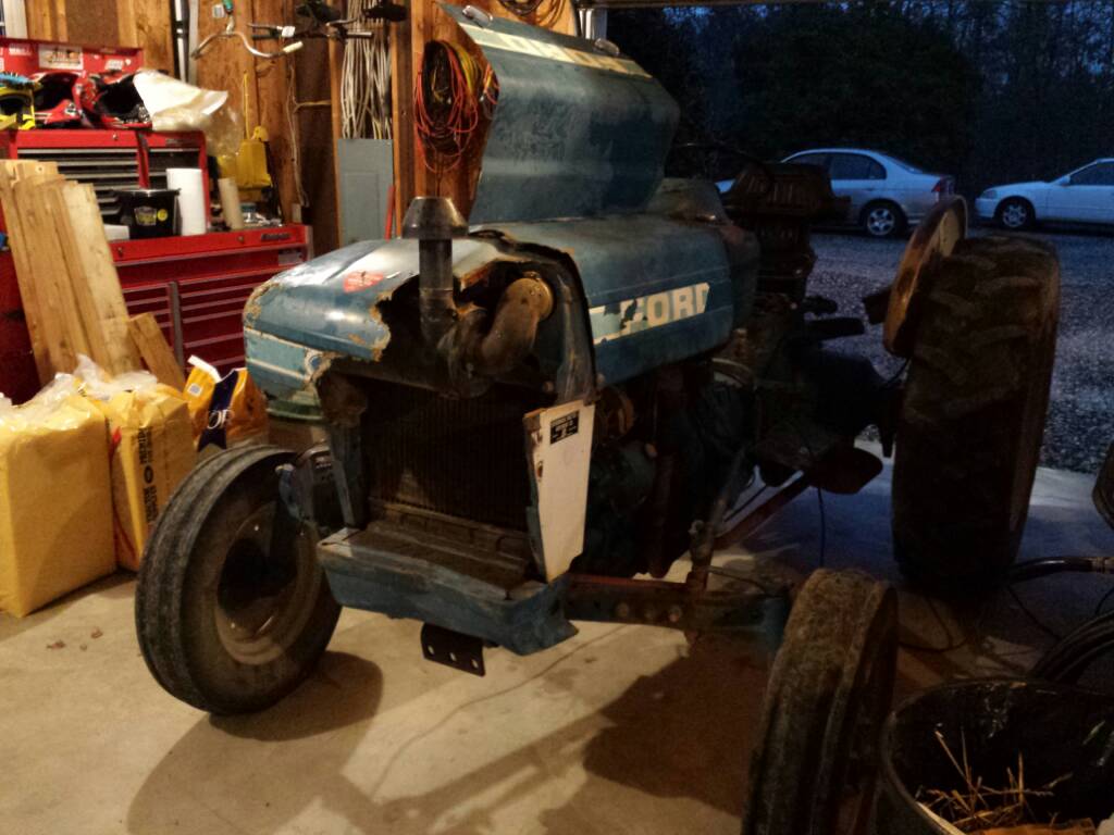

Man is this thing nasty. Any advice on how to best clean this up would be much appreciated! Not sure if this is from the draft tube or just a leaky valve cover gasket. Also, are the exhaust manifolds reversible? I'm thinking about going to a hood exit exhaust as I like the sound better. I also think the exhaust is too restrictive with the current setup.

I used Simple Green and a water hose to clean the valley of my 7.3, but would like to know what everyone else on here prefers

My 4610 has the exhaust out the back, as does my 5610. The other tractors are all through the hood. One benefit for me with the horizontal exhaust is I don't have to worry about bending exhaust pipes mowing along the walls.

My 3910 came with factory vertical exhaust. I changed it to horizontal. No, the manifold isn't reversible. I bought a new manifold, then built the pipe and used the original vertical muffler. I'm in the timber a lot and couldn't deal with tree limbs catching on the vertical pipe.
Hot pressure washer !!!!
