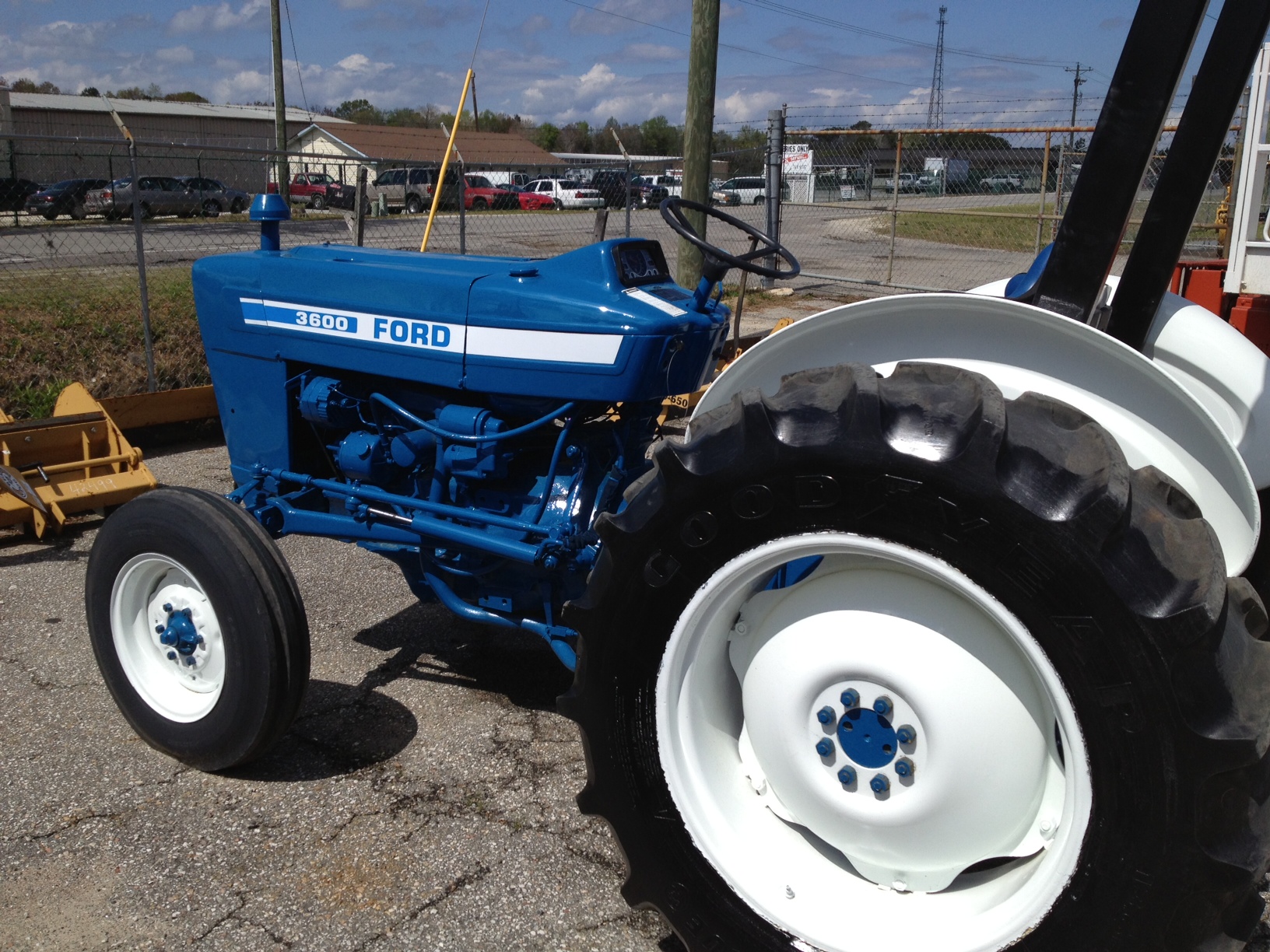

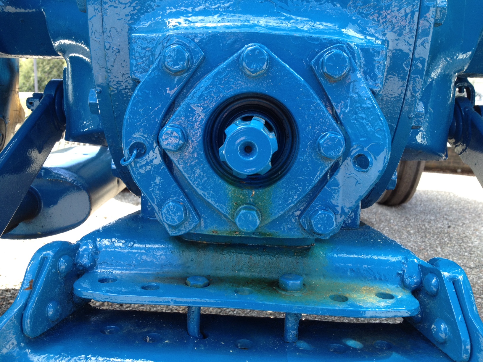

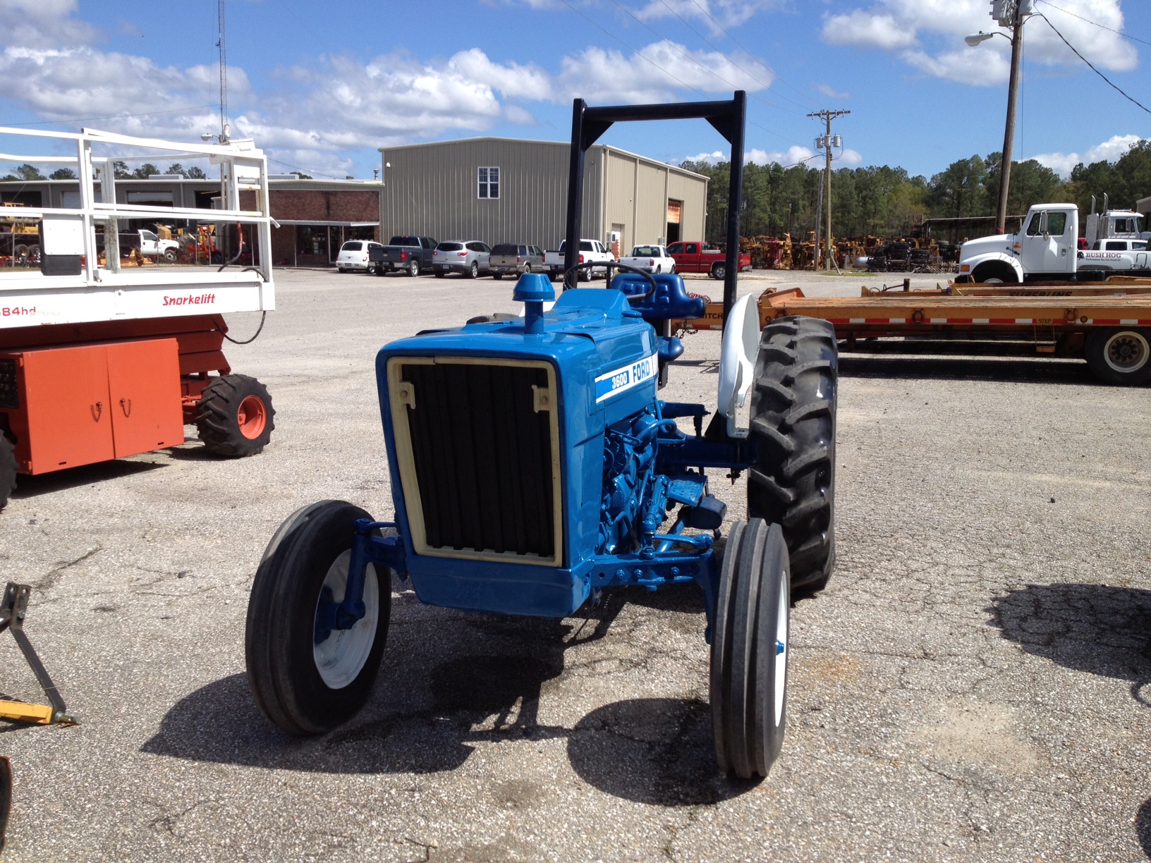

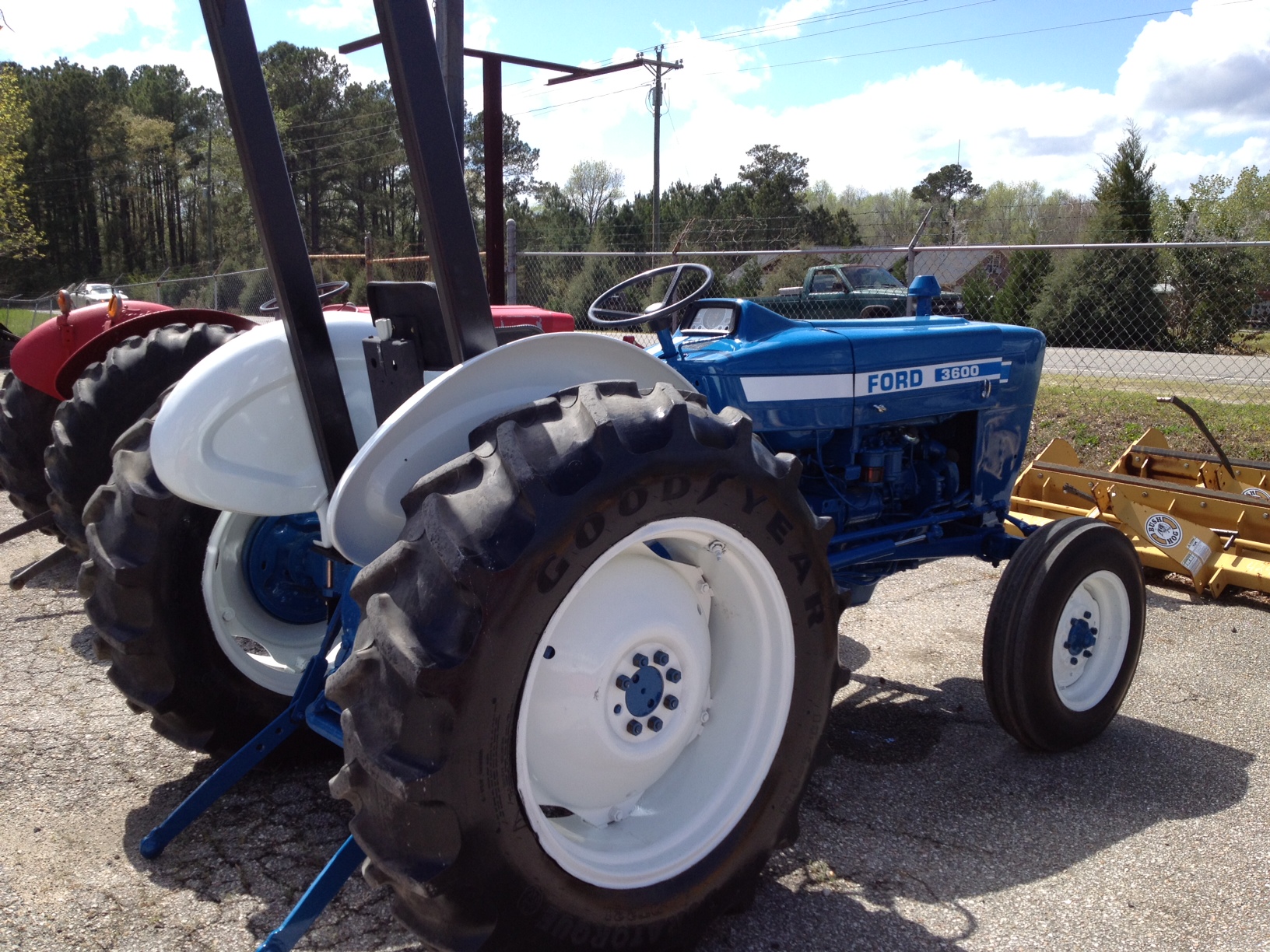

Found a business a few hours up the road that's selling a 1976 Ford 3600 diesel, asking $5,500. Transmission has been flushed, new front tires, new instrument panel, new gas tank, and freshly painted. Fires right up the first time with no smoke at all. Only thing I noticed was a little oil at bottom of pto (see picture). Wasn't sure if this was from it sitting a while of if it needs a new seal...or is a little oil there not too uncommon? Any opinions are appreciated.

That seal should be easily replaced if it is bad.

From the pictures it looks like they just painted over dirt, oil, hoses, exhaust pipe, and whatever else was on the tractor. The pto shaft is leaking, drawbar bolts are bent, no idea of hours or what they flushed out of the transmission or fuel system. I am a little scared for you going in at that high of price for so many unknowns camouflaged under shiny paint. I would recommend looking for one with some of the original patina left on it and still showing some clues to maintenance history.

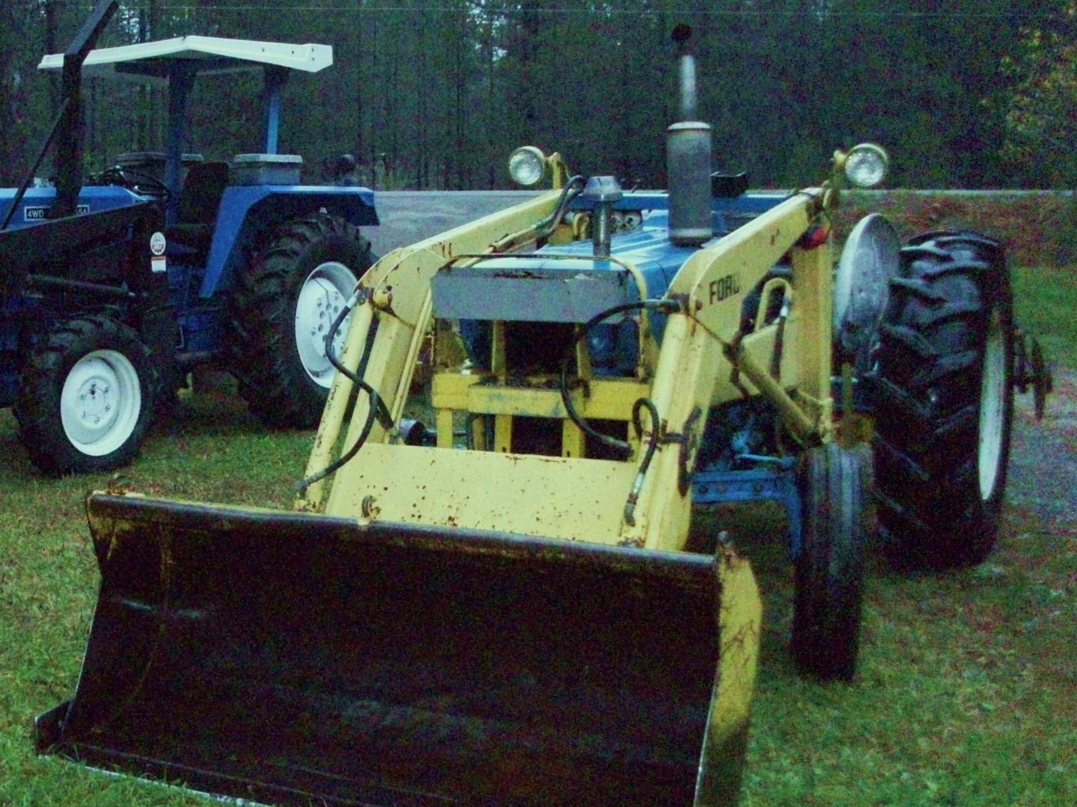

I bought my 1967 3000 diesel with an industrial Ford loader, power steering good 14.9x28 tires but it has the selectospeed 10 speed transmission (came with the rebuild receipts from the local New Holland dealer) No issues , I paid $3850. I know- IT'S A SELECTOSPEED they aren't worth as much as a manual trans model, clean tractors 007.JPG that being said
I think that price is to high , if it had a loader for that price I would check it out closely and if OK buy it. but if that's all the prep work they were willing to do on the paint, how much can you trust the other work...I would keep looking -there are a lot of 3000 and 3600 Fords out there... A 3000 is older, but a well cared for one is at least the equal of the 3600
You will be amazed at the amount of work a 2 wheel drive tractor this size can do, with loaded tires and a heavy weight on the back like a gannon box blade, if you really like the Fords, a 4000 or even 5000 are also great machines.. good luck

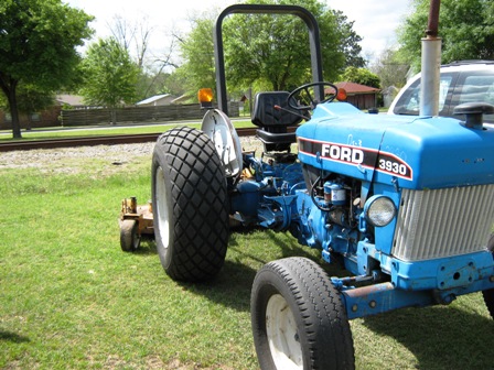

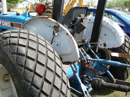

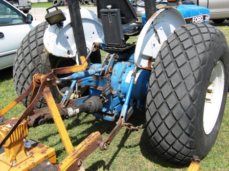

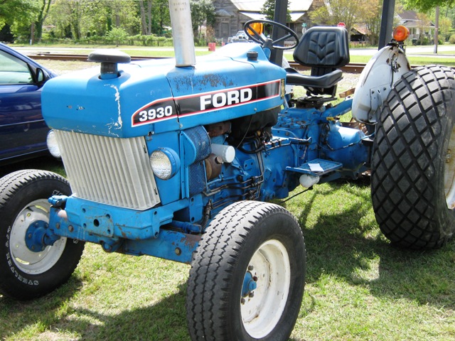

Thanks for all the comments and advice. Will be looking at a 1996 Ford 3930 tomorrow, with 2500 hours. It's NOT been painted, so no wondering what's underneath all that blue. I've been told there's no leaks or any issues at all except for a little rust here and there. He's asking $8,000 and when I said it was above my budget he said he's willing to come down on the price. It has newer turf tires which I hope won't be a problem for my initial box blade work (a 3' high line of soil that's over 300' long on mainly flat land). The whole 10 acres is pretty darn flat and I don't need to do any clearing, just bush hogging and such.FORD 3930 TRACTOR 405EQ 001.jpgFORD 3930 TRACTOR 405EQ 002.jpgFORD 3930 TRACTOR 405EQ 003.jpgFORD 3930 TRACTOR 405EQ 004.jpg
/ Ford 3600, what do you think? #10
Thanks for all the comments and advice. Will be looking at a 1996 Ford 3930 tomorrow, with 2500 hours. It's NOT been painted, so no wondering what's underneath all that blue. I've been told there's no leaks or any issues at all except for a little rust here and there. He's asking $8,000 and when I said it was above my budget he said he's willing to come down on the price. It has newer turf tires which I hope won't be a problem for my initial box blade work (a 3' high line of soil that's over 300' long on mainly flat land). The whole 10 acres is pretty darn flat and I don't need to do any clearing, just bush hogging and such.View attachment 311344View attachment 311345View attachment 311346View attachment 311347
You won't have a problem with that front axle, believe that's one of the last few years of the (real) Ford designed tractors. I don't have any experience with turf tires, do you get snow down there- if not it might even be better this way, if the main use is running a brush hog...

if it's a pto seal only.. it's about 20$ for a new seal and gasket.
make sure it is not a bad bearing... with machine off.. grab shaft and see if there is in / out movement or side play. if none.. it's a realitively easy fix.. just make sure pto engagement is 'in gear' before you slide her out... and tip nose down to prevent loosing oil.
it's about a 6 m job to pull the 4 bolts, slip the shaft out, pop out split rings.. drop bearing carier off shaft/bearing.. drive out seal... seat new seal.. lube.. clean carrier, reset shadt and split rings.. clean gasket surface, add gasket, stab hole and slide home. put in 4 bolts.
