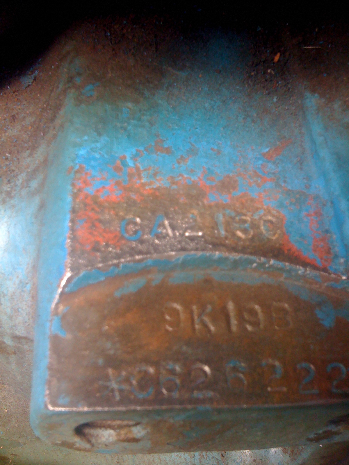

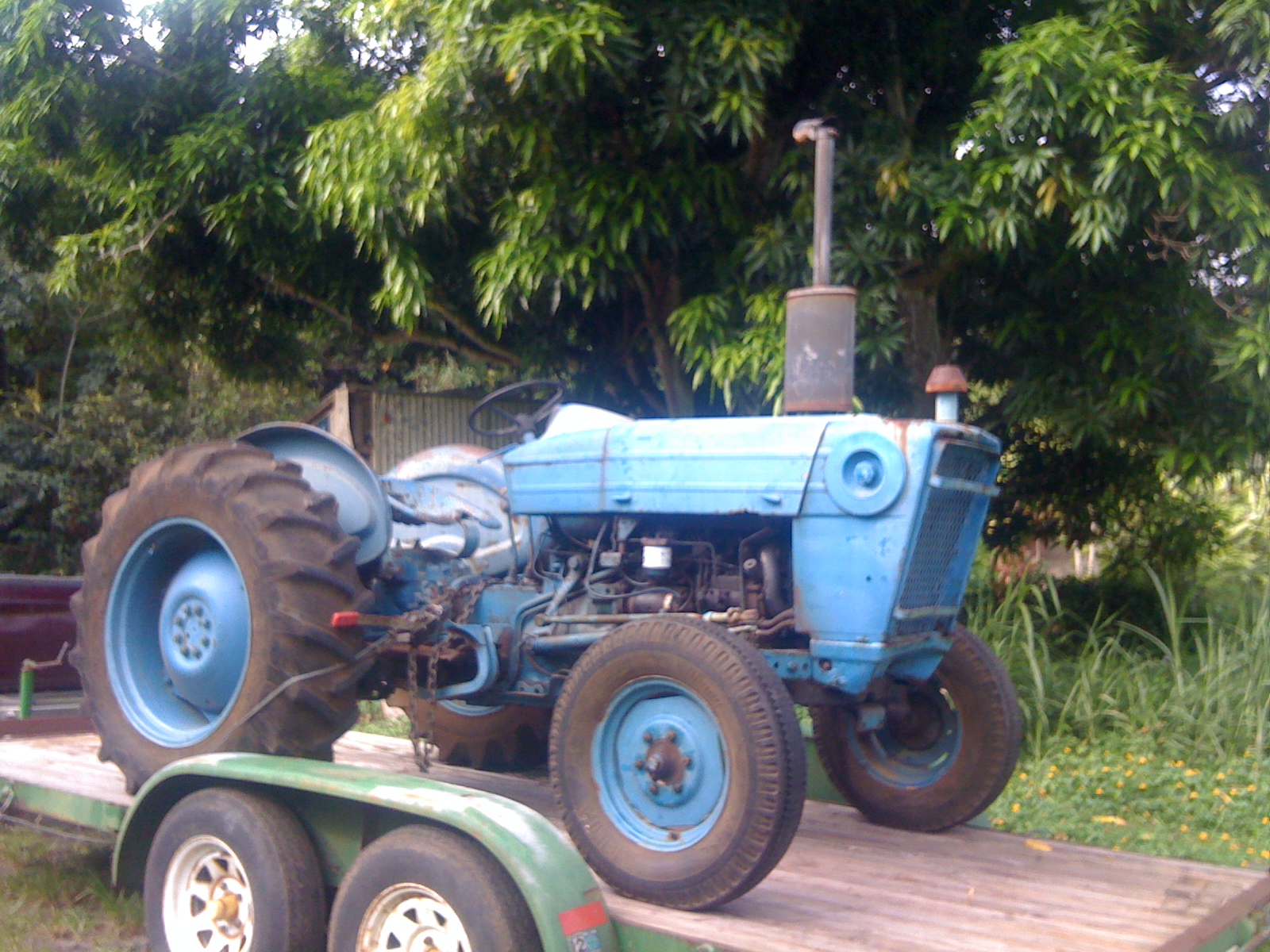

Hello all!
Just bought an old Ford tractor. Need help identifying it before I buy an operators manual.
Model#: CA213C
Production Code: 9K19B
Serial#: *C626222
My best guess is its a 1979, 3600. Seems like 6/2 transmission, but I feel like it should be 8/2......
All help is greatly appreciated!

C should be an 8spd.. IE.. a 4spd twin stick.
/ FORD 3600? 1979? #4
i'll admit to not having my chart in front of me. but that liast digit of the model id is normally 'trans type' and C is usually an 8spd twin stick.
someone like rickb or whodat or ultradog can confirm or correct me here. I'm at work away from my manuals.

WOW thanks for such a quick reply. I'll double check to find the gear all the way to the right. Her brakes arent working very well, and am going to take a closer look when I get a chance. Any thoughts on the model? Which manual would be the best for the brake job i'm intending to do?
Thanks again so much.
/ FORD 3600? 1979? #6
they are simple drum brakes.... check the star wheel for adjustment. either out of adjustment. shoes gone. or more rarely.. drums worn out.
even the lowly I&T manual will be fine.
heck... drum brakes. no manual needed!!! ;)

I guess I'll know right away if have an axle leak. Braking makes no sound at all. Im not going to have time this week so I'll repost what I find when I get there. Shoes look like 28 bucks apiece. I don't mind coughing that up but I have little experience and axle trouble seems hefty.
/ FORD 3600? 1979? #13
check for adjsutment first. if you cna't adjust them satisfactorilly. then pull the tires and see what ya got.
/ FORD 3600? 1979?
#14
Good call. Ill adjust to find out if that was all,
Yesterday I was running for about twenty minutes and she died out. Seemed like fuel got cut off. Gonna replace the fuel filter, hope that does it. Noticed there is no oil gauge, no temp gauge, and possibly no coolant circulating, hoping for the best, is there an easy way to make sure?
I'm thinking I should install a temp gauge before I proceed.
Any suggestions...? Your advice is greatly appreciated.
