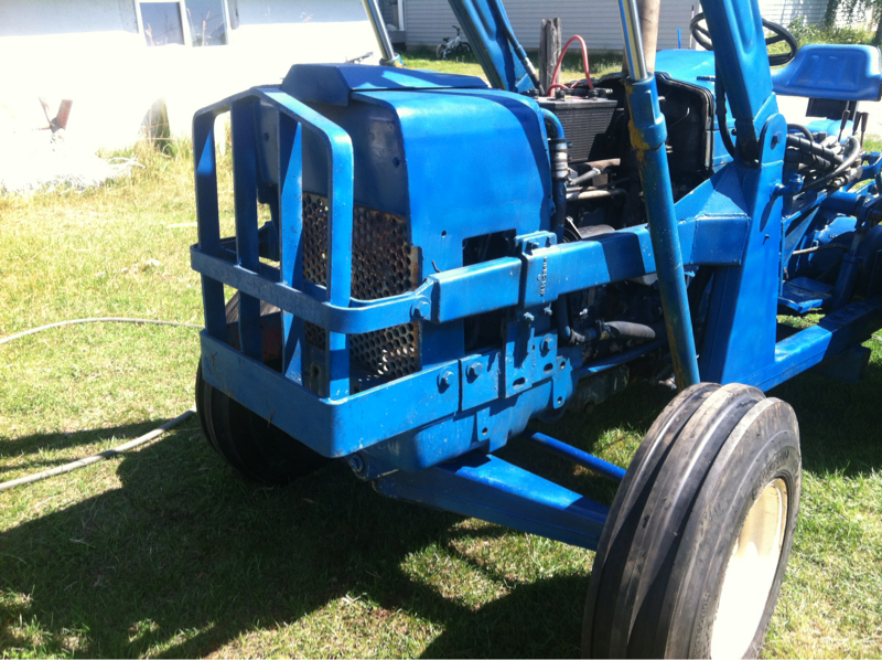

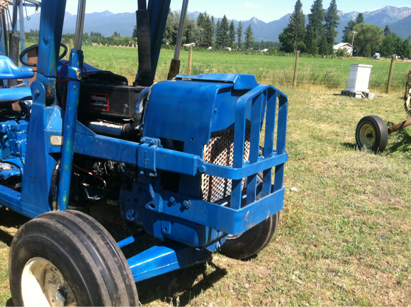

well.. she ain't a 3000.
gear reduction rear ... and wet brakes.
heavy front bolster.. and that front axle ain't the 1939 design.. looks like some sort of industrial. I'm not up on all the 4 digit and 3 digit industrial variants.. but could be some sort of 3 digit industrial. front axle is deffinately not the ld fixed.. or the adjustable hd of a 4000 or a adjustable ld on a 39-65 00/01/2000/3000
a 445 is what really comes to mind... especially looking at front and back axle.
might want to bring in whodat and rickb on this.
Looks like a 4500 to me. Hard grille shell, straight axle, planetary finals with wet brakes. Factory alternator and CCW tach dial might make it a 445 except they had fully hydrostatic steering which this doesn't. Thinking a little more, it could be a 3550.

i missed the steering.. and I should have known it.. after i looked at some industrials last year.

So I cleaned out the transmission and it was filled to the top it looked like baileys Irish cream, kind of a tan so I opened the bottom drain and about two gallons of water came out followed by the tan mixture I started playing with the shift pattern and it is a 6 forward speeds and 4 reverse speeds with a high and low. So far all the parts I have gotten for the tractor have matched up when i ask for a ford 3000 part. The fuel pump, injectors and starter so far.

Everything you have asked for would probably bolt up to 30 different models of Ford tractors. Some might even be correct. That isn't a 3000 and you can take that to the bank.

Definitely not a 3000. I agree it's an industrial tractor. Looks like a 4400 to me. Do a web search for "ford 4400 pics" and look for yourself.

the gear reduction rear is simply the bulge you see at the axle trumpets... just the design.. inboard wet brakes and all.
3000 would have smaller trumpets and dry brakes outboard..

I called new holland this afternoon and got confirmation it is a 4500 industrial 1966. I confirmed also that the starter I bought for a 3000 will also work in a 4500 it actually works in 43 different ford/nh engines. I looked at tractordata.com and they only show a 63hp rating for the 4500 does anyone know what the drawbar rating is?
