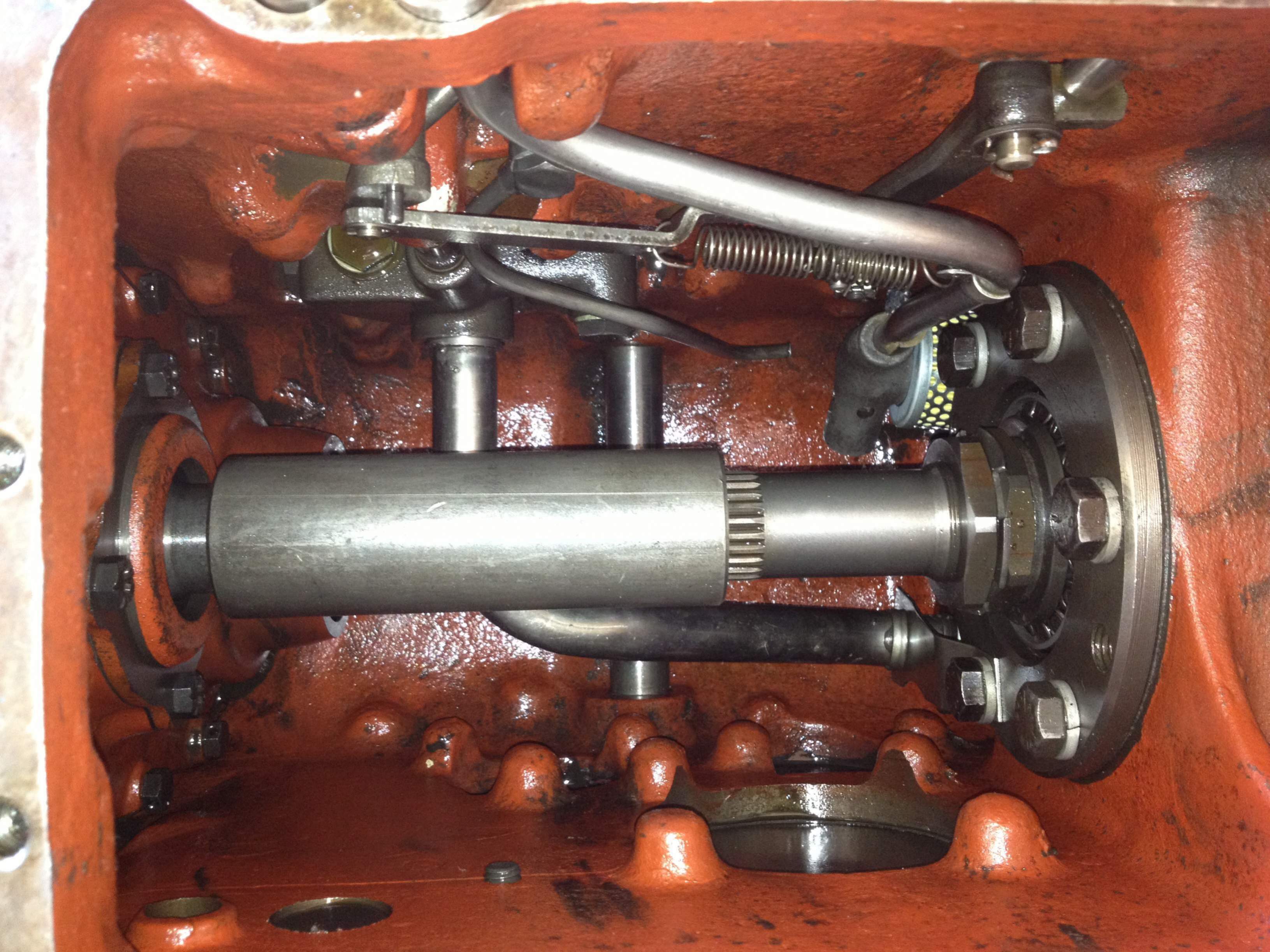

Yes, I run the same fluid in the trans and rear diff also. My mistake, I mis-read a previous post. I thought he put GL-1 in the rear diff but he puts it in the trans. There are no hydraulic lines, tubes or anything else connected between the rear diff and trans. It has to be a seal, loose screw, gasket, etc? . Here's a picture of the sump.

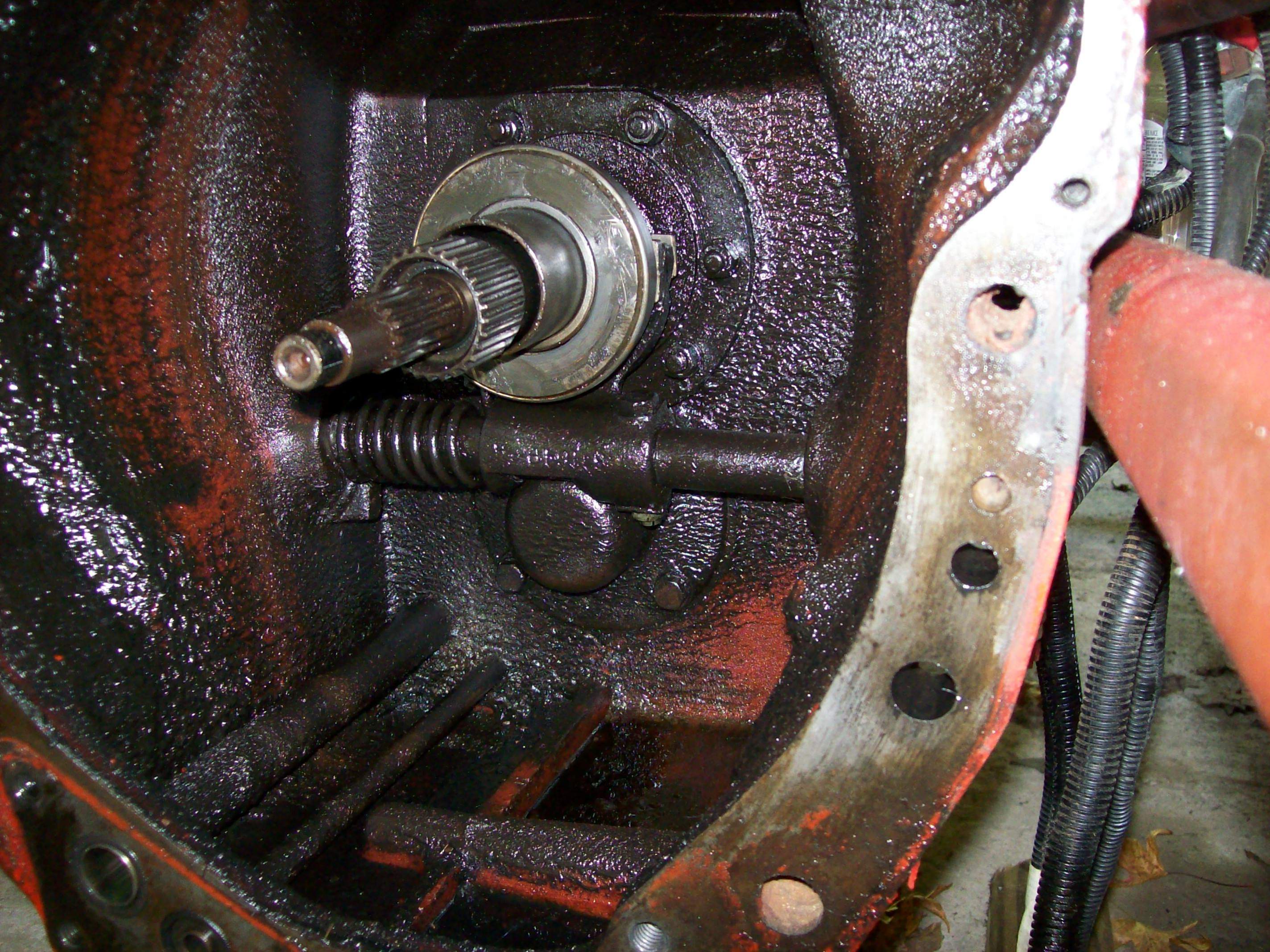

I know my 58 861D is older than yours, but mine has 3 separate reservoirs, divided by seals in the shafts. I use 80/90 wt in both my rear end and transmission, and UTF in the Hydraulics. 861 LUBES.jpg
At the bottom of the clutch housing you can see the lines from the hydraulic reservoir that comes through the transmission to the hydraulic pump on the left side of the engine.
You apparently have a leaking seal between your hyd sump and tranny....the one around that drive shaft pictured therein. Don't worry about it, not worth tearing the housings in half and all that stuff. Just drain out the tranny as it fills and top off your hyd-diff sump. Been doing it for years on my 2000 as I said.
/ Ford 3000 hydraulics #18
I'm good, just trying to help a little bit where I can with a picture or 2. I was changing the filters in that picture and thought someone would like to see what it looks like inside the sump. The OP is a little confused, he thinks you told him when his 3ph raises and lowers it fills his transmission. I said it has to be a seal, loose screw, gasket, Etc. because there aren't any hyd lines that go between the trans and rear diff.

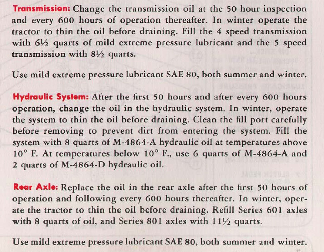

did a little checking in my fords manual:
for a 3000
oil capacity is about 24 and 1/2 quarts rear axle
and just under 14 quarts for the manual 8 speed transmission
so the Fords use quite a bit of oil- more than 9 gallons
from the ford manual
It is the same fluid (Ford M-2C53A)- the old # for both trans and rear axle.
