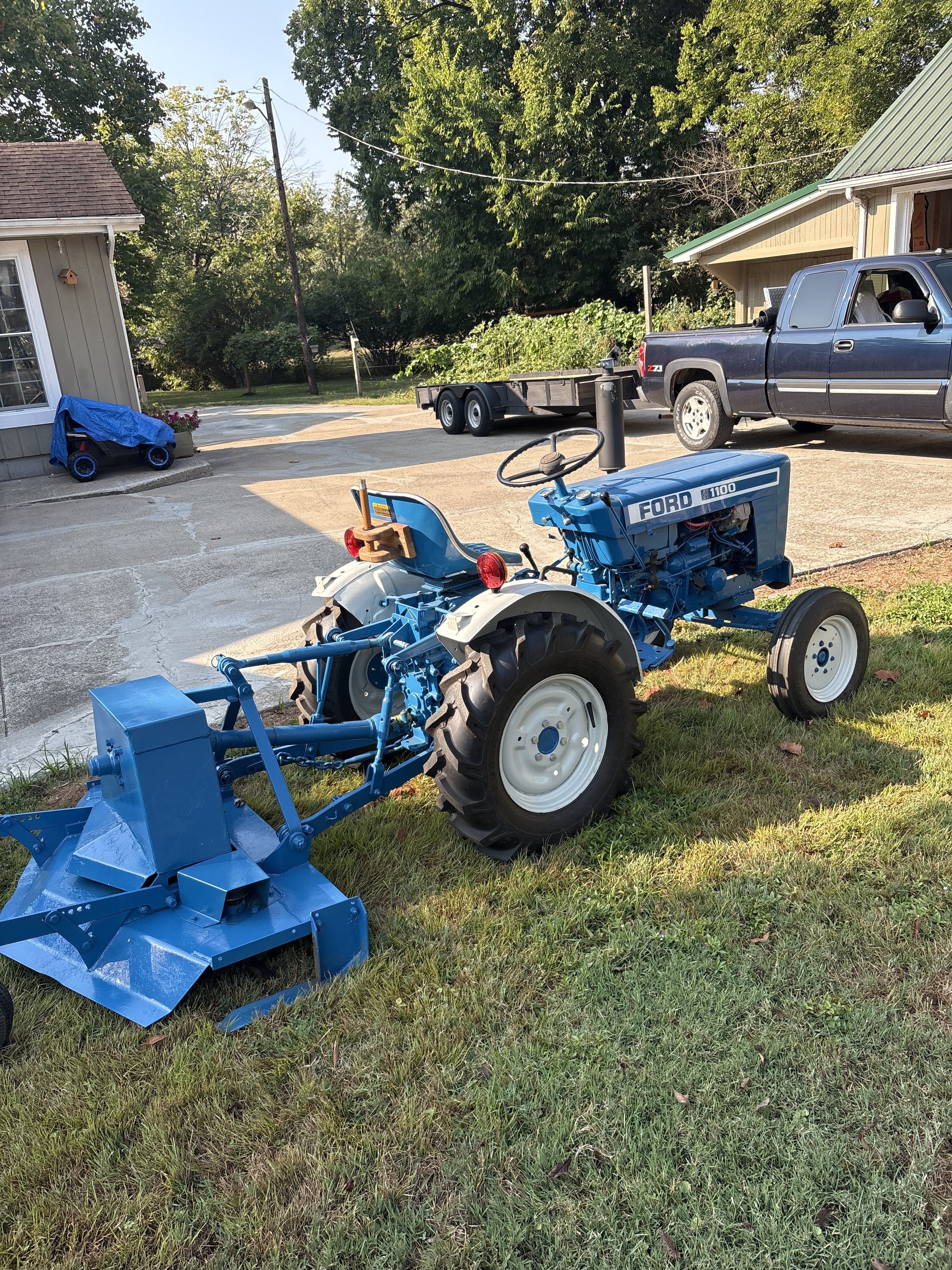

Sep 13, 2025 / Ford 1100 #1 R roberttwardzik New member Joined Sep 13, 2025 Messages 2 Tractor Ford 1100 Just bought a ford 1100 tractor. Wanting to change the cartridge filter for the hydraulic fluid. Can’t seem to find a filters. Does anyone have a part number or can point me in the right direction? Attachments IMG_3464.jpeg 9.7 MB · Views: 163

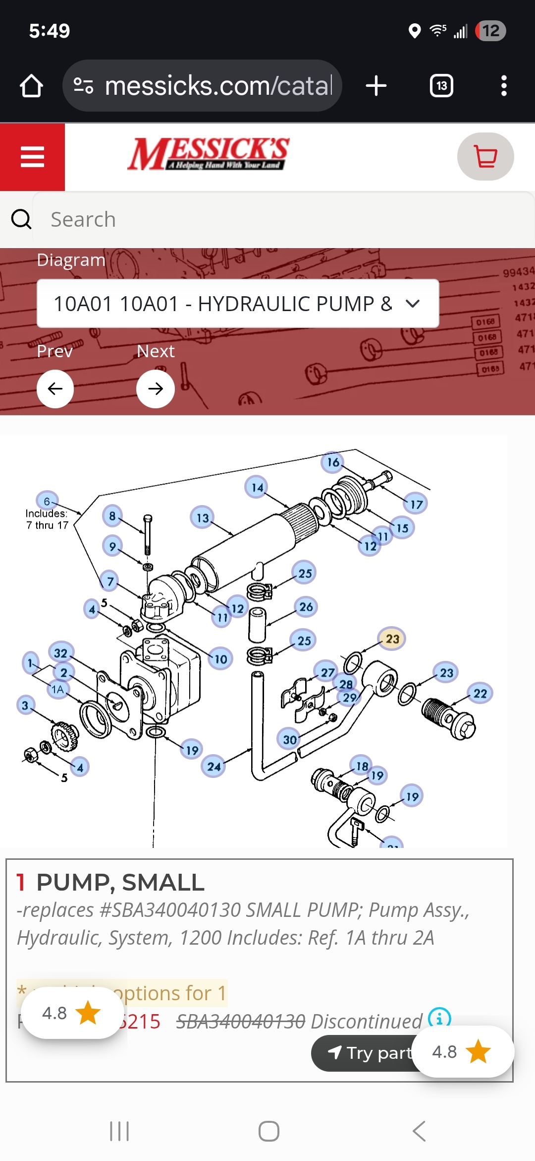

Sep 13, 2025 / Ford 1100 #2 T TractorTech Elite Member Joined Jan 26, 2012 Messages 3,125 Location California Tractor Ford 7710, Ford 550, Ford 1910, Ford 4430, KD Forklift, Ford LGT17H, New Holland L255 Skidsteer Strainer is SBA340500090, #14 in illustration Attachments Screenshot_20250913_174910_Chrome.jpg 690.2 KB · Views: 81
