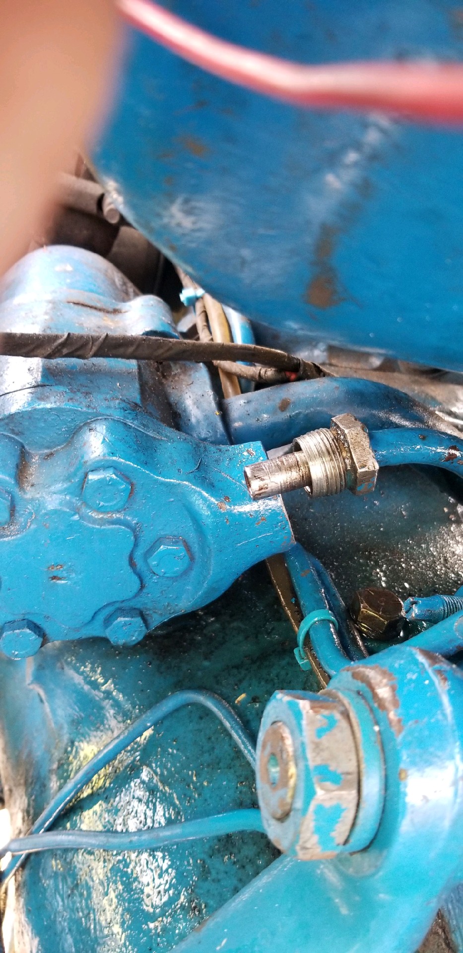

Mine is a 34100 I have the kits but when I try to lift a 800 lb ballast out it pops??

/ ford 3000 hydraulic fitting conversion #9
That looks like a JIC inverted nut type missing the flare on the tubing. Appears there is no means of a solid mechanical connection. Quite often the flare is doubled over to make it stronger. Double flaring tools do that. I do not believe it is any type of compression fitting. Ferrelled compression fittings will not withstand hydraulic pressures unless specifically designed for that service like "Swedgelock" makes.
Ron
/ ford 3000 hydraulic fitting conversion #11
There is no flair as the other end is just the same This is the repair kit that is supposed to fix the problem however the steel lock washer will not fit on the tube with out some modification which defeats its purpose.I was just wondering it there was another way to get around this setup

/ ford 3000 hydraulic fitting conversion #14
I went ahead and ordered a new pressure tube and two compression fittings as well as one seal for the pump end. I have a question, how do I keep the seal (#47697560) on the pump end from squeezing out when I tighten the pump end compression nut. I am assuming the seal goes under the nut on the exterior of the pump. I looked at the parts diagram and can not determine correct location of the seal?C27C763B-9A65-4DEF-82E0-D5826BBE1C81.jpeg9855E56F-5D68-40EB-B075-DCB004A8F2A8.jpeg
/ ford 3000 hydraulic fitting conversion #15
Did you get all the parts shown above? If so I put the white plastic washer in the pump then put a copper washer in each end of the rubber seal and push the tube through the whole thing and screw it into the pump. You have to be very careful not to get it crooked or it will crush to the side and pop out.I did this several times and the tube still popped out at peak pressure (even with new pressure valve) so the last time after I got it together and it didnt leak I tacked the tube to the nut Not like Ford did it but works for me
