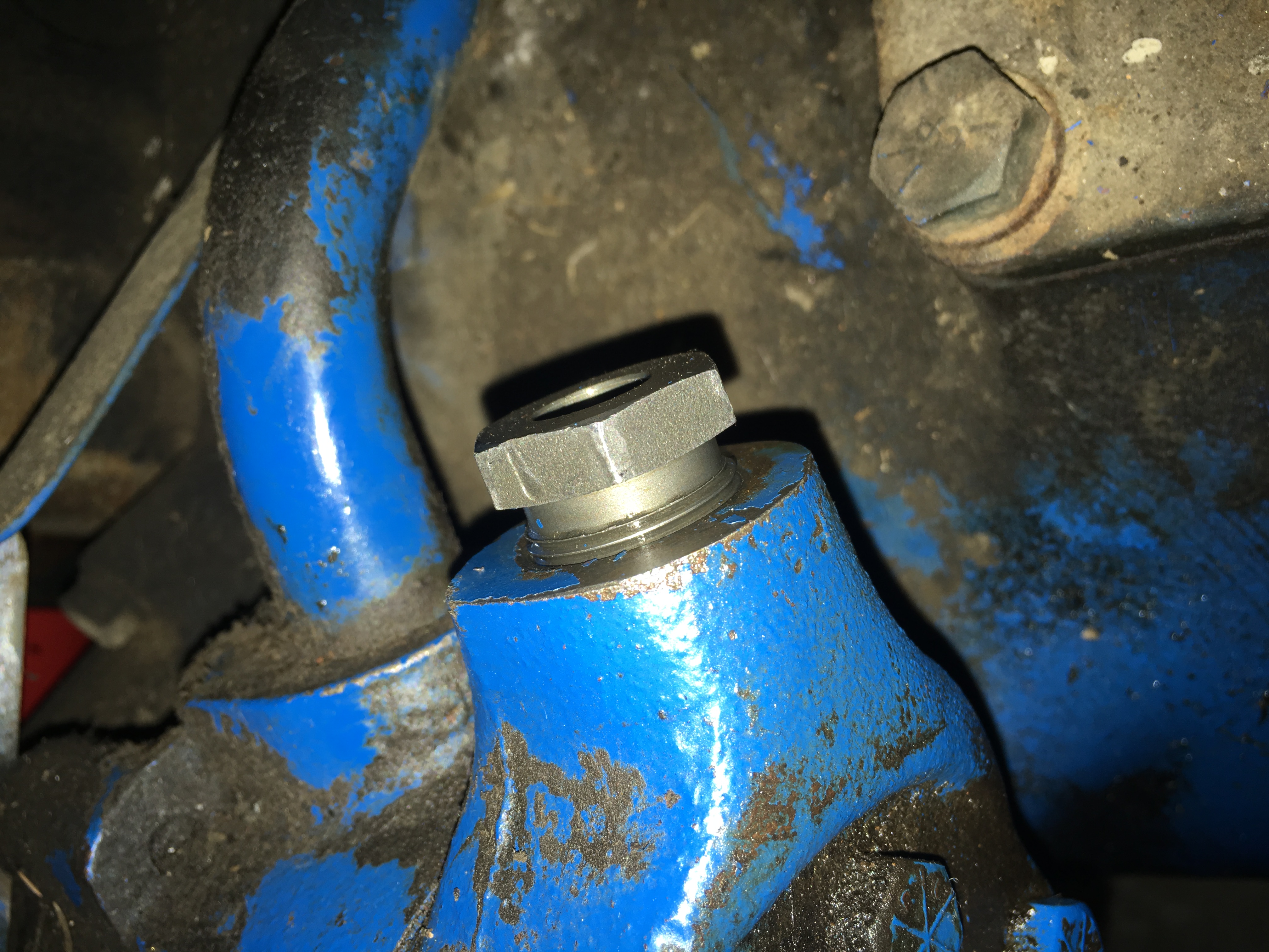

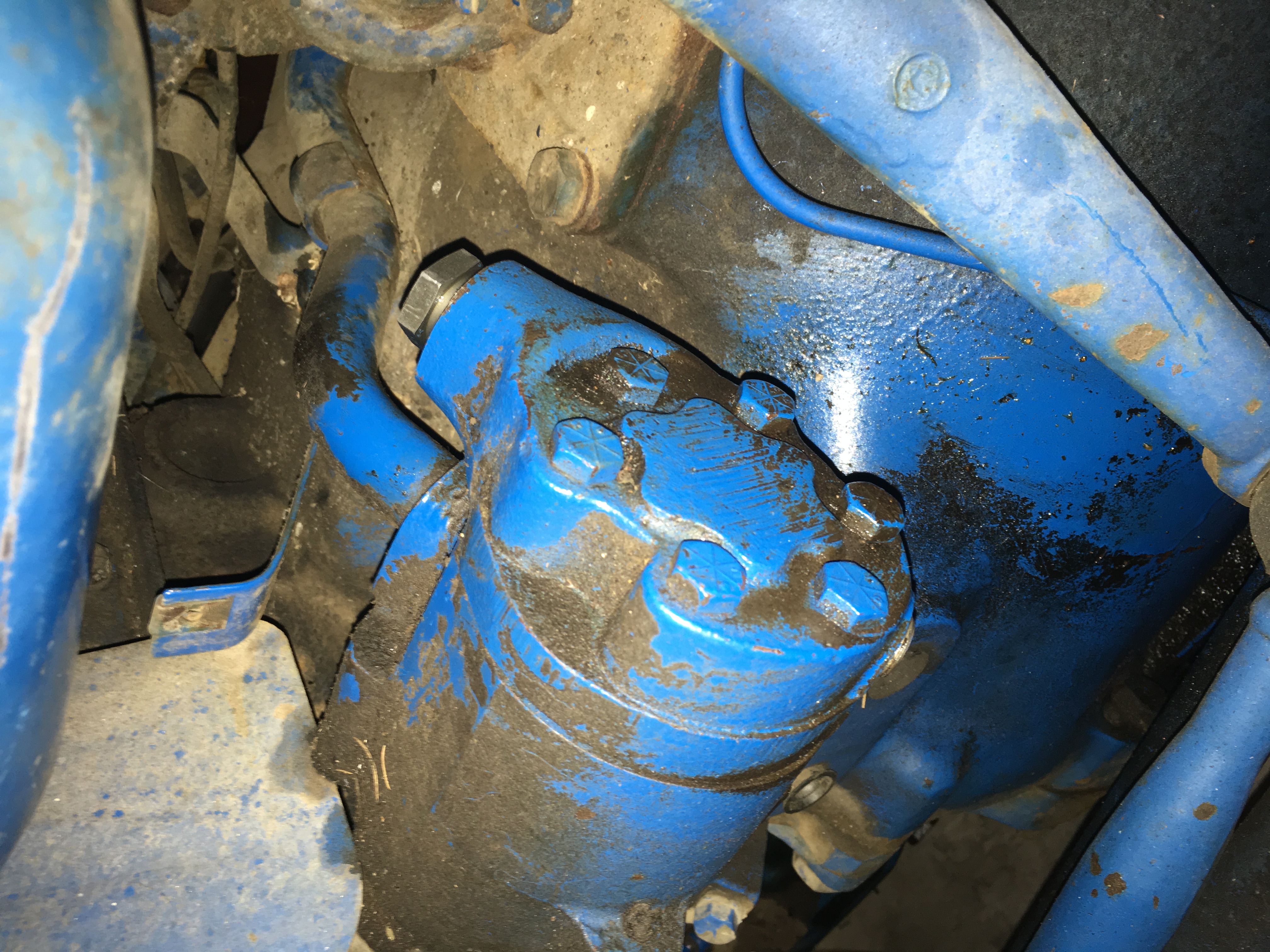

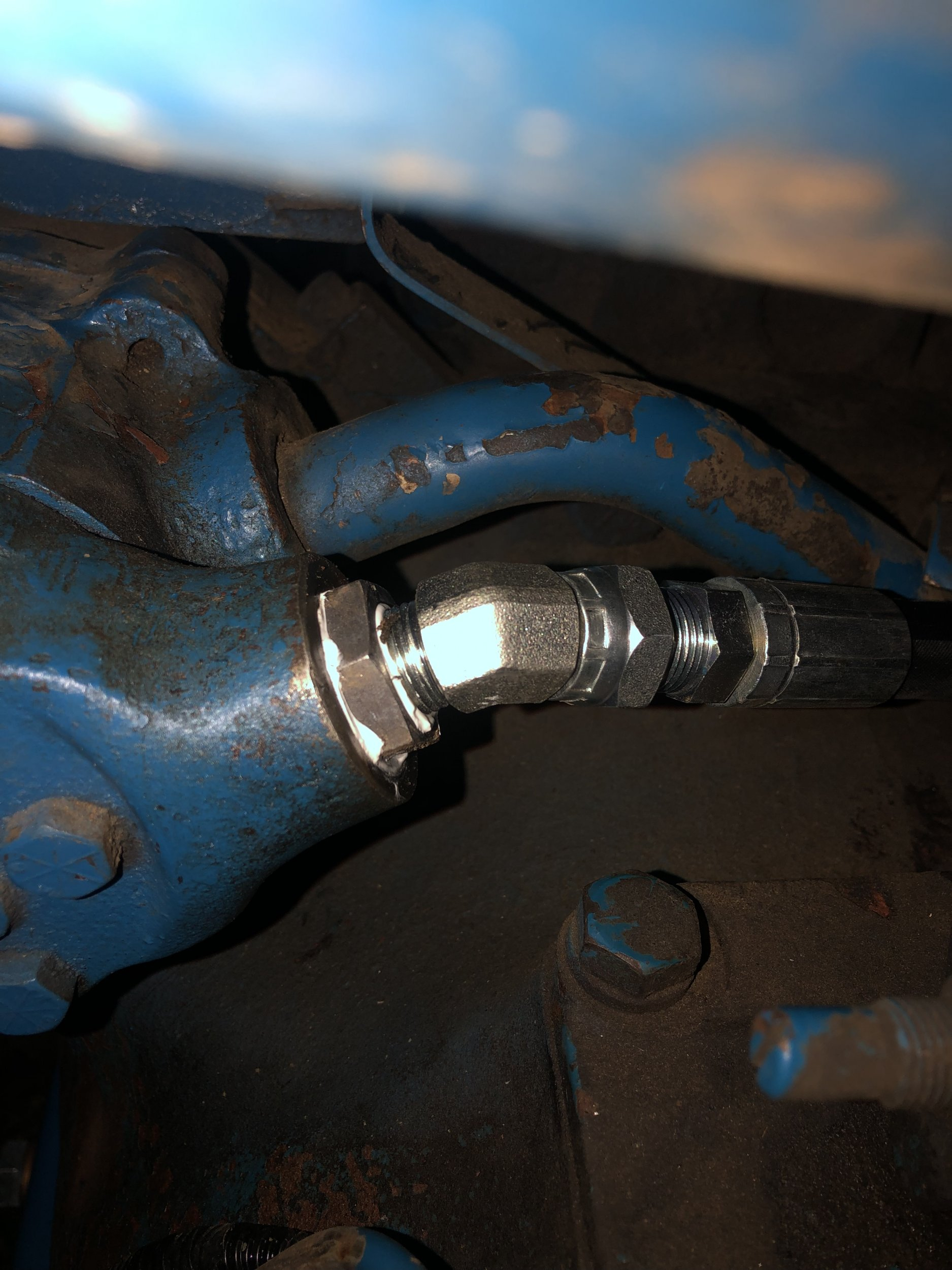

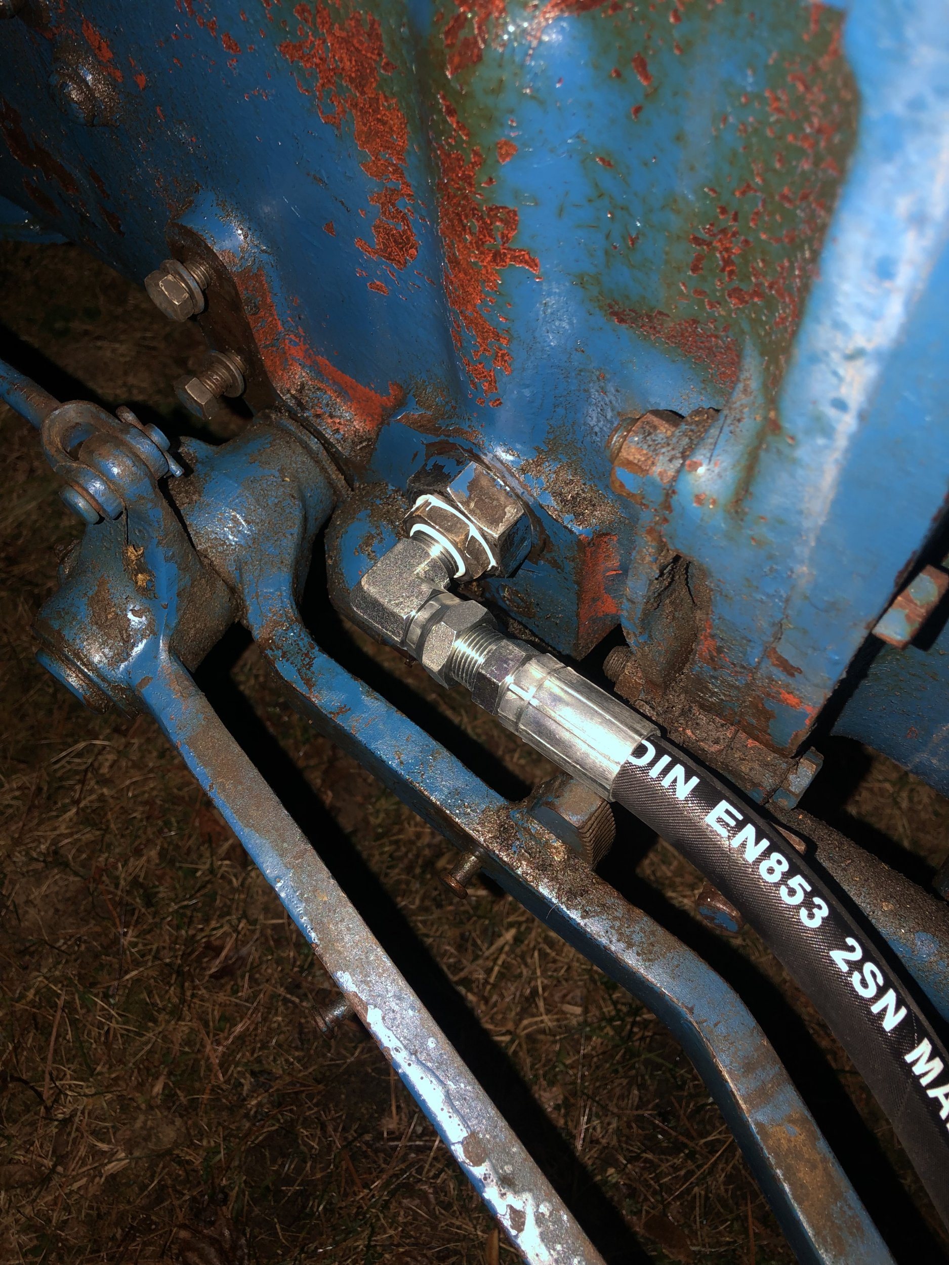

So I know it’s old but I’m sure people have the same problem still. Ford screwed up on this design and I hate spending money to fix a bad design with a bad design lol. So what I did is drilled and tapped the compression nut to accept a JIC fitting. Then ran a rubber hydraulic hose. I used 3/8” fitting and hose…yes smaller than original and may have to upgrade to 1/2 idk yet. I believe the 1/2” would work but would be tight. You need a 90 degree on the belly and a 45 degree of the pump. I used the rubber piece from the nut to act a seal. I also put thread sealer on the compression nut and jic fittings. The hose is 4’ and I bought it at tractor supply for 20$.

Hey Firemedicman, is this fix still holding up?? I'm getting ready to do the same conversion on my '74 Ford 3000, just bought the tractor right after getting my first home on 23 acres, it had been sitting for quite awhile so I've been freshening it up, it blew out the pressure line from the pump, so I spent the $40 and installed a new compression fitting and after bush hogging for a few hours it just blew out again, I'm assuming my line is bad, and I'm not a fan of the design either so I want to hopefully do as you've done and convert it over to rubber line, I have the 3/8 NPT thread tool at work to tap the nuts, are you able to just remove the line, compression fittings, and tap both the nuts at the pump and rear end?? I don't mind buying the 2 angle couplers and the line, but want to make sure I have it right and need to tap both nuts, and want to make sure it will hold up, thanks in advance man!!

My 72' 2000 diesel came with this type of repair for the high pressure line. The one thing to be mindful of is that if you don't extend out from the belly a bit before making the 90 deg bend, you will not be able to use your emergency break lever. The line will cross right over the ratcheting piece that is welded to the brake pedal arm (you can see it in the pic above). My handle at the floorboard was disconnected and I had to get that and new linkage as I extended the straight portion from the belly by about 3/4" to be able to use the e-brake. I'm in hilly terrain and the e-brake is mandatory.
