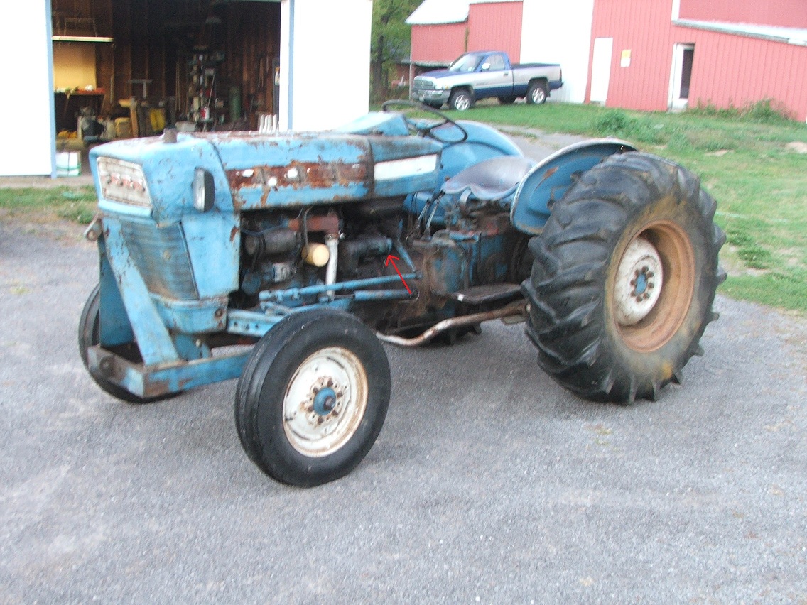

I feel your pain, I spent the better part of 2 years figuring out the 3pt problems on my 3000.
If it was working before, I would suspect that your pump just needs to be primed. There is a plug on the bottom side of the pump (see arrow in picture), on the end closest to the driver. You will need an allan-wrench to remove it. With the fuel turned off and the plug removed, crank the engine over until oil pumps out of the hole without any bubbles. Then with still cranking reinstall the plug.
If you plan on keeping the tractor for a while, I recommend buying an I&T Shop Manual for the Ford. Mine has been a handy resource for the repairs.
