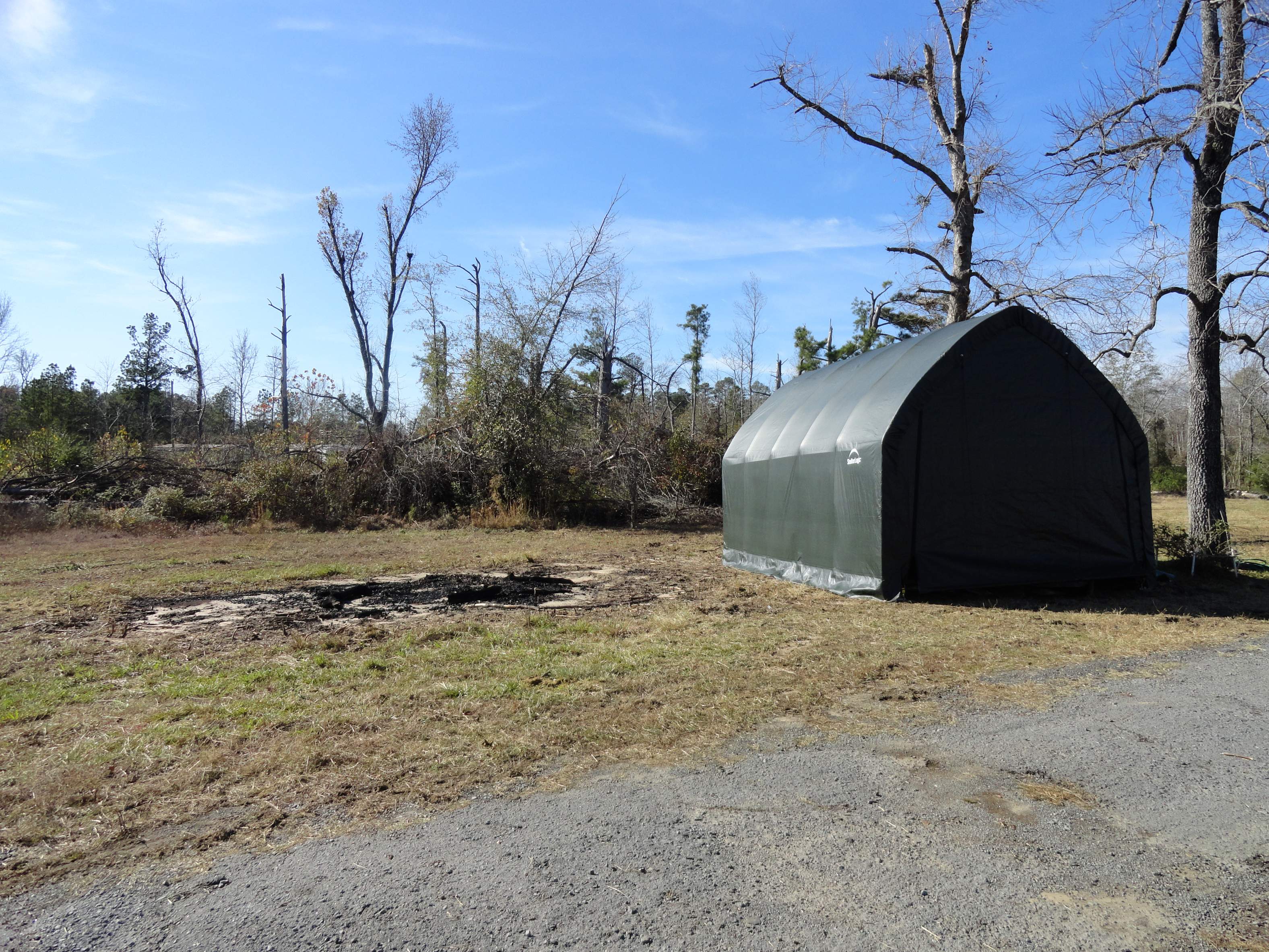

The alternator has 'Motorcraft' on the side and three wires coming from it. Will look more today.
Friday, while using the box blade to clear stuff, I ran into a branch that put a hole in the radiator. Removed the one from the 8N, but the shroud is different, so I'm swapping that today. Also, going to swap the spark plug wires to the copper core while hood is off. A couple of the old carbon center wires's insulation was rubbed off by the alternator belt. When the radiator leaked, the wires got wet, and the tractor wouldn't run. Dried them off and it stated ok, though. Got the tractor back to the garage-in-a-box/tent shelter for the repairs in the shade. (makes me a Shade-Tent mechanic)

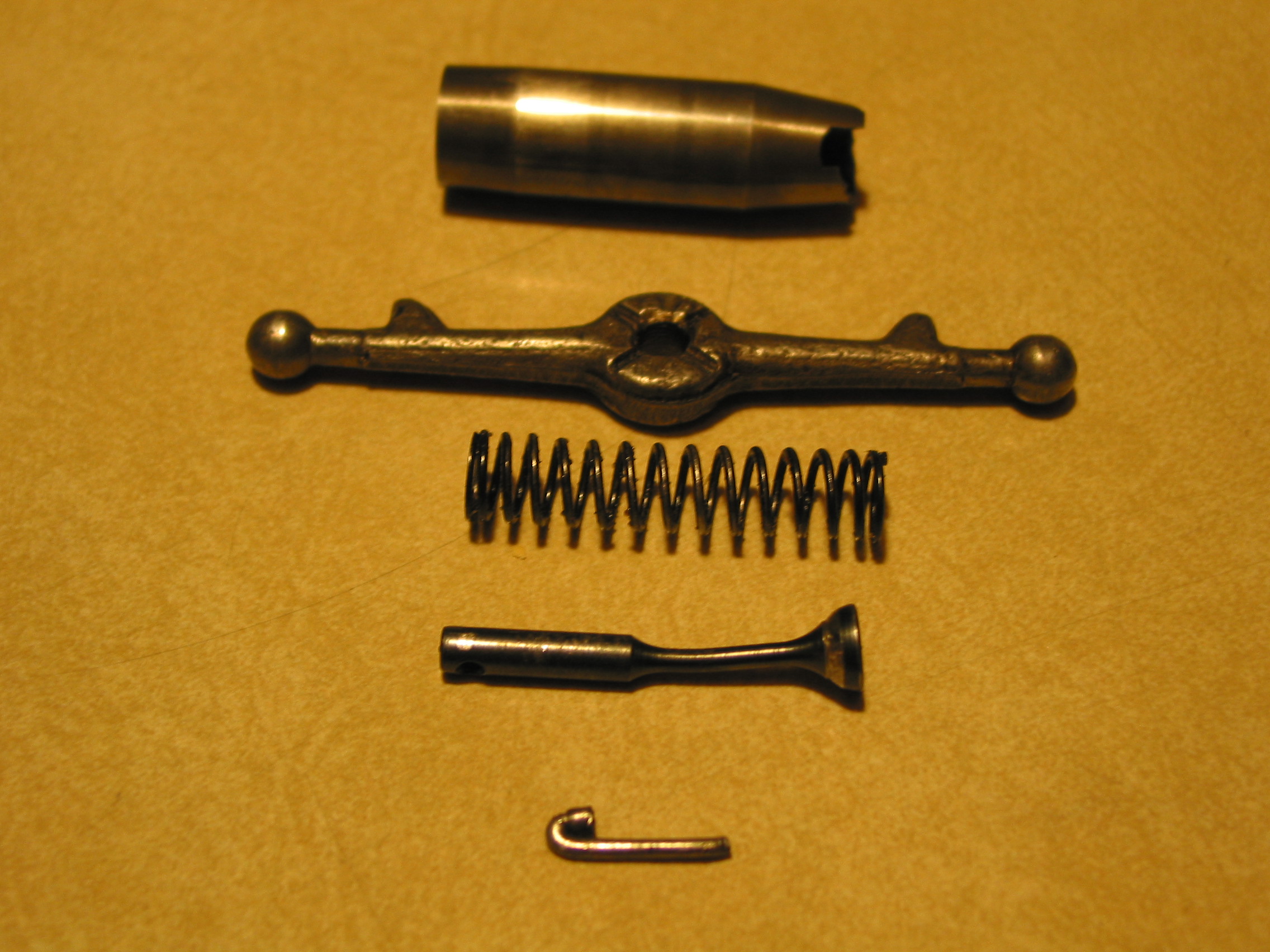

I am new to this forum. I have a 1946 2n with lift problems. The lift fork pivots and has a spring that connects to the cylinder assy. I removed the top cover and drained the ucky fluid and found the broken spring in the bottom. I have searched the 9n/2n parts places and can't find a replacement spring. Any thoughts?
/ Ford 2N - 1945 #53
post specific pics of all the parts you are looking for. or refer to them via part number.. it helps
