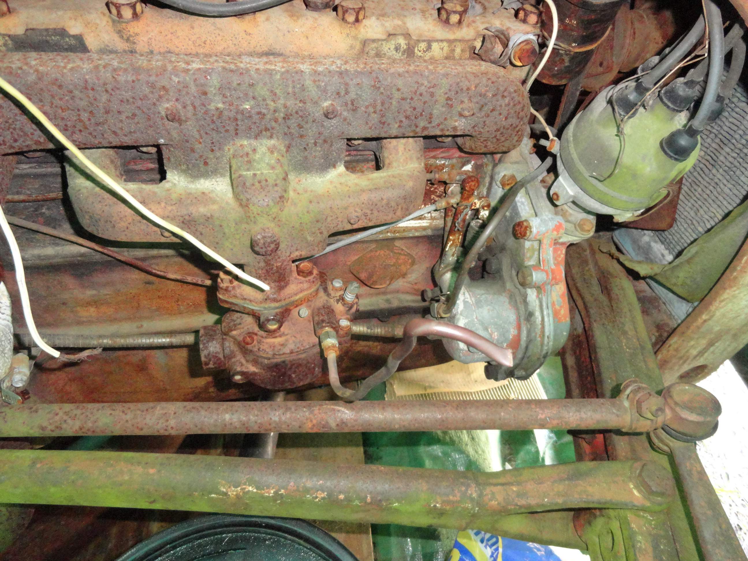

The 8N has other issues besides the wiring. The lift cover is damaged by the draft control. There is a dirt-dobber nest inside the hydraulic area. I'll plan to get a photo. Took the 8N hyd pump apart and the pistons look better than the 2N. It doesn't have a Sherman. The PTO shaft has an over-running-coupler and the larger spline. Could swap it to the 2N, but my bush hog uses the smaller spline.

The 8N serial number is 8N427375 so I guess that makes it a 1951 model. I got it for $400. Took the better bumper off, the hyd dipstick, the oil cap. It has better tires than the 2N. Got two adjustable top links. It was supposedly running before the ladies boyfriend attempted a 12V conversion and messed it up. She said she got rid of the boyfriend, and now she has gotten rid of the tractor, too. But externally, it looks older than the 2N. Must not have seen much of a shed or a grease gun. Lot of play in the steering. After I get the 2N lift working and finish clearing some brush, etc, I may try to start it using stuff from the 2N.

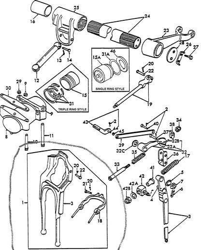

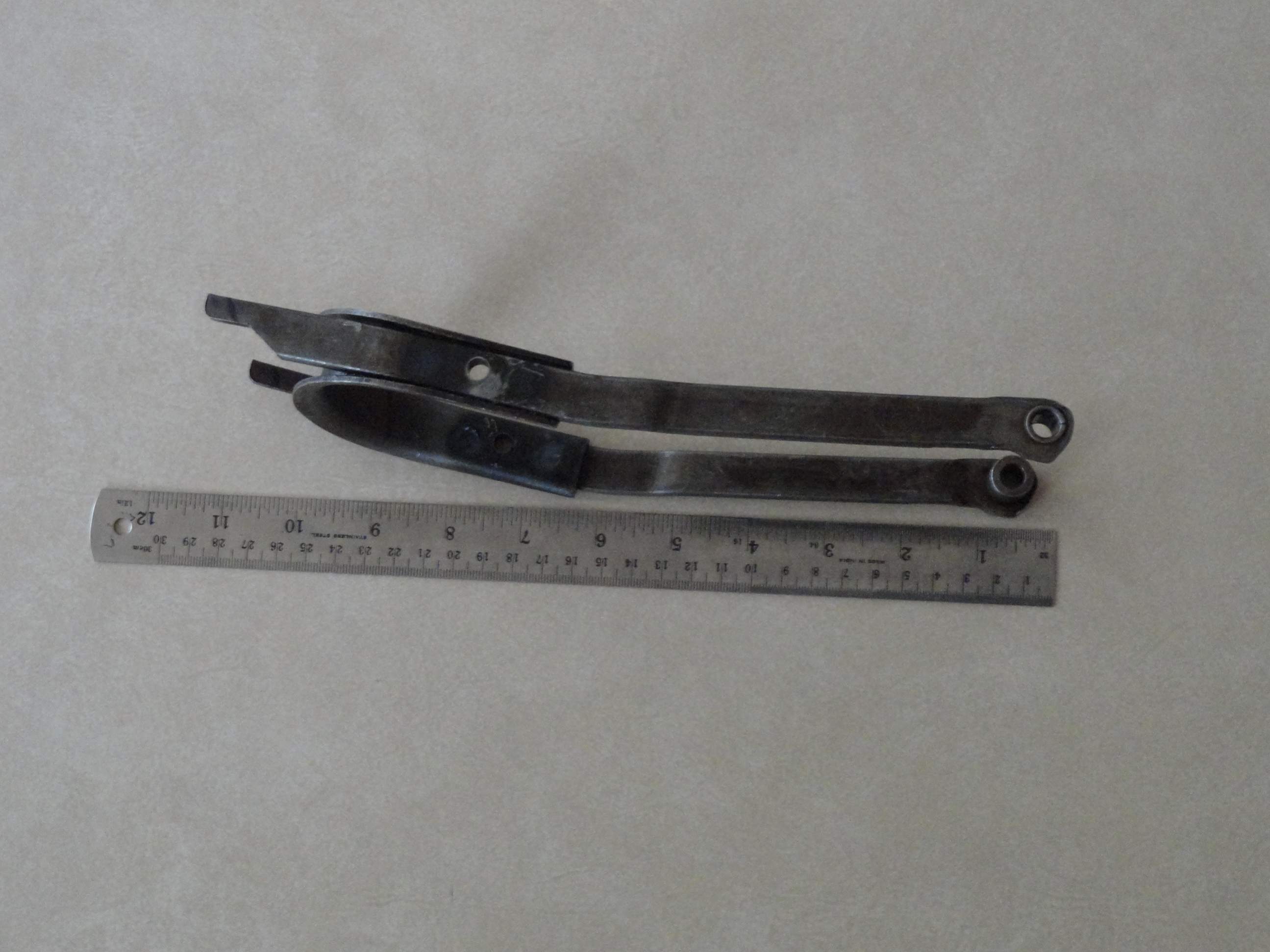

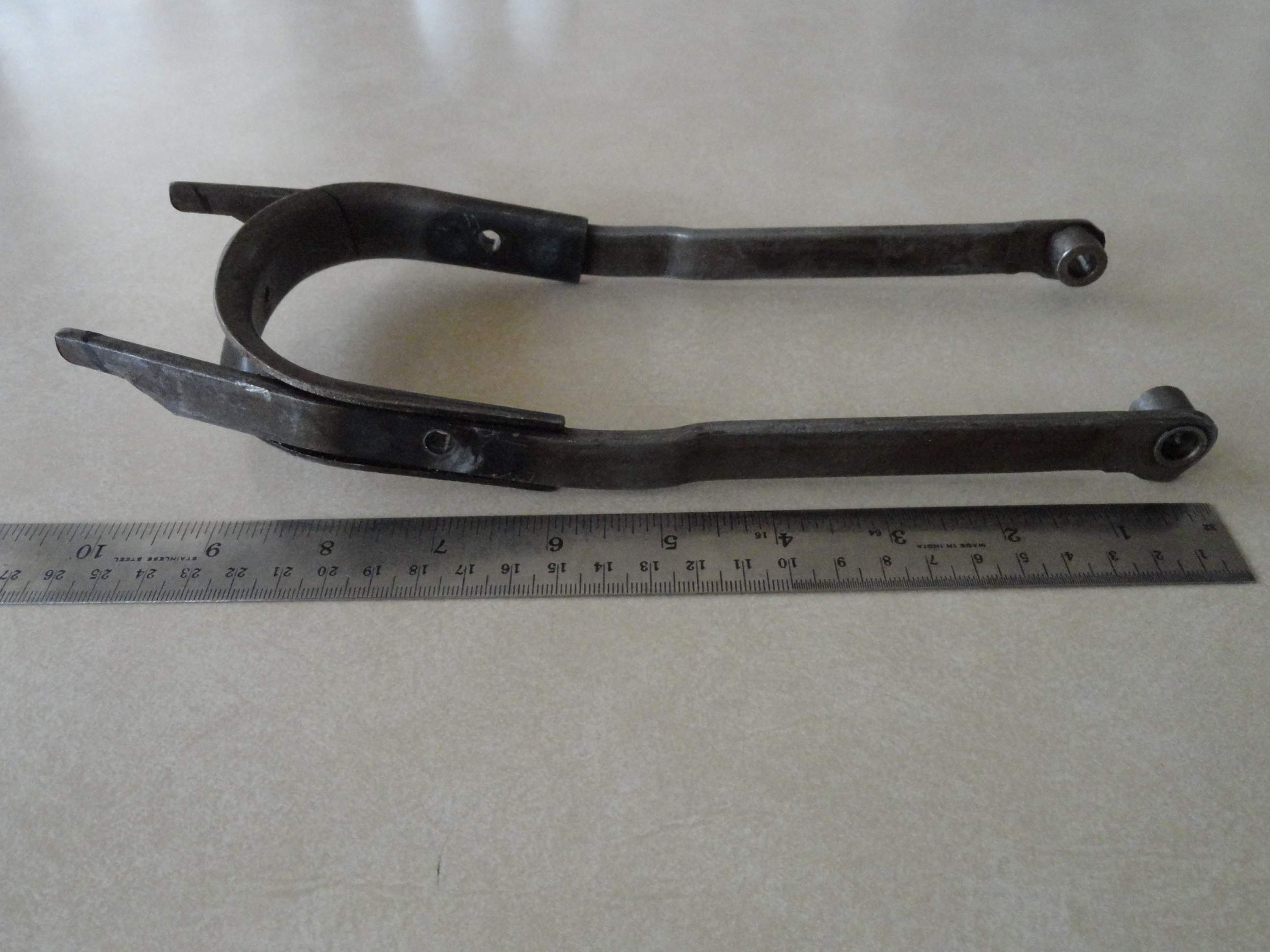

Is the lift fork supposed to be straight? Mine is bent. Both sides are bent the same amount and it looks like it could be made that way. The bend starts right after the curved reinforcement on both legs. Hard to tell from the Parts Manual diagram.

/ Ford 2N - 1945 #32
bottom left

Thanks SouNdguy. Saw that pic in the manual but still couldn't tell. Straightened it and put it back in. Filled oil to just below PTO with side cover off. No leak coming from the relief valve. No obvious leak from the stand pipe. Didn't see any around the gasket areas. No drips from the ram cylinder. Some "tiny bubbles" coming up from the pump area. The rebuild kit is on the way from Just8ns.

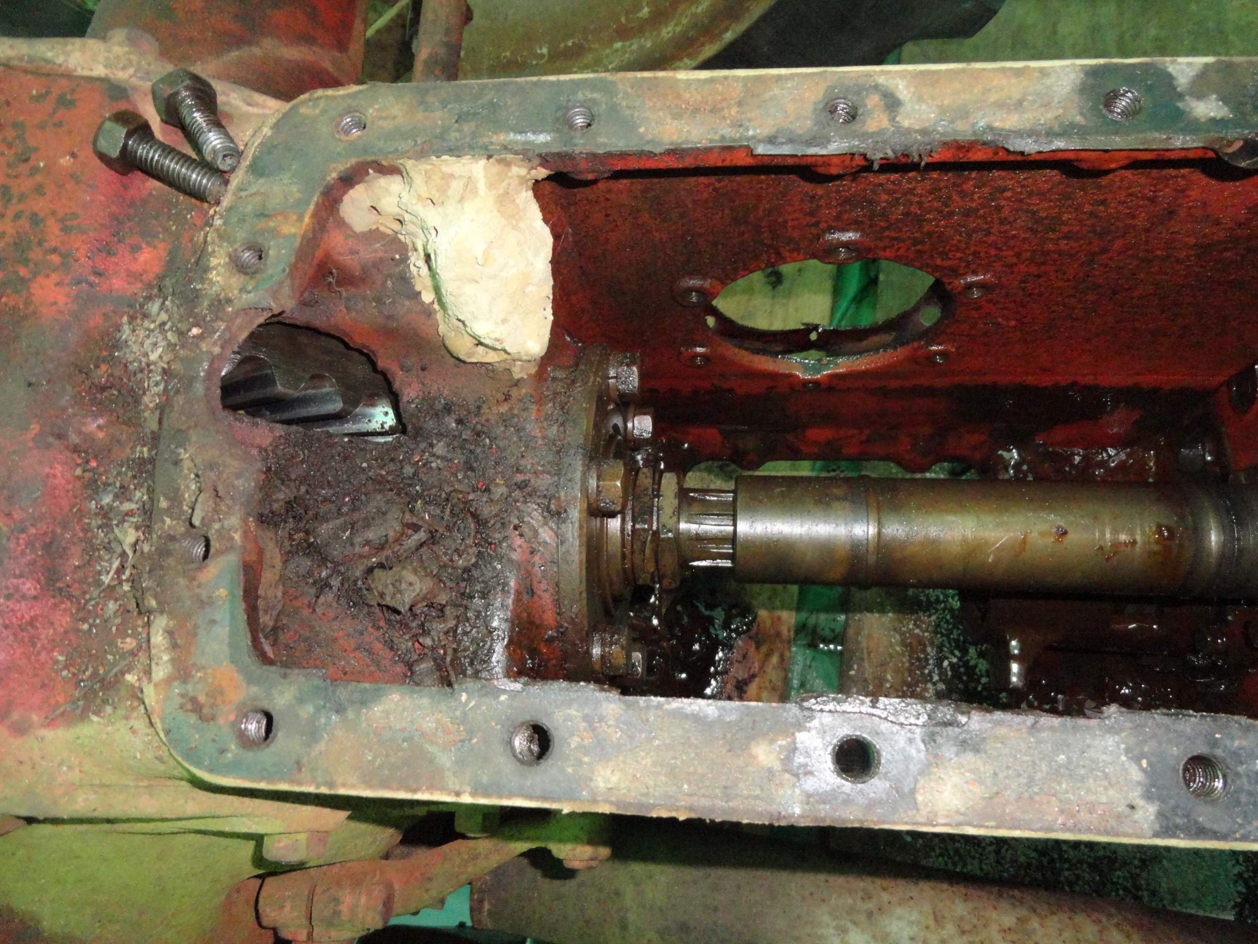

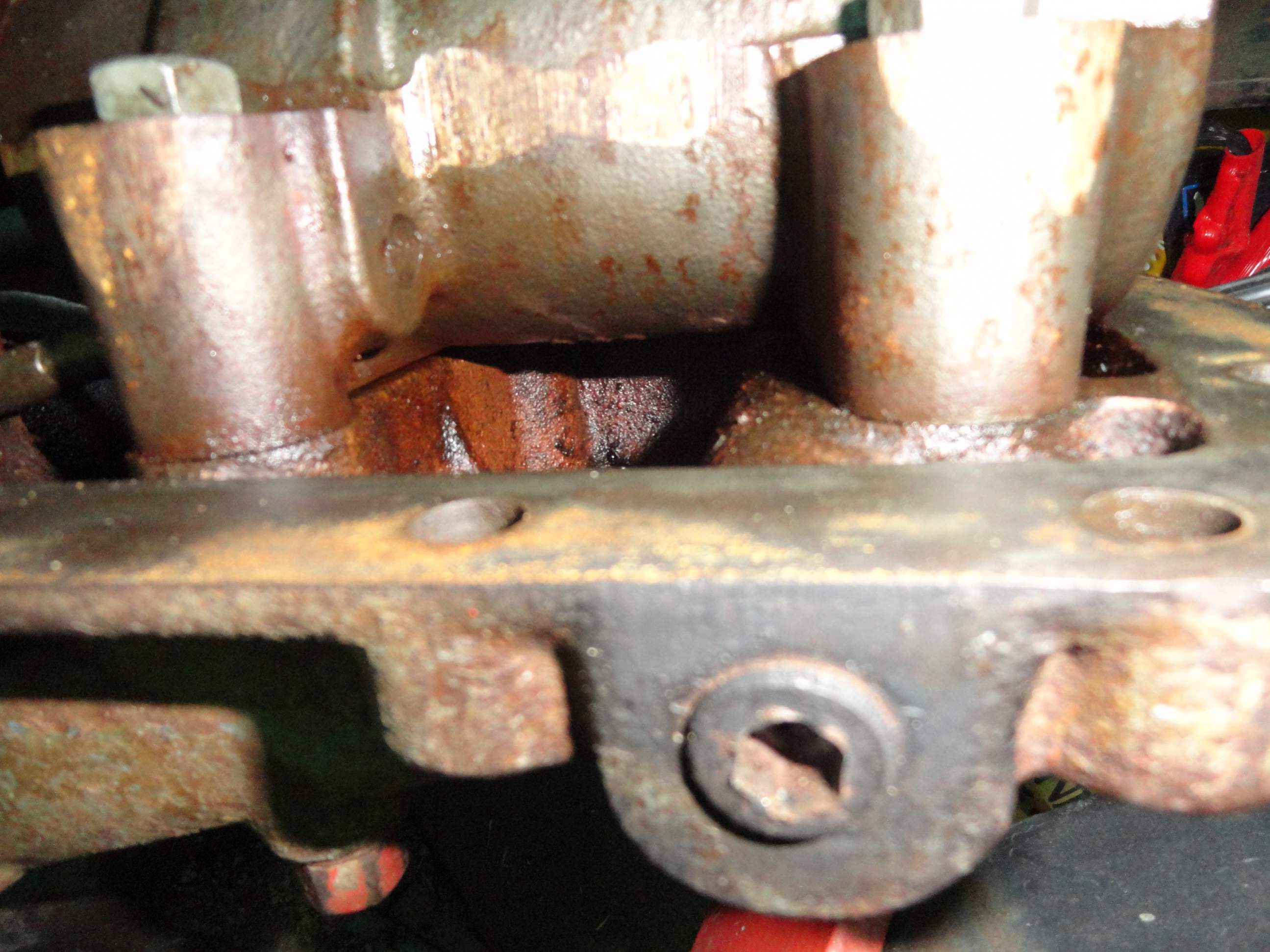

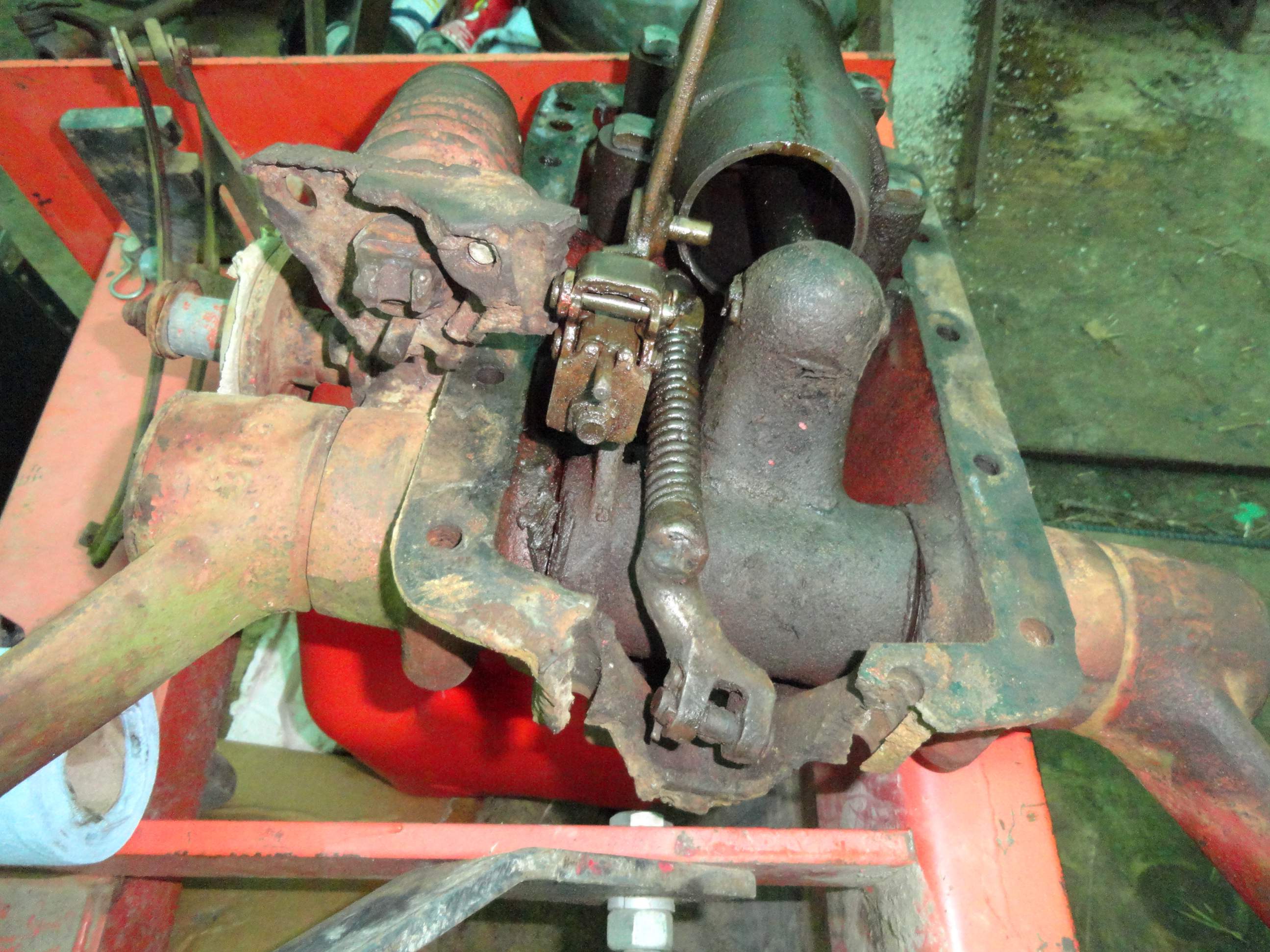

Photos of the 1951 8N lift cover and more... (It has the side distributor).
photo 1 shows the 8N lift cover damage.
photo 2 shows the wasp nest inside the housing.
photo 3 shows the 8N side distributor.
photo 4 shows a 9N lift cover side view with the external access via a hex plug by the stand pipe port.
Click the pix for a zoom view...
