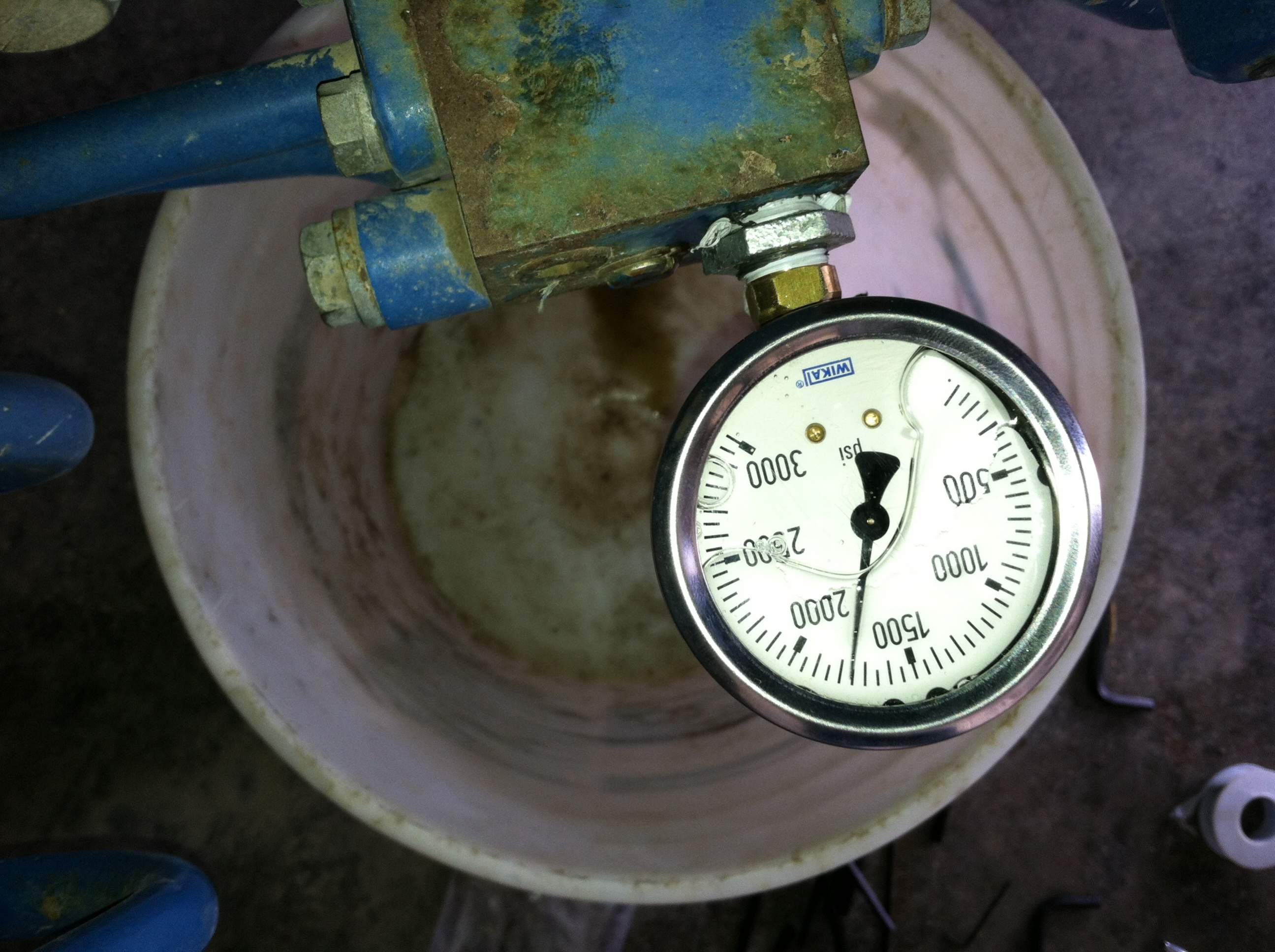

Well, pressure guage is showing about 1800 psi when raised up and lift lever is sitting in notched position... 3pt seems to be working better each time I mess with it(hesitation disappearing)...? I was just reading a section of my manual that stated to leave your 3t in the lower position during long periods of storage to prevent corrosion of the lift cylinder... Maybe I was having issues due to it being somewhat seized up? And as I use it more if remedies itself more so??? What do you think

Went ahold and changed Hydraulic fluid and filter... Pressure jumped to 2000 psi and raises and lowers with ease no more issues at this time! Yeehah!:cool2:
