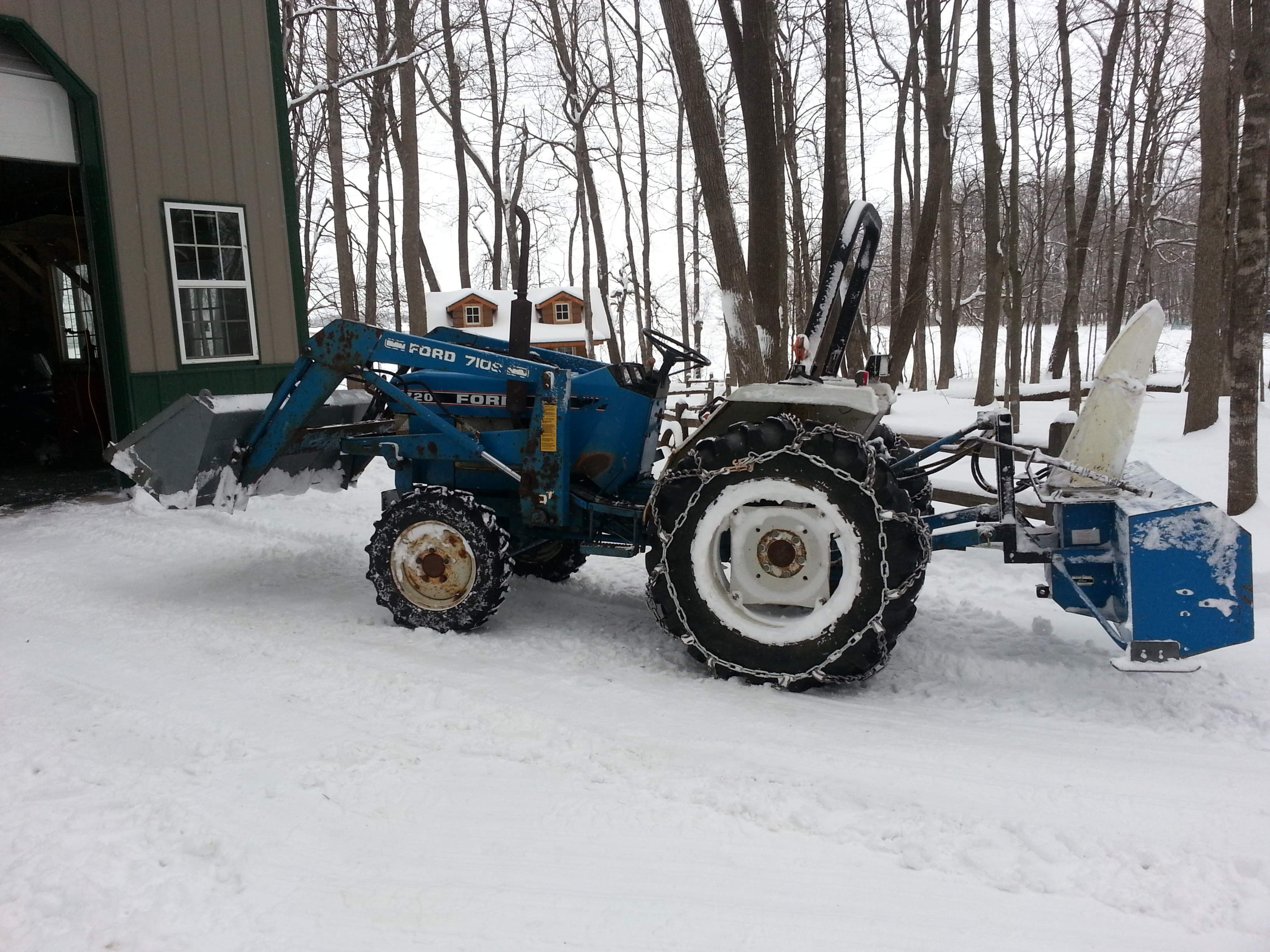

Apparently the quick coupler must have released but initially the hose did not pop out of the coupler fullu to notice it but just enough to close the ball check and block the line which caused my problems. When I wiggled the hose in the inlet port, it I must have pushed it far in enough to let oil past the ball check to where I noticed the leaking. (It had never leaked before in 3 years of ownership and I have never had it out of the coupler) Once I reconnected the hose in the quick coupler, I wiped it clean with a shop rag. After reconnecting, I had restored full power to everything. Again why it released just now to cause my problem is a mystery but like I said, last fall I was doing quite a bit of brush clean up and a stick must have bumped it loose. Otherwise I can't explain why it would be loose.
I am just thrilled that is all it was! :thumbsup: Thanks for ALL your help JC, you taught me quite a bit on how to troubleshoot it again in the future.

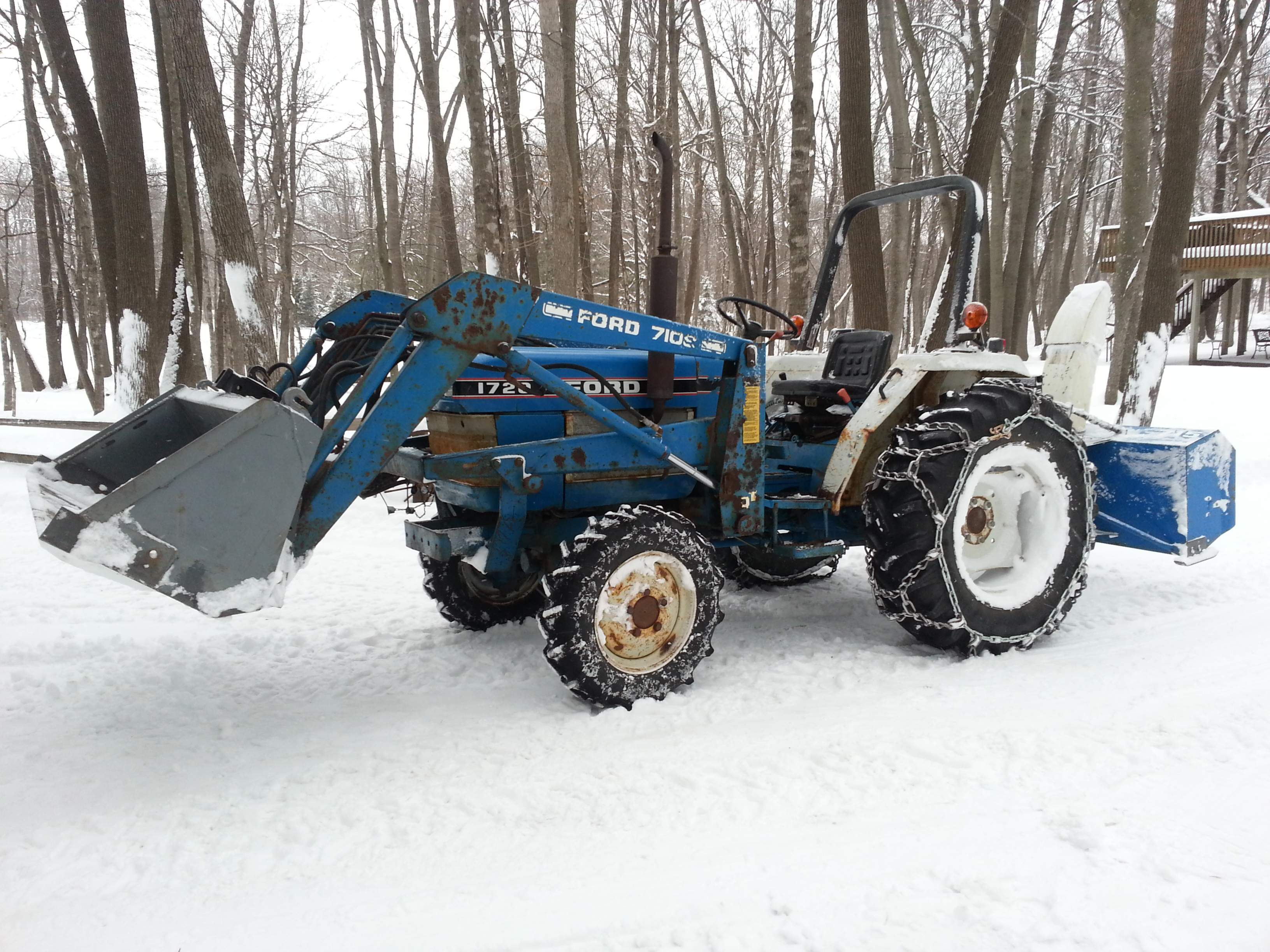

I am just updating my post. I live in Minnesota and we just got a foot of snow last night. I took the tractor out and spent most of the day blowing snow. I am glad to report that all the hydraulics worked flawlessly. I had no problems at all with the 3 point hitch, the rear remote for the hydraulic cylinder on the blower chute, and the front loader. I did add a hydraulic flow restrictor to the hose that controls the hydraulic chute rotation and it worked great! I was able to control the chute much smoother and I could fully operate the remote lever without trying to feather the controls. I used the cheap $5.00 pin-hole style restrictor and it worked great. Thanks to all that helped me and gave suggestions and feedback to this post. That is what makes these websites so valuable. I have added a couple photos to finalize my post. Thanks again! 20130305_172324 (1).jpg 20130305_172312.jpg
