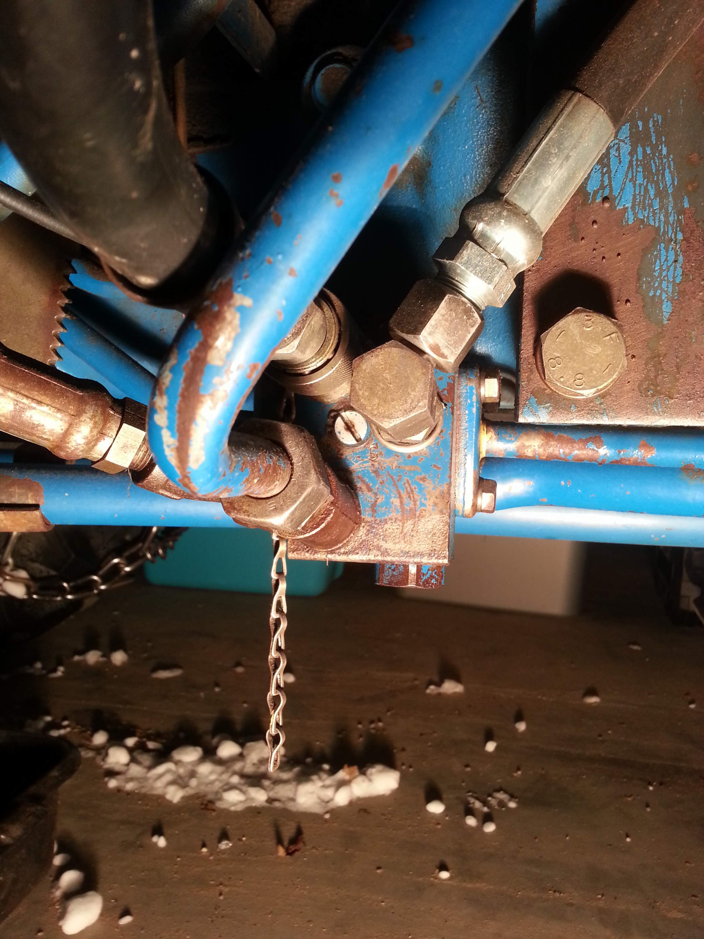

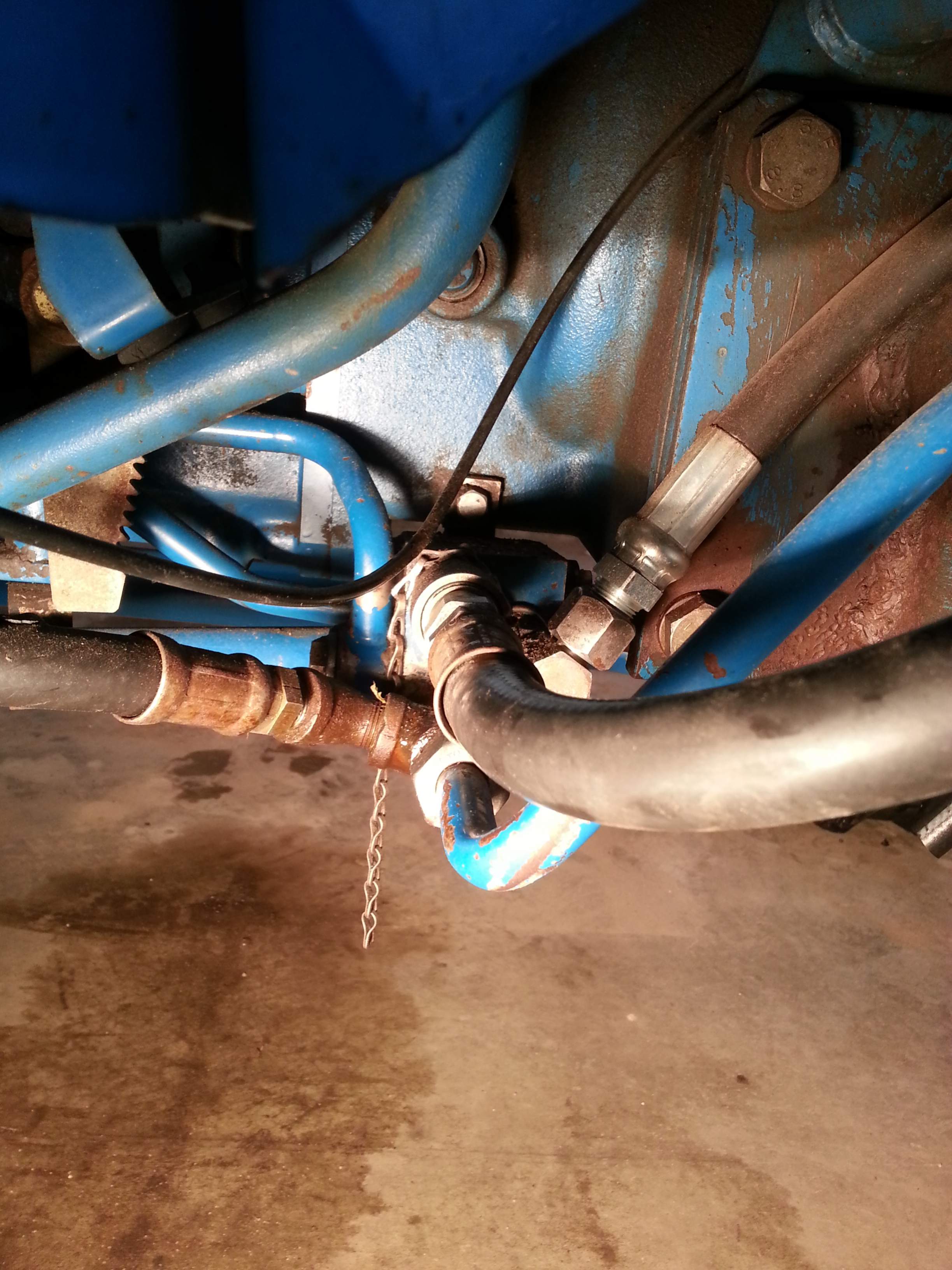

I started looking closer at it and then wiggled my hose from the loader spool going into the inlet port on the diverter block. Diverter Block showing Inlet Hose Coupling.jpg It had a little play at the coupler and seemed a little loose. I tried raising the loader again and this time, hydraulic oil started seeping out of the quick coupler on the hose going into the inlet port. Not good I thought but maybe I getting somewhere I thought. I wiped the coupler clean and wiggled the hose again and in the process I realized the hose was not fully engaged into the coupler. I pulled lightly on it and it came right out. So by this time I am thinking...."could I really be this blessed??? Is this it?" I checked the coupler and found the O-ring to be intact. I quickly cleaned it up and reconnected the hose into the coupler. Gave it a light tug and it held just fine - the coupler is holding as it should. I set the control screw on the diverter block back to the original setting and fired up the tractor and AHA.... everything works again just as it should. The loader worked fine, plenty of pressure to lift the front off the ground with the bucket, and three point had plenty of lift for the blower and it held it up with no settling, and the rear remote operated the chute and as it should. Also, the hydraulic pump did NOT heat up at all. YEEHAW!
What is odd is how the coupler came lose enough to release but did not leak until I wiggled it. I park in the shed with a cement floor so I would have noticed any puddles. Last fall I was clearing some brush in our woods and I guess it is possible a stick or something could have bump the coupler enough to partially release it. The hose going into the intlet port is very stiff so in theory, it could have stayed in put until it got to a point where it finally popped out. Stranger things have happened. All I know is that it is working well now and I did go back out Sunday afternoon and blew snow again for a half hour and all worked just fine. I have attached four photos in this post for those who are interested. The first shows the diverter block with the control screw. The second shows the diverter block with a better view of the inlet hose (black hose on upper left) coming from the loader spool. The last two show the instruction from the owners manual describing the control screw settings on the diverter block. Operating Hydraulic Manifold Block.jpg Operation Instructions.jpg
