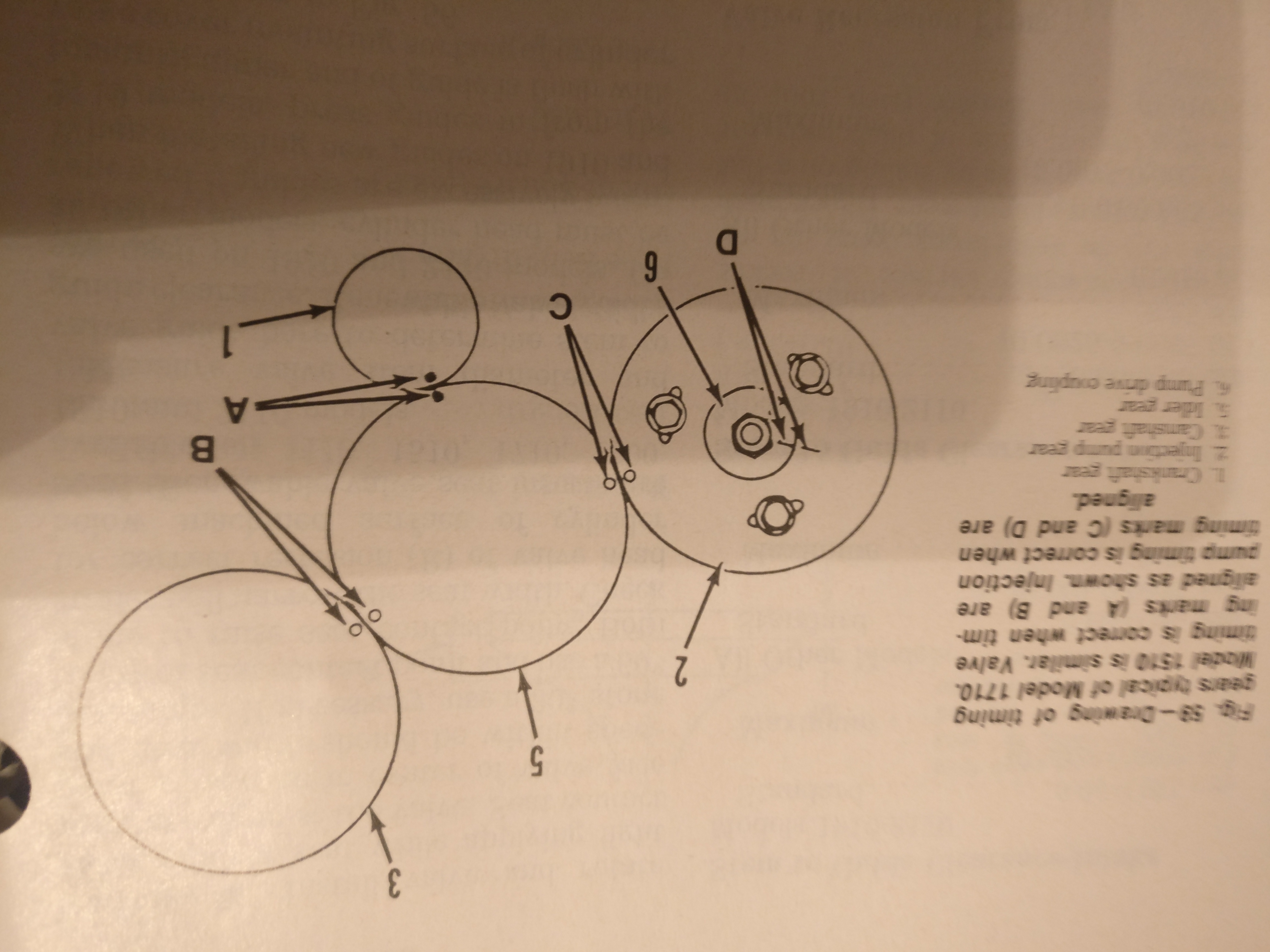

The other thing it could possibly be is bad timing. If the injectors are not firing near TDC it could be working against your starter.
Turning over speed looked okay to me, I don't know an easy way to check the timing on the 1710 however.

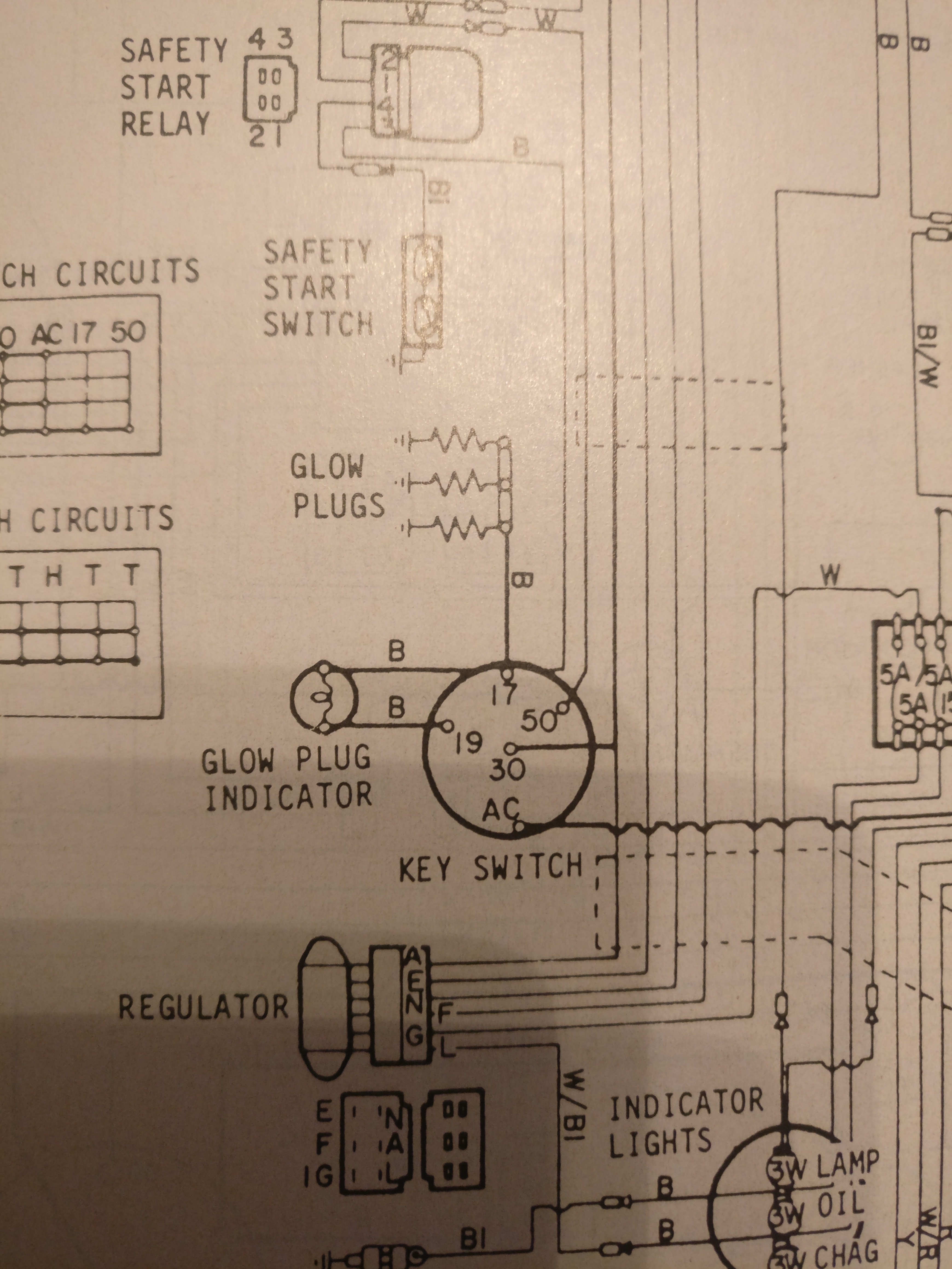

I am not convinced your glow plugs are working even though new. Sometimes people make changes and don't understand that some GP's are wired in series and some in parallel.
Your GP indicator never seems to glow red hot.
Lets wait until your WSM arrives re GP wiring. I repeat don't go applying 12 volts to a glow plug!!!!
Looking at the side photo of your engine which shows the GP's, there is a heavy black wire connected to the GP's at the cylinder closest to the radiator.
Where does that wire go or come from.

Here's the wiring diagram from the 15xx/17xx/19xx service manual I have if that helps:
Let me see if I can dig up the timing section and will upload that as well if GP look okay.
   / Ford 1710 will crank but not start #16
Here's the section on timing + diagrams. There's a part on the previous page about getting to the gears, if you need that as well let me know.

Am I seeing teflon tape on the new GP's?..
According to the posted wiring diagram you have parallel wired GP's which depend upon a good ground with the block to heat up.
The teflon may be blocking the necessary ground for the GP's
The GP indicator is wired in series with the GP's so no current going to ground through the GP's means not curreent to heat up the indicator.
Power in the switch flows from terminal 30, to 19 in the heat position and then to the GP's through 17.
Just having voltage at the GP's means nothing is there is no ground.

My manual came in this morning! Those diagrams appear identical. Thank you very much for taking the time to upload those diagrams!
I am comparing the diagram to the tractor wiring right now. If I can get the indicator to glow I will let you know. I can feel heat on it when I hover my hand over the indicator.
