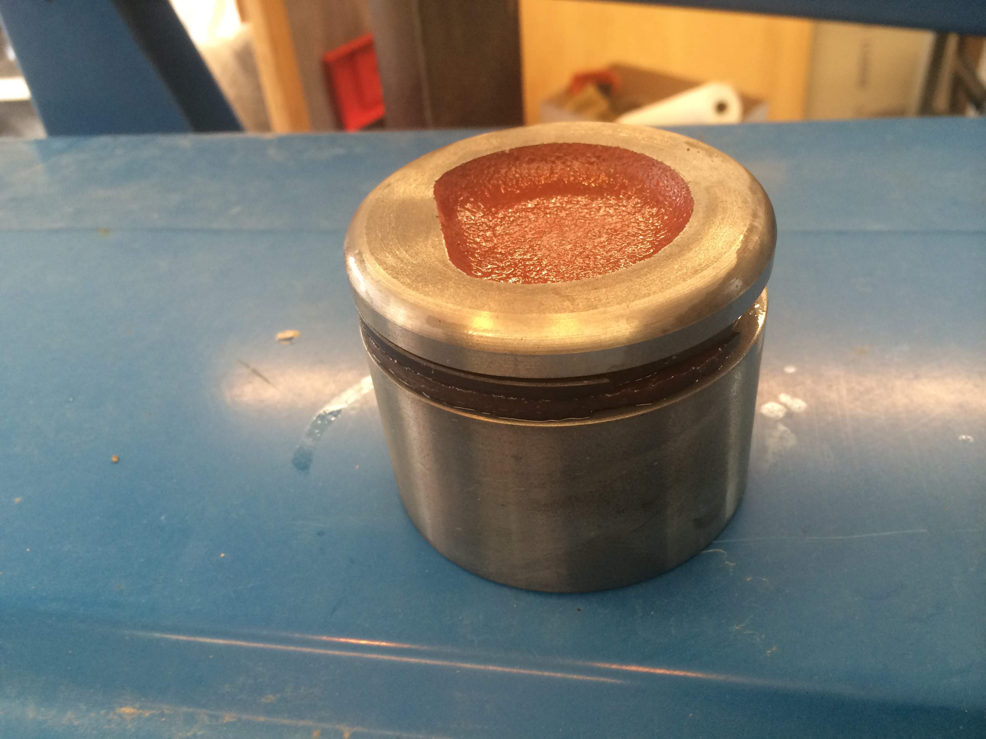

I took the piston out and discovered the crumbling piston seal. I replaced it at the NH dealer. Placed it back in and nothing is happening. I have turned the dial in both directions for fast and slow loading. Made a 60 mile trip today to get the seal, kind of disappointed but not giving up yet...BTW this tractor has power steering (works great) FEL (works great). I rechecked the old thread mentioned, to make sure the dealer installed the piston seal correctly (uchannel faces up towards piston head so it can flare out under pressure. I did start tractor again because I was so disappointed. I removed nut (where I saw on the previous thread where the pressure gauge is connected to) little to no oil coming out, had a little air pressure release when I unscrewed it. I also remove the nut opposite with locking nut attached. I started tractor and no fluid? I have re-read the thread a few times, but am ponder what to do next? Do I need to bleed the system to get the pressure back to the rear tph cylinder

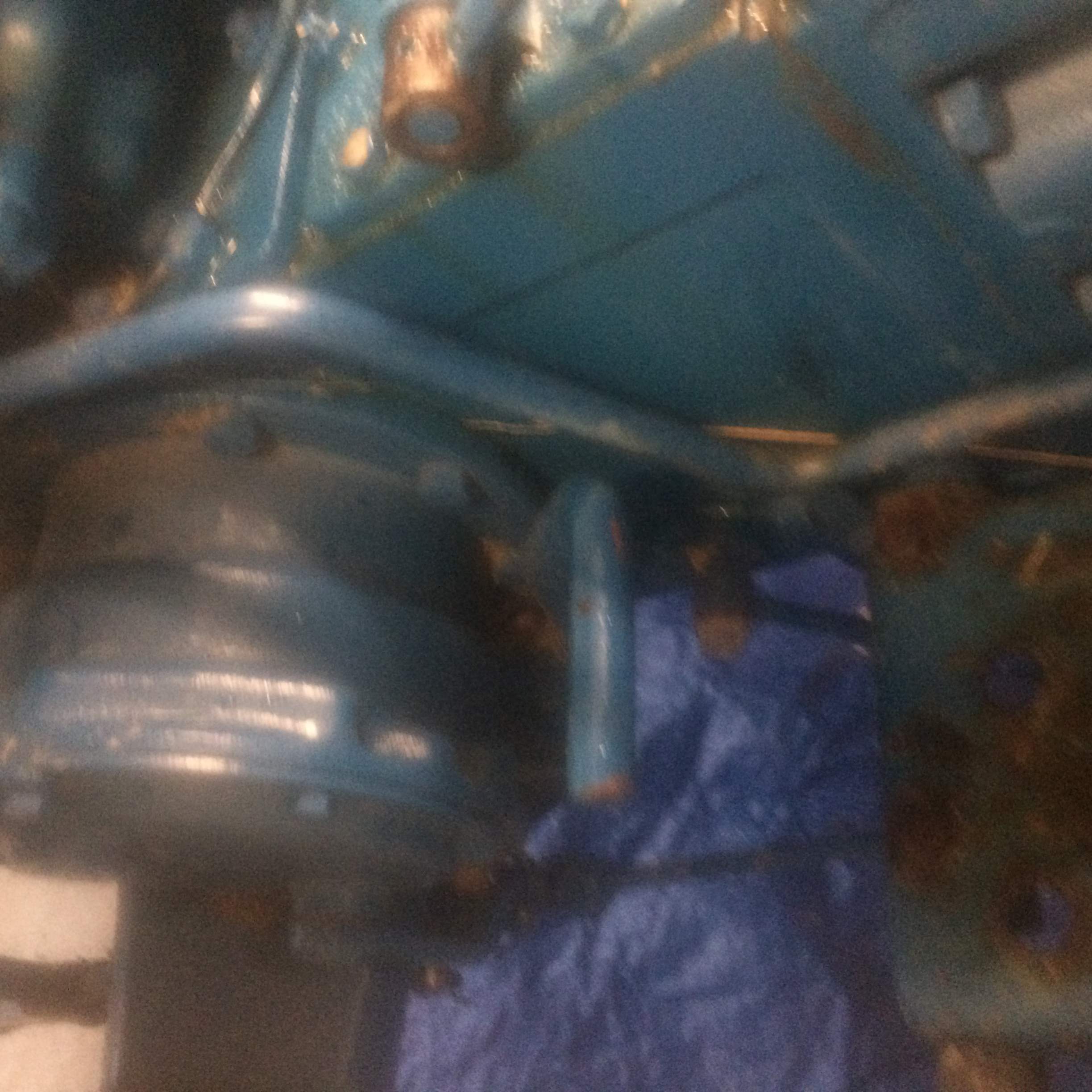

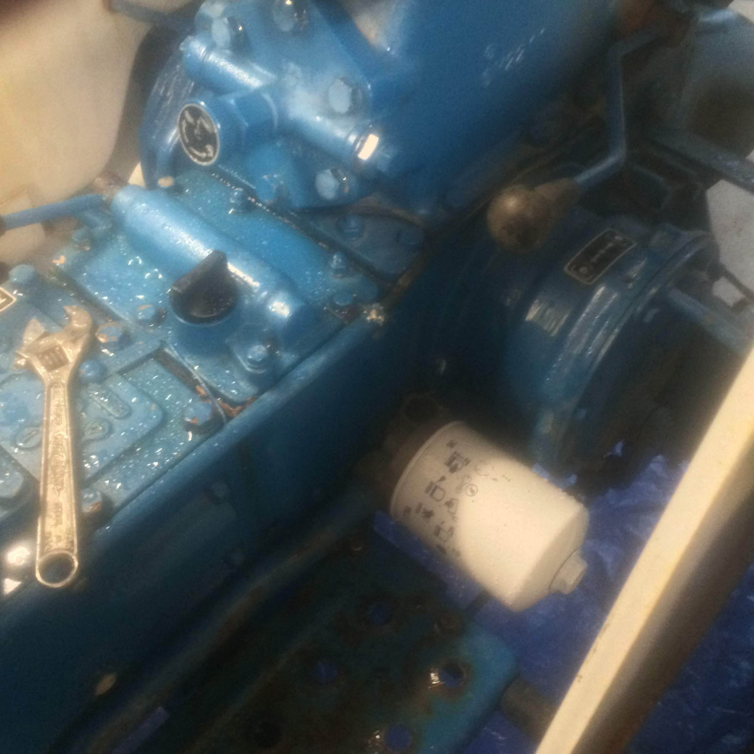

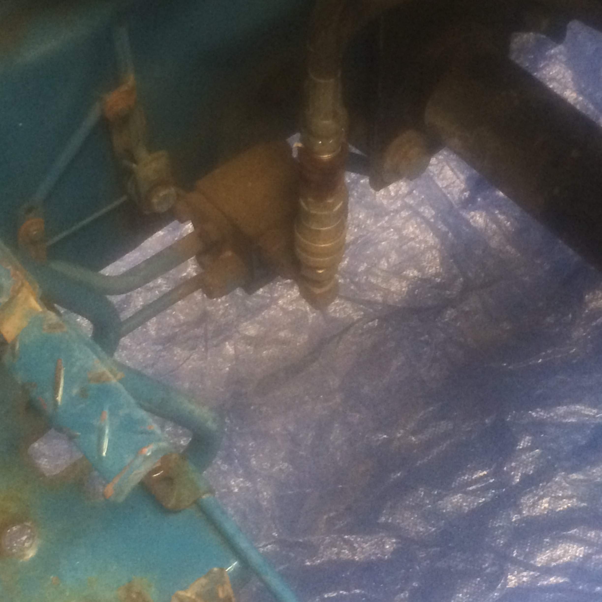

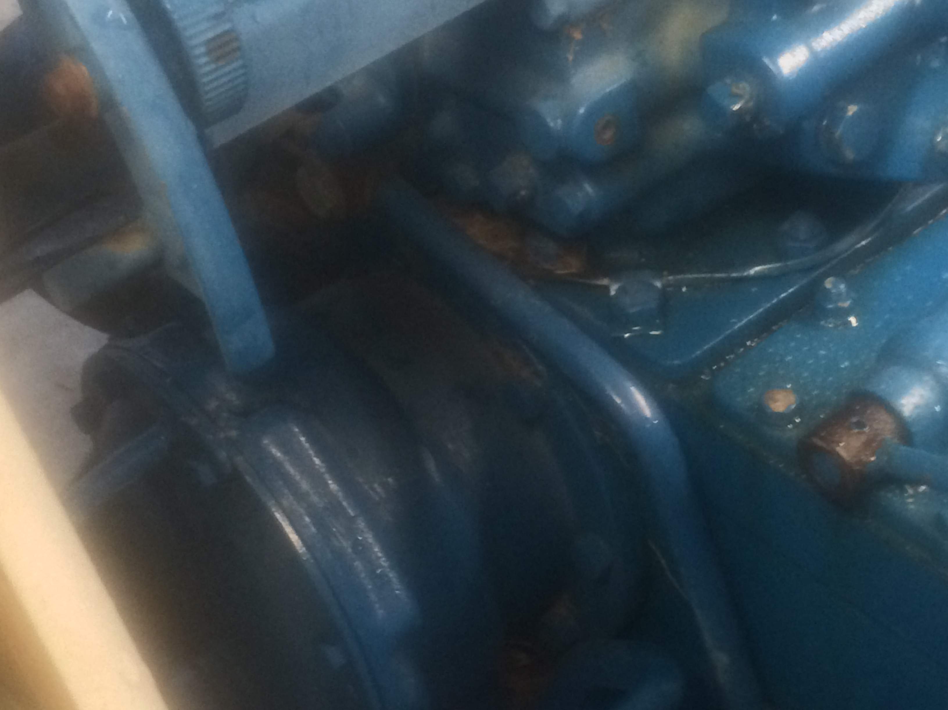

My filter is located on the left side foot plate (Napa 1736) I just changed it out yesterday. I have no idea where the pressure relief pipe is. If you could describe Or I can take a few pictures if that helps?

I'd follow the smaller dia pipe from the pump to the hyd block or relief device. Need to see where you can loosen the pipe without causing damage. You want a pipe that is open on the discharge of the pump and may be use a hose and a clamp to direct the flow safely in to a bucket. Pump will have some flow but not the normal pressure as gear type pump can build pressure against the relief pressure spring setting. It is raining in KC now and is getting dark so probably needs to be checked tomorrow.

Does your tractor have a hydraulic suction screen? It would be under a round cover on the side of the trans. It has three bolts and a tube that comes out of it.
/ Ford 1710 three point will not raise
#9
Hi Sixdogs,
Not to my knowledge. It has a hydraulic filter ot the left side. My first thought was a sump filter but I do not beleive so.

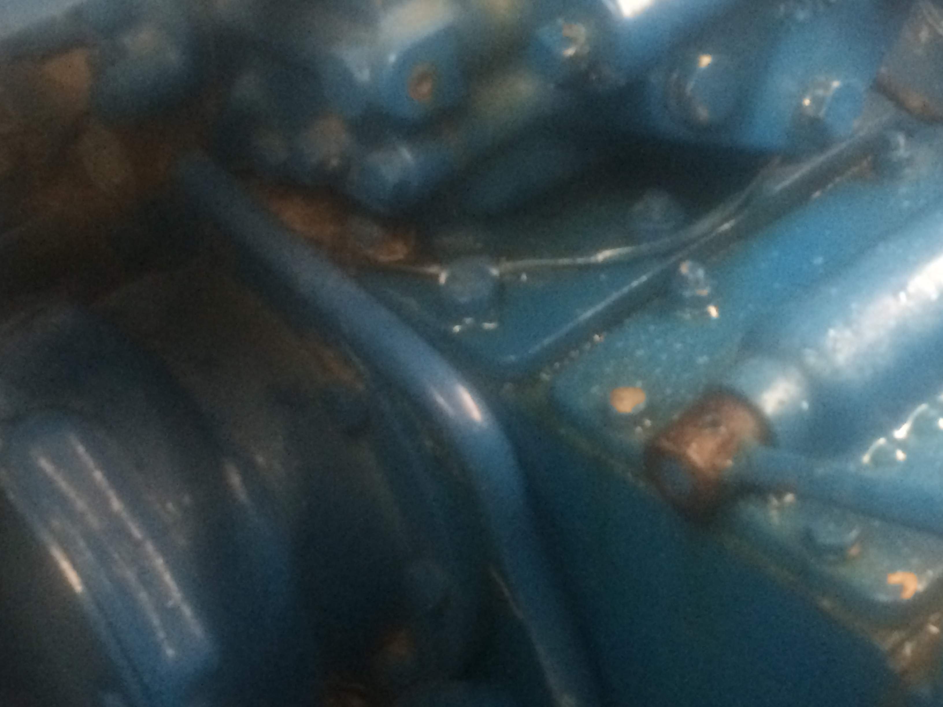

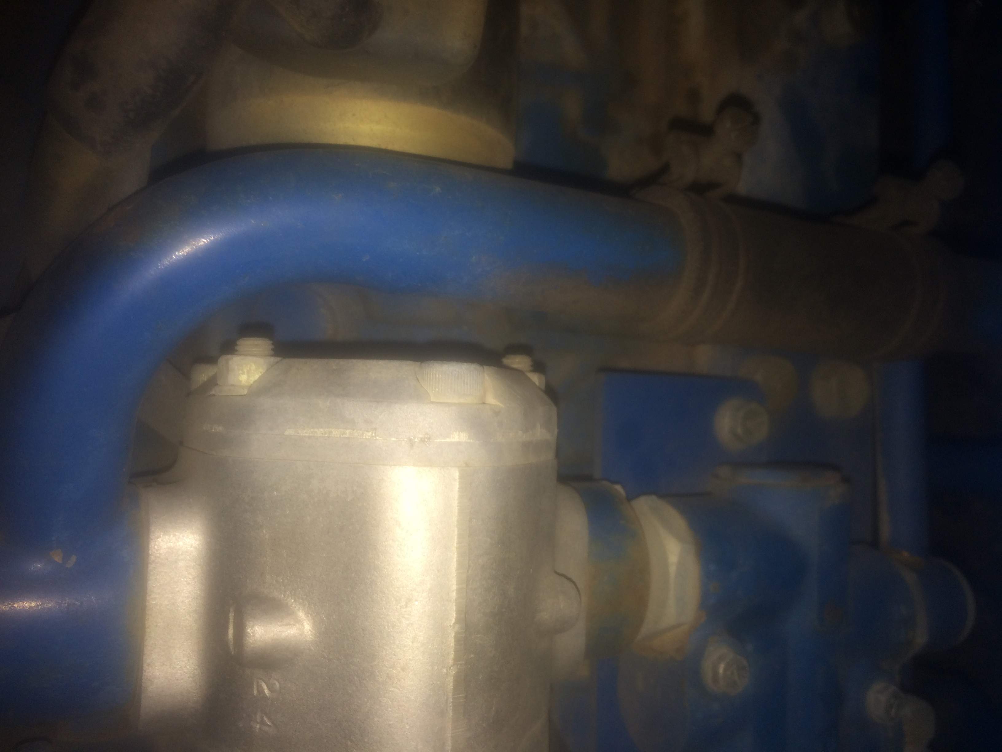

ford8.jpg.
More pictures
#11
Got curious when I read another thread about sump filters. I am posting another picture because I am curious if this is an inline screen filter inside the rubber hose? Thihs line also goes into the hydo filter on the left side of the tractor. I imagine this is the suction side since there is a rubber hose between the two steel lines?

If the loader and PS are working the pump is good. You could still have some air trapped in the system. Do you have a valve by the foot rest that diverts the fluid to the loader or the TPH. If you do this valve has an adjustment so that you can increase the flow to the TPH or the loader. When was the last time you used the TPH.

I was reading on another thread when someone mentioned a screen filter? This line goes from what I believe is the suction side of the pump from the hydo filter. Just curious if anyone knows if there is a filter screen inside the rubber hose? BTW, the picture is sideways needs rotated so rubber hose is actuall vertical to the piping.

I will post a picture of the diverter block. I was thinking the same thing, but since this is a pdp pump, I find it hard to understand how air would be trapped. As a side note, I went out about an hour ago to check the rear hydro vent. I raised the cap and heard a slight hiss of air. hmm very slight air release, so perhaps there is air in the system? I am trying to address all the simple stuff first.
I just posted another photo of a rubber hose attached going to the pump wondering if I missed cleaning or replacing another filter?
If the adjustment is there on the diverter block I will try it since I don't beleive I can hurt anything? I also saw on the bottom of the diverter a plug on the bottom, so I may take that off and see if the diverter has a screen or is clogged?
