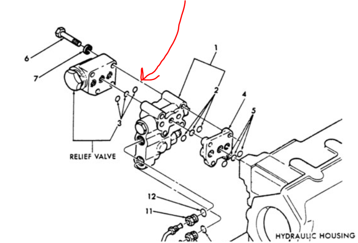

Interesting...that makes sense, I've just never seen it before. The power beyond block I make for the draft control models should fit between the priority valve and relief valve.

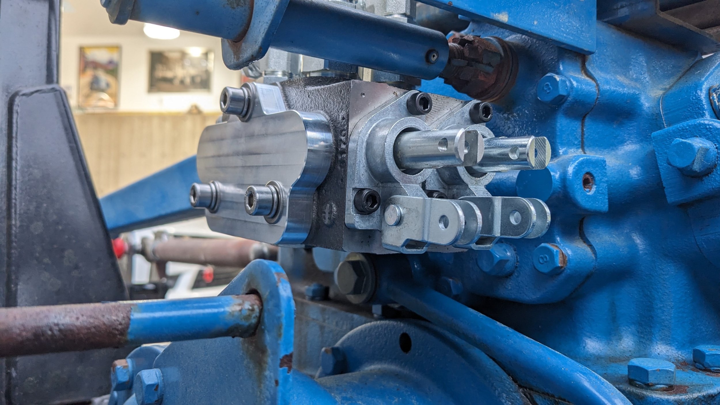

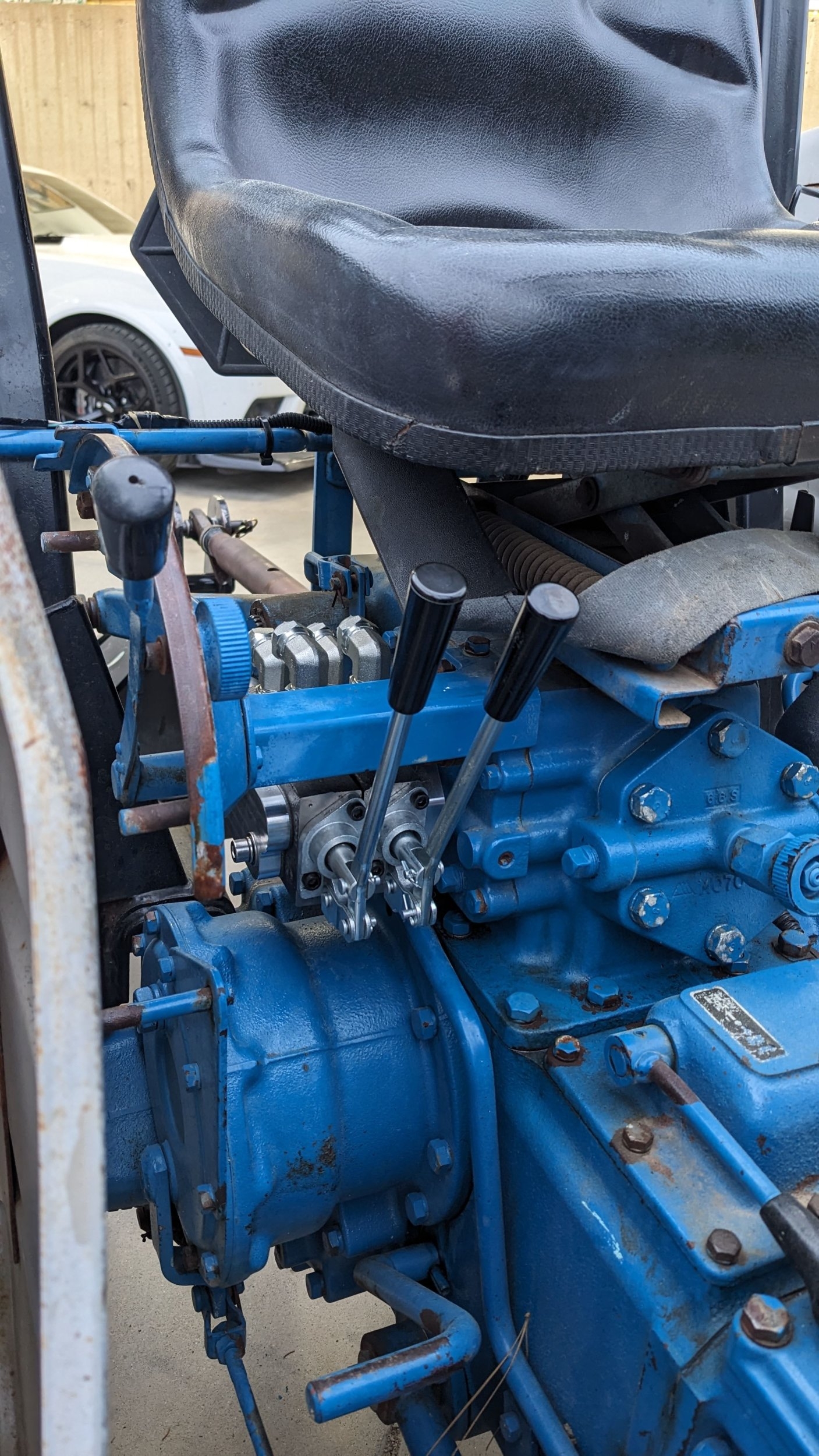

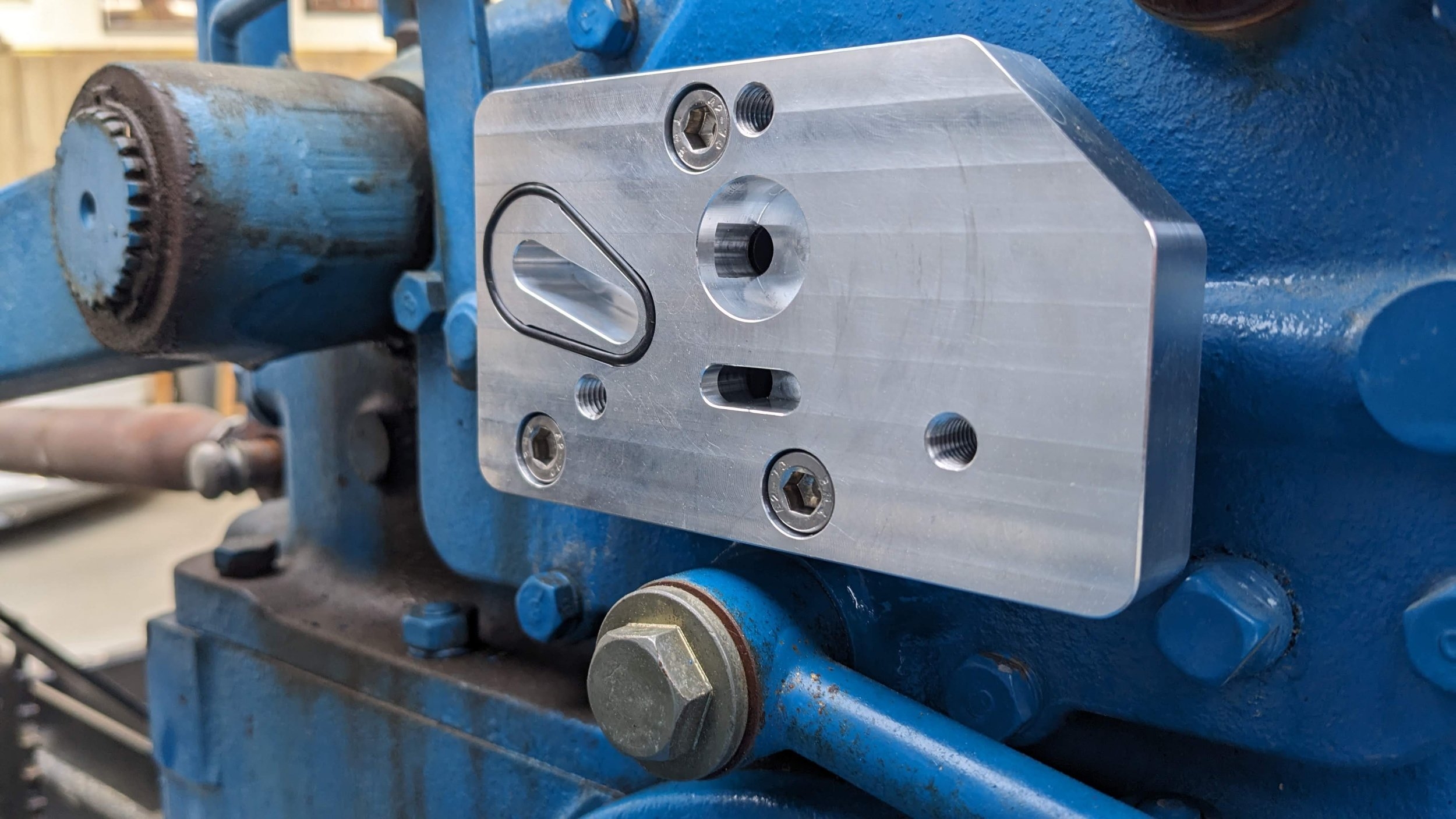

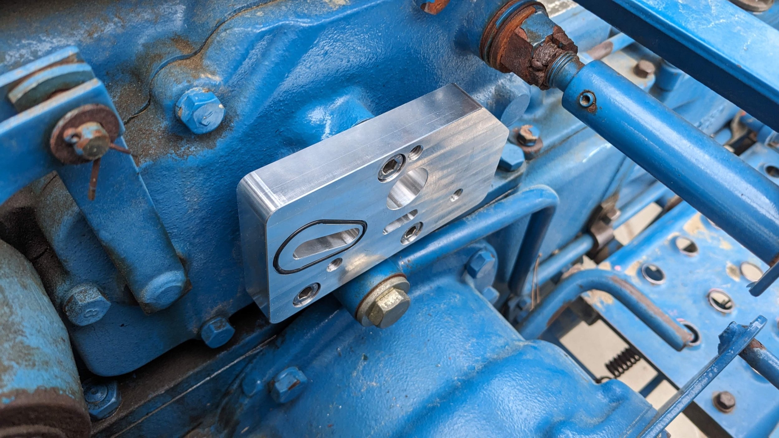

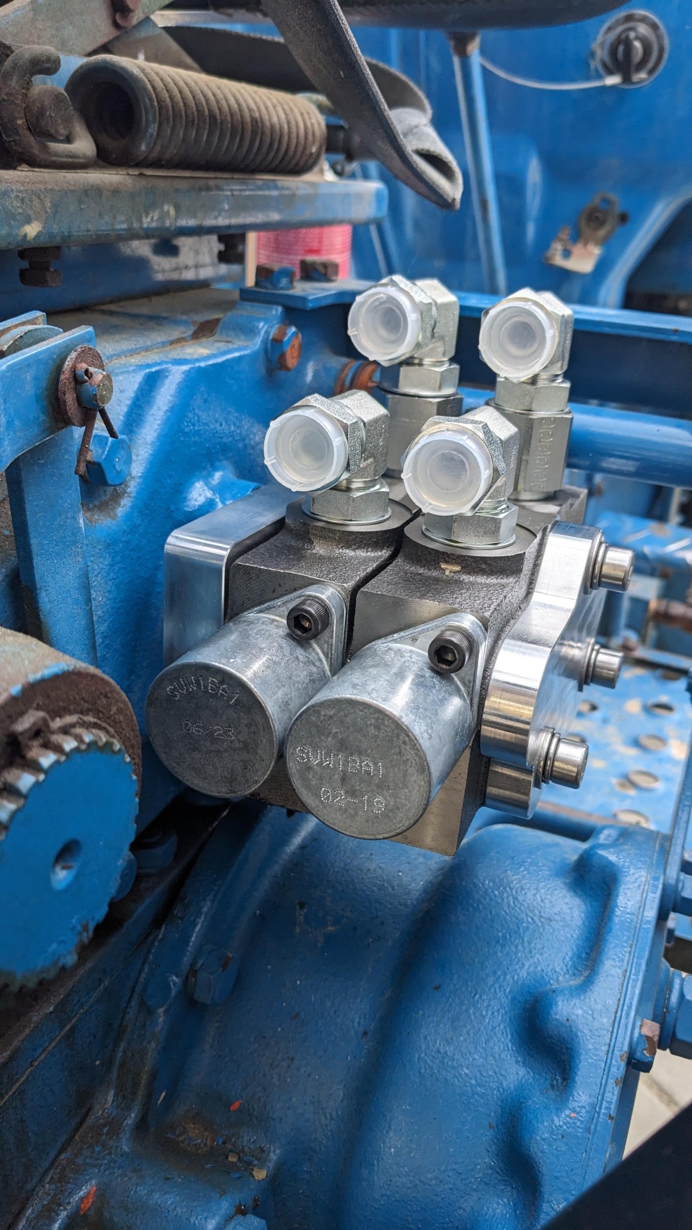

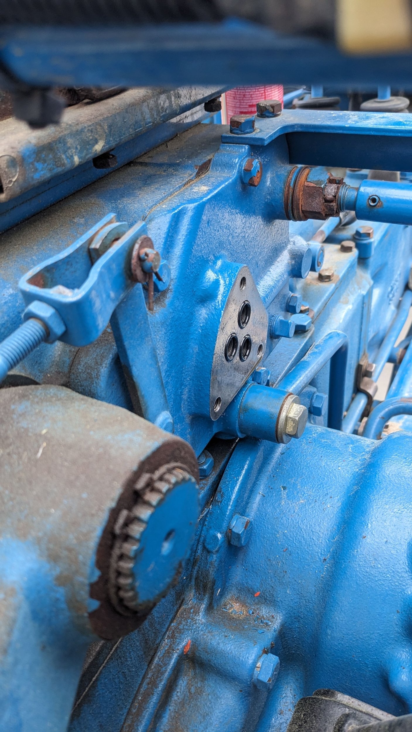

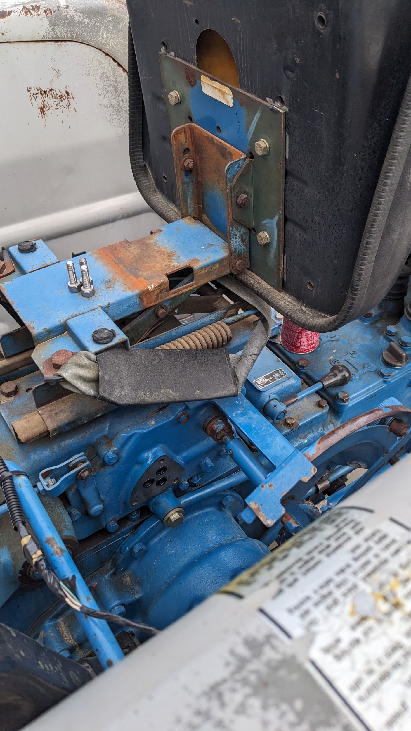

A few pics of my new RearRemote setup from Ted, who was awesome and speedy to work with. I don't yet have a top/tilt kit, but I'm working on it.
Here's what I ordered and installed:
Small cap is removed from under seat location to reveal pre-plumbed hydraulics location. The o-rings were supplied in Teds kit and fit nicely.
Next to be added was the mounting plate which the valves will in turn mount to. All hardware and o-rings are supplied in the kit, which was shipped speedily and well boxed.
Each valve unit is an individual part of the sandwich, with a cover plate on the end. I pre-assembled the sandwich before attaching the whole thing to the mounting plate. Not shown are o-rings between each plate, again supplied with the kit.
Final view after adding the supplied levers. Note that one lever is ever-so-slightly more bent than the other - this allows your seat to be fully raised without impacting the levers. A nice touch and a great product. Thanks Ted!
