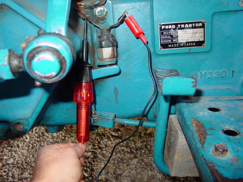

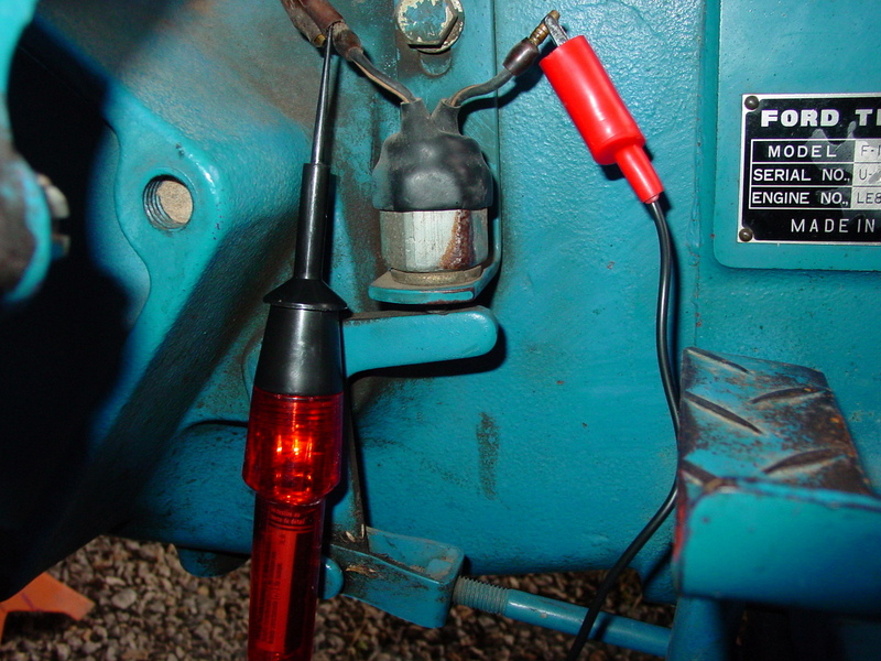

Attached you can find the clutch safety switch and how it is operated by depressing the clutch pedal. It is a simple N.O. Normally Open switch and once is pressed it closes the circuit to starter solenoid. You can do a test like I did in the pic or you can take both leads off and do a continuity check.with Ohm meter. It should be open (infinite resistance) or closed (zero resistance) once pressed. just to check the circuit just simply jump the leads and you should be able to start. If the circuit is open then when you preheat the light will not come on. I don't recommend it just jumping it t get around replacing the switch. I wondered if just some brush pulled one of the leads off.

@JC-jetro Am I right in thinking that this is on the outside of the tractor just in front of the clutch pedal? IE: I should be able to see this without taking anything else off?
If so, it is definitely not there on my tractor.

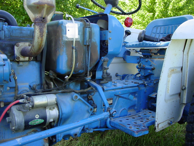

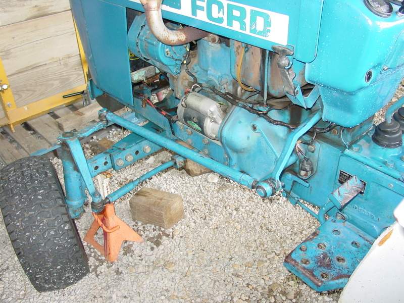

Yes , It is on the left side of the tractor from the side you get on. I have couple of more pic for you to see. Can't miss it. step on the clutch and look at what clutch pedal does and what it activates. look at the geometry of the arm.

Yeah, that is definitely not there. In fact, I think the bracket that the safety switch is attached to is also missing. I may remember that there were wires hanging down there, so I am going to assume a previous owner bypassed it.

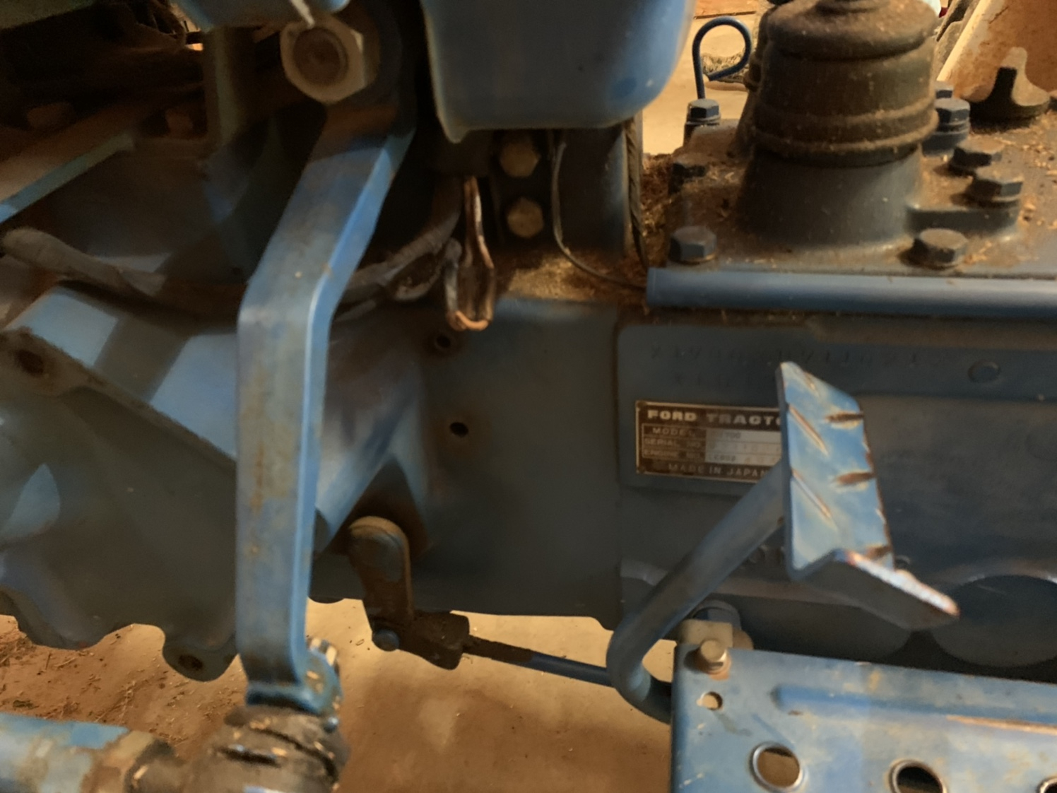

My clutch pedal looks like this as well and I am about to install a clutch safety switch. I am looking for a part number or what to get to install on clutch linkage to activate the safety switch.

I was more thinking through the arm that activates the push button when stepping on clutch, but I think I have a solution this AM. Messicks pointed me to a switch that is a Kubota and will work the same. Found the bracket on ebay.
I'm leaning toward adding to my current tear drop piece on the clutch adjustment arm to function like those with the extra shape to actuate the switch. Going to weld it onto the piece and fab it to be one unit.
