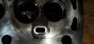

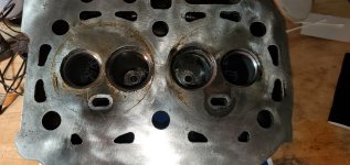

Good afternoon, had my head sent out to be welded due to cracks around the combustion chamber. looked real nice when I got it back . I installed it with the service manual so it should be right. Also added two new exhaust valves because the old ones were badly pitted. Had all valves reground. After install I got it started and let it warm up. put it in 1st gear and drove it out of the shed. Noticed it seemed to lack power, like it wanted to die, I let it idle for a bit longer and it seemed to get better. I raised the bucket and it seemed to want to lose power and die again. Anyone have any ideas what could cause this? It is cold out but but the engine is warm and i due have anti gel in the fuel. Things I had previous repaired on this tractor were rebuilt injector pump rebuilt injectors and new radiator. Tractor ran good before I had the head taken in but it was burning out glow plugs left and right from the anti freeze coming through cracks in the head.

Forgot to write that these are pics before they welded the head

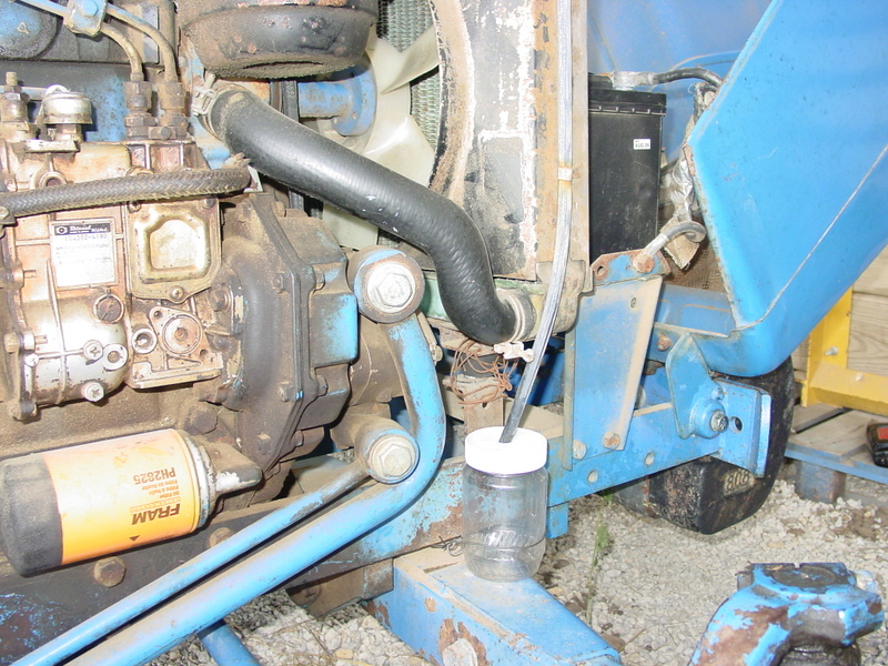

My Ford 1310 does also burp small amounts of coolant when the engine is worked hard, but has never overheated in the 23 years I have owned it.
I need to check the coolant level regularly & add a small amount maybe couple of times a year.
I wish there was an overflow bottle in it, but the space is very limited in-between the radiator & engine and have so far not figured where and how to mount one.
There must be some high quality small overflow tanks available.
Anyone know of good small overflow bottle solution / brand?

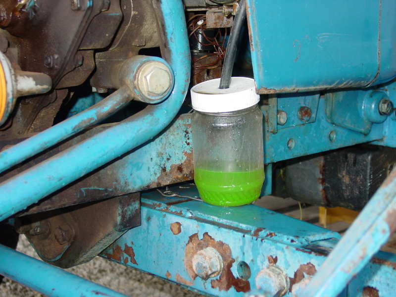

I told you guys , I specialize in "redneck solution" when necessary. Do you have a plastic jar of Peanut butter? clean a used plastic jar, drill a hole in he lid just slightly smaller that overflow rubber hose, shove the hose in the hole, extend it in the jar all the way to the bottom, fill 1/3 of the jar with coolant, and use my favorite thing" bailing wire" to attach it to the engine or frame frame. Please look at the pics below. Any overflow would be caught there when the radiator cap spring lift up to burp and when the engine is cold it sucks the same amount right back in the radiator.That is the original jatr from 10 years ago and I've got plenty of more jars where the original came from:D

3-Overflow is fine. Look at my comment above to arto98607

I told you guys , I specialize in "redneck solution" when necessary. Do you have a plastic jar of Peanut butter? clean a used plastic jar, drill a hole just slightly smaller that overflow rubber hose, shove the hose in the hole, extend it in the can all the way to the bottom, fill 1/3 of the jar with coolant, and use my favorite thing" bailing wire" to attache it to the engine, frame. Please look a the pic below. Any overflow would be caught there when the radiator cap spring lift up to burp and when the engine is cold it sucks the same amount right back in the radiator.That is the original can from 10 years ago and I've got plenty of more can where the original cam from:D

Thank you JC-jetro
I will take a closer look at that and have done a similar solution many years ago on my Grasshopper Diesel mower.

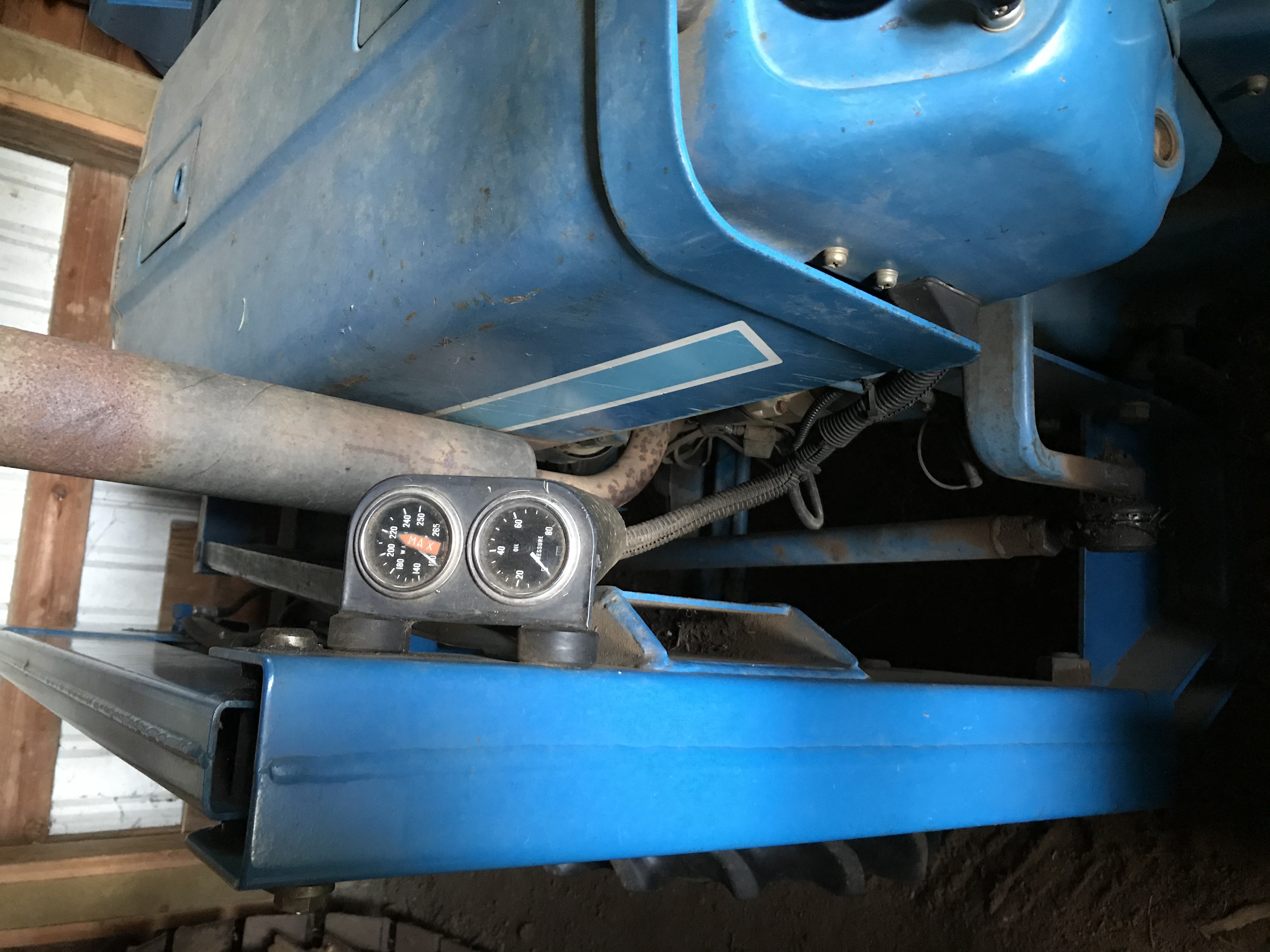

Below is shown my solution for oil pressure & temperature gauge mounting a long time ago.
Coolant burping starts at around 220 F, but this gauge location allows for easy monitoring (also when running a PTO chipper).
It's always an indication of clogged factory "bug screen" in front of the radiator.
