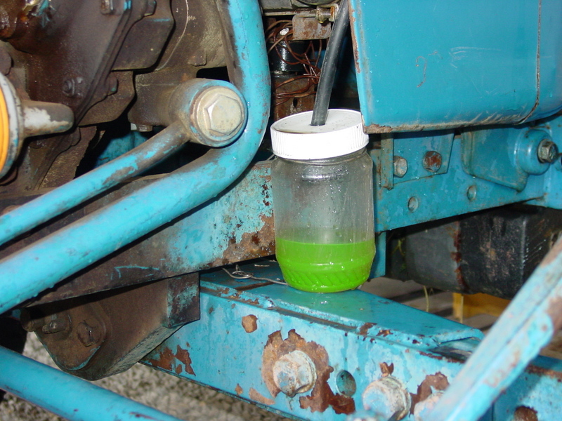

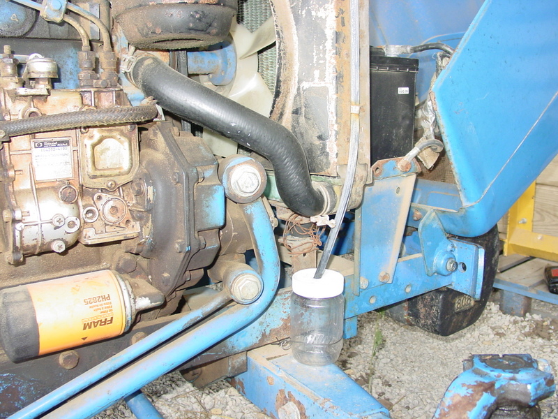

I told you guys , I specialize in "redneck solution" when necessary. Do you have a plastic jar of Peanut butter? clean a used plastic jar, drill a hole in he lid just slightly smaller that overflow rubber hose, shove the hose in the hole, extend it in the jar all the way to the bottom, fill 1/3 of the jar with coolant, and use my favorite thing" bailing wire" to attach it to the engine or frame frame. Please look at the pics below. Any overflow would be caught there when the radiator cap spring lift up to burp and when the engine is cold it sucks the same amount right back in the radiator.That is the original jatr from 10 years ago and I've got plenty of more jars where the original came from:D

I told you guys , I specialize in "redneck solution" when necessary. Do you have a plastic jar of Peanut butter? clean a used plastic jar, drill a hole just slightly smaller that overflow rubber hose, shove the hose in the hole, extend it in the can all the way to the bottom, fill 1/3 of the jar with coolant, and use my favorite thing" bailing wire" to attache it to the engine, frame. Please look a the pic below. Any overflow would be caught there when the radiator cap spring lift up to burp and when the engine is cold it sucks the same amount right back in the radiator.That is the original can from 10 years ago and I've got plenty of more can where the original cam from:D

I will take a closer look at that and have done a similar solution many years ago on my Grasshopper Diesel mower.

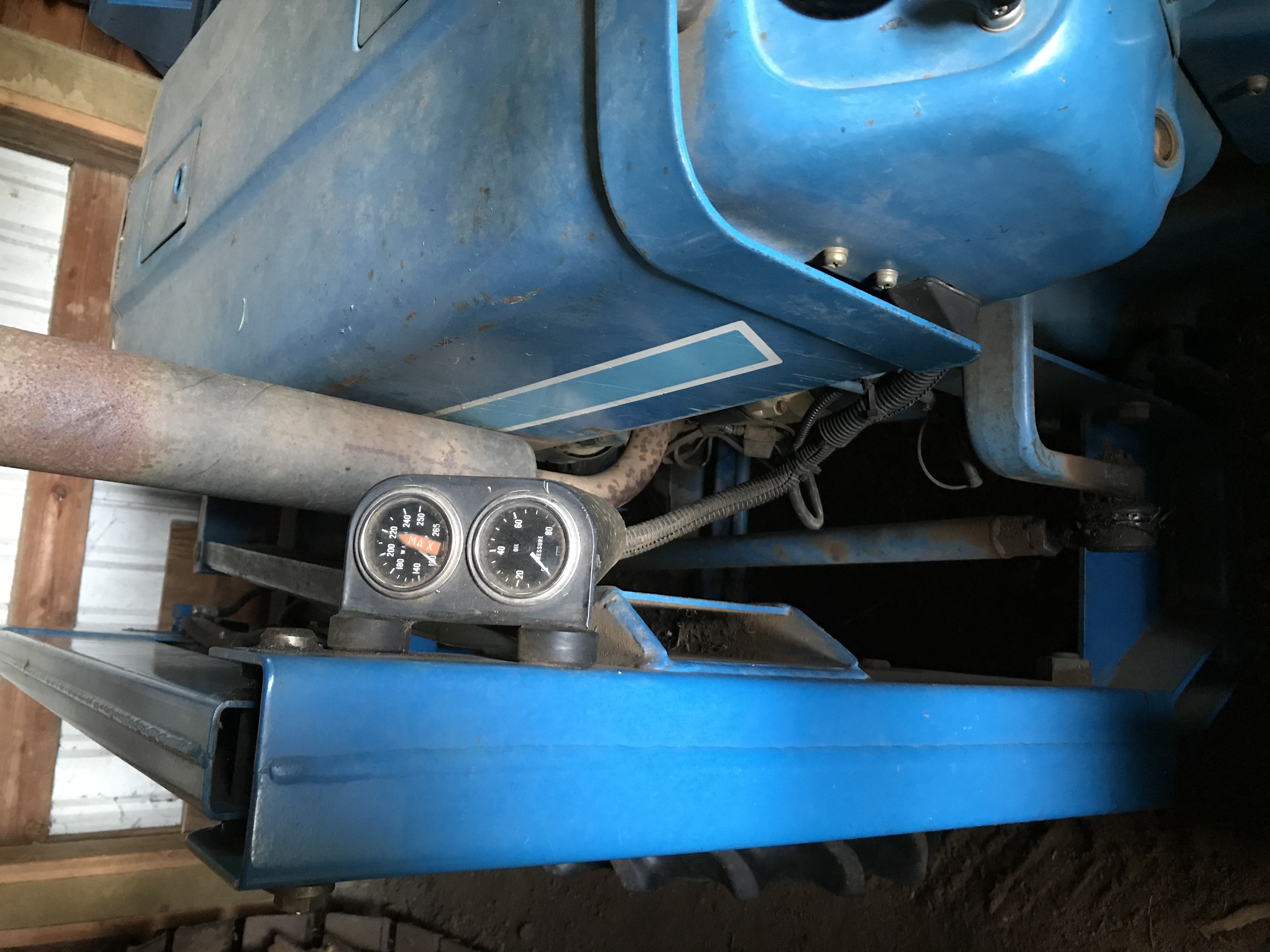

Below is shown my solution for oil pressure & temperature gauge mounting a long time ago.
Coolant burping starts at around 220 F, but this gauge location allows for easy monitoring (also when running a PTO chipper).
It's always an indication of clogged factory "bug screen" in front of the radiator.

I like you gauge set up. My OEM still works just fine , but you made a good mod. I don't have a loader though.

My 1310 dash is all original and did not have a temp or oil gauges only warning lights, and I did not want to change the dash!

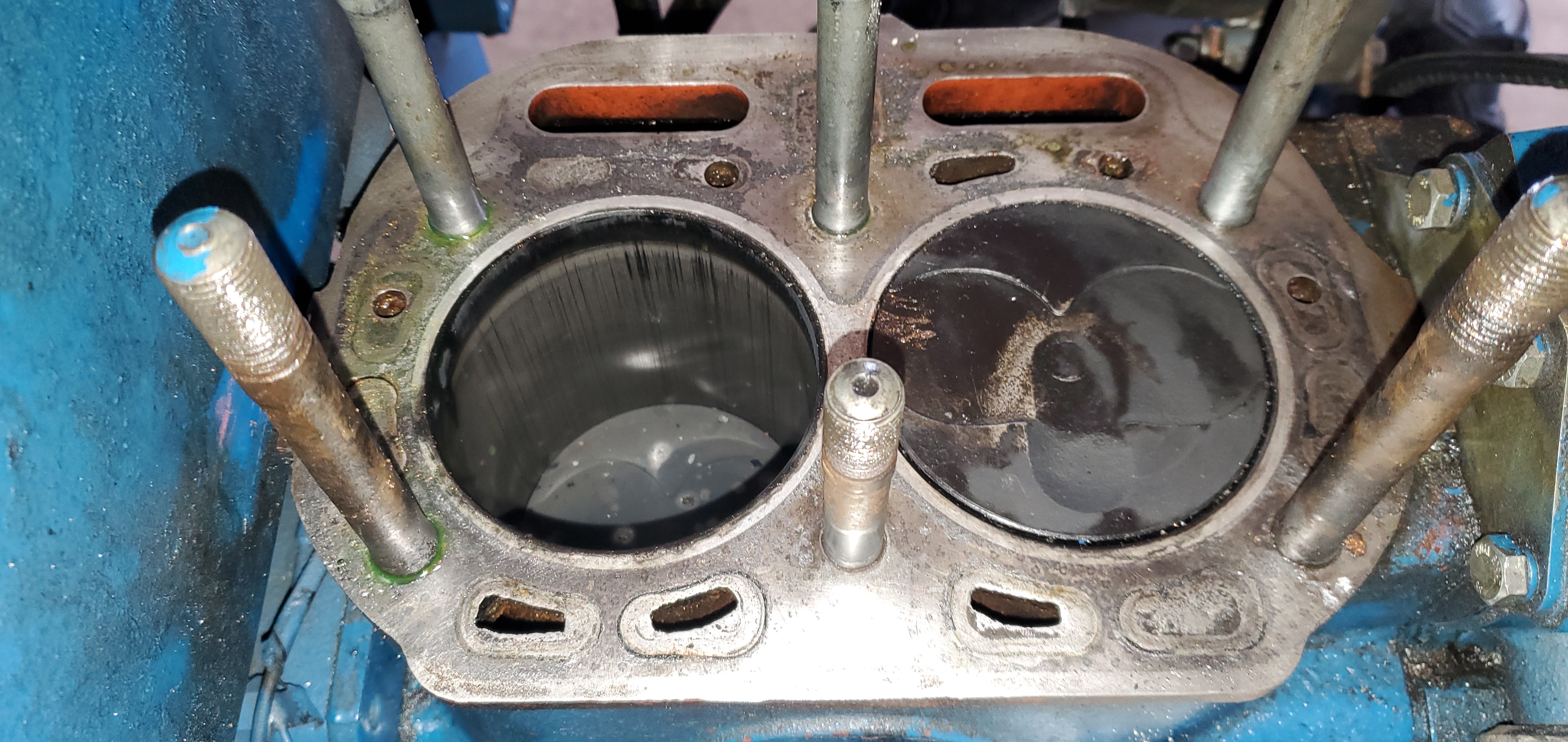

Good Sunday morning, well l did a leak down test yesterday afternoon, the results were at about 80psi air pressure, going threw the injector holes no leaks at the exhaust on both cylinders bad leaks at the air intake on both cylinders, l did double check the pistons were TDC. Also had air coming out of cylinder head 2 when testing cylinder 1. No air coming out of the dip stick hole or oil cap hole Thank God for that. I did have the valves re ground not sure why the intake is leaking like that on both Also the head gasket maybe bad. I bought it on line at Weavers compact tractor parts. I should of bought it right from a Ford/NewHolland dealer instead. Going to take the head off today and see. Will get some pics out when it's off

well, sorry to hear that but glad you found the culprit. There is no way to ignore that. Before you take the head off, did you try to re torque the head bolts in order to possibly eliminate the air leak out of cylinder #2?. Is there a possibility they grounded the valve too much or mixed and match exh/int valve from cylinders. The time I had do a valve job on my very old car I made a diagram of valve layout on card board and poked holes to match. I then ground the valves and made sure they are going exactly where they went originally. At least , you don't have to deal with ignition and injector timing doing it again. One last thing was the surface of head flat and true checking by a ruler? any warpage there due to heat? I was wondering if shimming the spring might make the valve tighter against the head, just don't know how you can do without taking the head off dropping the valve in he cylinder.

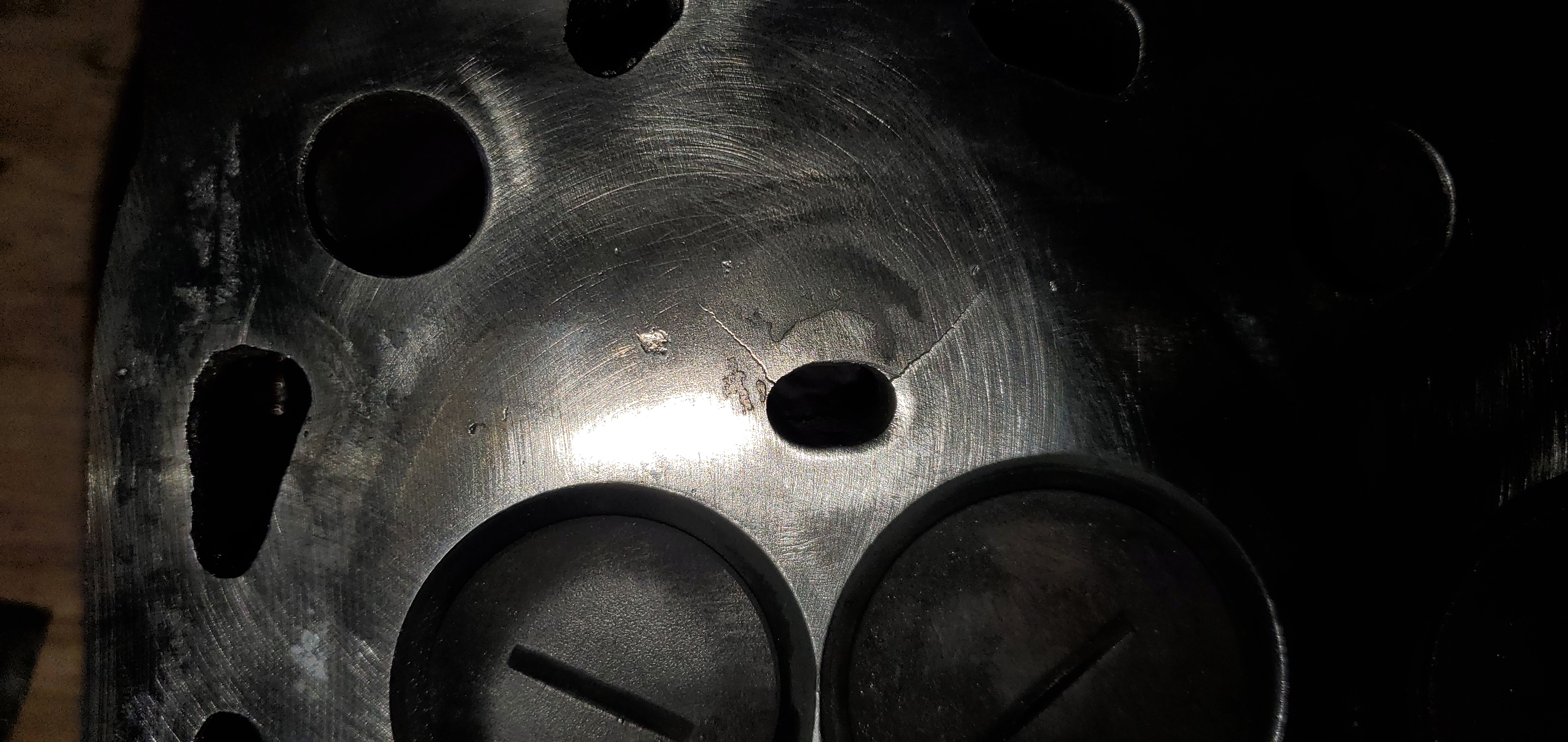

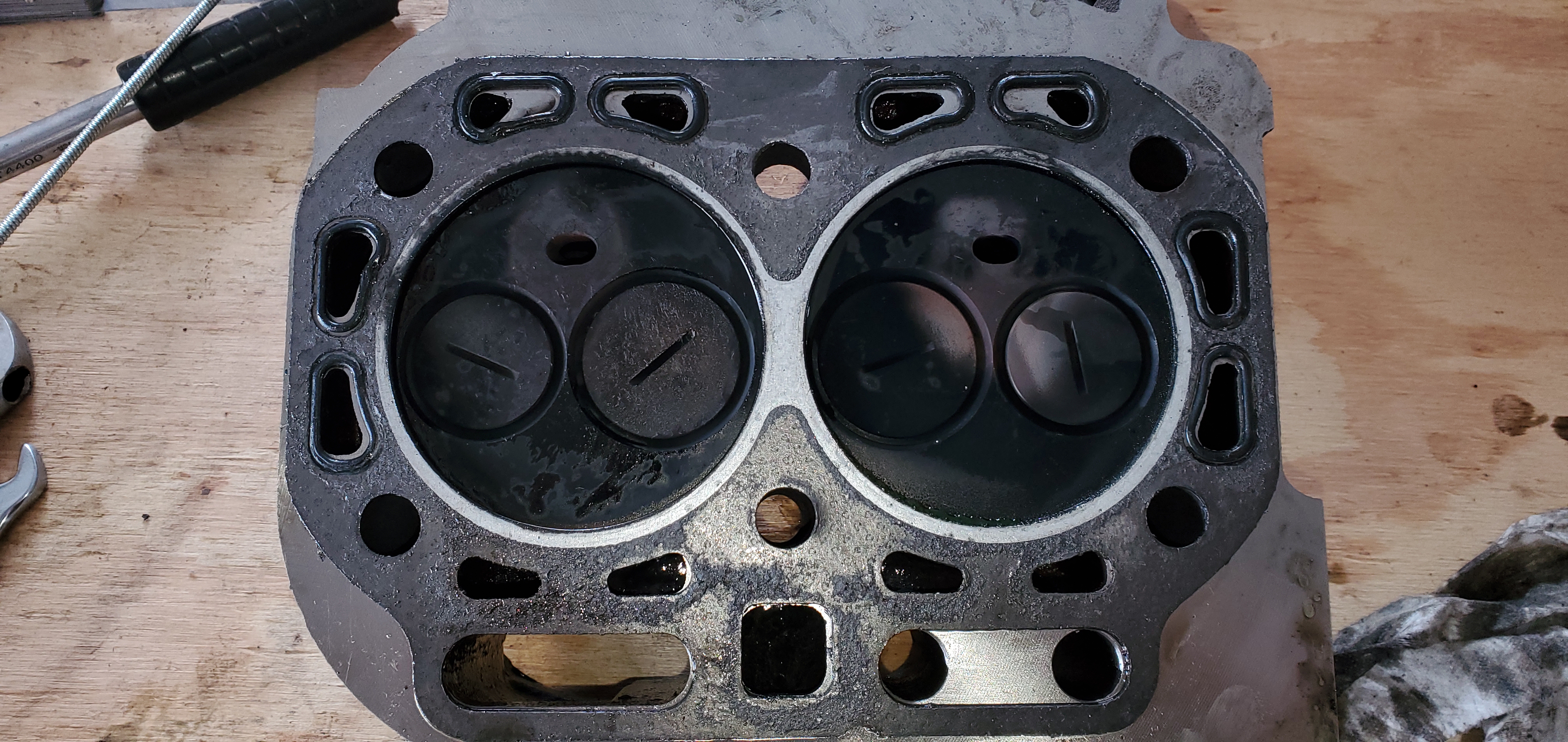

Happy Friday, sorry for the long delay. Having issues getting my password renewed on here and was ready to pull my hair out. Well, pulled the head off and found another crack at the the precombustion chamber. Like I said before, only ran it for a total of 40 minutes and it was not overheated. Also previous when I did the leak down test had a lot of air coming out of the air intake. I took it back to the machinist that reground the valves. The next day he called and said the intake valve holes were a slight oval shape, how did that happen? Turns out he or someone never did a pressure test on it after the reseating of the valves to check for leakage. He really apologized and reseated the valves and tested it, all good and why me? I sent the head back to the company that did the welding on it for the crack repair. at least it had a six month warranty on their work. I did not hear back from them yet. One thing I did notice, when removing the injectors they were lose. I know they were tight when I put them in with that copper washer. Is their a torque spec for them, my manual doesn't say anything. Looking for any ideas why it would crack again and why the injectors would be lose. Have some pics of the new cracks, notice all the carbon on the pistons and in the cylinders. Thanks again for all your insight
