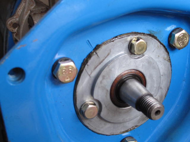

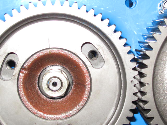

It looks like I am going to be taking it apart to set the timing. It is off much more than you can set externally:( When I remove the hyd pump do I need to drain the fluid first?
Thanks!
If you raise the front wheel on stand you can avoid draining the hyd fluid. Eye ball the oil level (I think seven inches) on dipstick, put an external mark and eye ball that with the hyd pimp inlet. Even on flat surface a gallon or so and you''ll be lower that the pump inlet so no siphonage by gravity will happen.

Can he use the glow plug port to pump up air in to the piston? When you overhauled your engine, did you notice a keway or something to maintain same crankshaft pulley position on the crankshaft? could it be off by 180 degrees.

Thanks for the fast replies! One more question. Air is coming out of the injector pump, even while I had the injector lines removed I could see a few VARY small air bubbles come out with the fuel while turning the engine over by hand. Should I be concerned about this while the pump is easy to remove, or should I just go ahead And time the pump and see how it does first?

If air is coming out then it is getting in somehow. Start at the tank and work your way down to the pump and check everything. If you take out the spring and delivery valve and the pump is in the correct position there will be gravity fed free flowing fuel to purge all air. If you still see air something is wrong.
As for pulley timing there is only one key-way. If the timing cover was removed by the previous owner, then I would take it off and check everything.
Russell

Is any "air" acceptable coming out of the injector pump? I have good fuel flow going to the pump. The timing appears to be advanced 60-70 degrees! I do not know how it was running with the timing advanced as much as it is was.

No air is acceptable as air it is very compressible vs liq fuel. air ends up being compressed and decompressed causing pulsation and no fluid flow. It is very strange for timing to be off as you claim and still running. If the crankshaft pulley is keyed to crankshaft can"t see it being out 180 degrees. What I'm saying it might not be off and it only appears to be due where the lines on the pulley is. Are you sure the piston #1 is on TDC on comprehension cycle rather than exhaust? (suck, squeeze, bang and blow) cycle. There is got to be a small gap between rocker arm and the valve stem end when TDC on compression cycle meaning both valves are completely closed.

Yes, it is on the compression stroke. I used a milwaukee inspection scope to look through the injector port so I could see the piston. I marked the pulley at TDC and then marked where the fuel injects (with the injector lines off). And then double checked it. I don't know how it was running ether.
Should I have my pump rebuilt and does anyone have an idea of what it would cost to have one fixed?

You have not established having a bad pump. Many people would be more than glad at your risk to take it apart and put back together.TDC appears to be the same position of the piston, how do you figure you're in compression stroke?

I have the valve cover off and I would hold my finger over the hole, when I felt the compression and both valves are closed I put the inspection scope in the hole and brought the piston to TDC.
