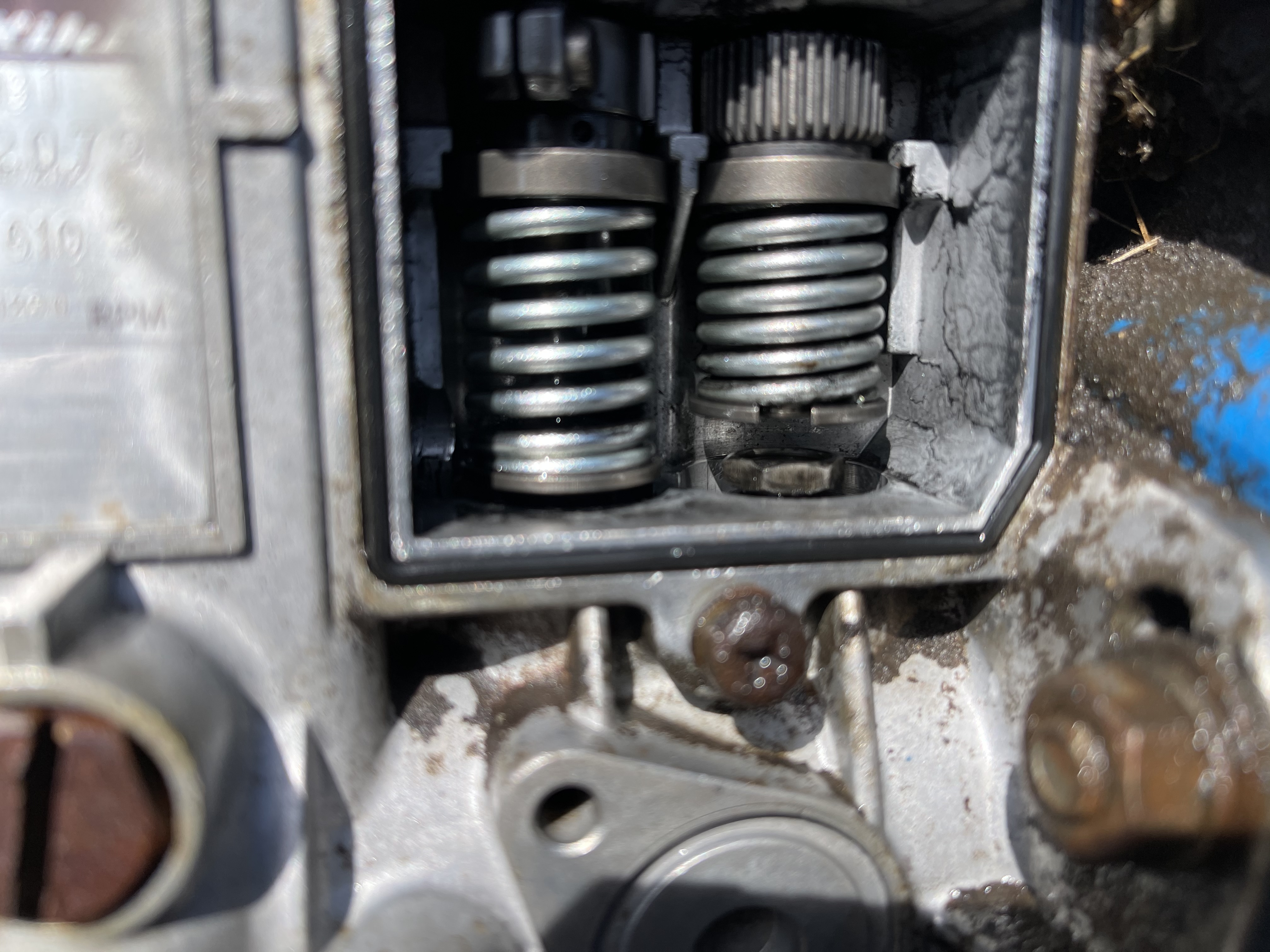

I took the side cover off and saw that the cylinder farthest from the driver is sticking. Looking at motion of the other cylinder (one on the left of the photo) the bottom of the spring is attached to the top of the pump piston, would that be an indication that the attachment portion (the malfunctioning piston) is broken at the bottom of the spring/top of the pump piston.

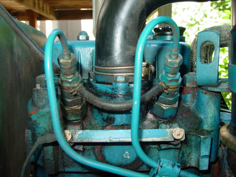

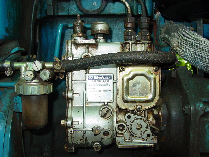

Ok, got your pm, here are some pertinent.
1- The filter bowl and filter is not bypassed and actually was eliminated by the previous owner. That was not a goo thing he did. If I understand right the bowl and filter was changed with some paper media, cartridge in line filter.
2- That type of filter will work but not recommended as it can not trap moisture that collects on the bottom of the bowl that needs to be dumped occasionally. The intake pipe in the tank sits proud of the floor of the tank by 1/4" or so that causes heavier condensation/water to collect on the floor of the tank along with junk and derbies. if you have too much condensation as the tank is atmospheric then you can push liq water to injector pump which is not good.
3- The injector pump is a positive displacement piston type that pushes tiny amount of fuel by reciprocation of a camshaft. if you have a bit of air in the pump discharge pipe then it keep getting compressed and will not pump. it just pulsate. Liquid is not compressible but air is.
4- I would not use compressed air just now. There is a large screw on the side of the pump that actually bleed the air from tank to the injector pump.This section is gravity fed so if fuel tank valve is open and screw I mentioned is open it will burp the air till you get a steady flow of fuel which in that point y need to re-tighten the screw.
5-injector are above the fuel pup and higher level than the tank. Fuel flow from pump to injector happens only when the tractor is on of turned over by starter.
6- The fuel pump has a lot of moving part so I would not at all recommend disassembly at this point. I am hoping the piston appears not working might be air locked.
7- you need to remove all air from pump to injector by loosening the injector feed line by the injector just a bit. Do not completely loosen the retaining nut. have someone start the tractor (turn it over ) to force the pump to reciprocate,see if you get air bubble. As soon as you see steady fuel with no bubbles then tighten the nut. Do the same on both injector.
8- Preheat at least for 20 second,put the throttle in the middle and try to start.
9-do change the oil in the injector pump for sure just to make sure you have enough. it takes about 2 oz of whatever engine oil you use.
Report back to see where you are.

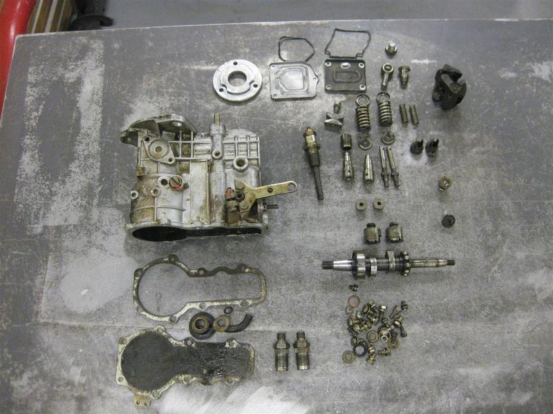

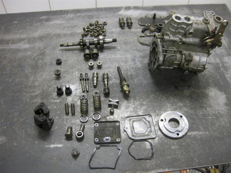

/ Ford 1700 Injection Pump Troubleshooting #7
Fuel pump innards.
