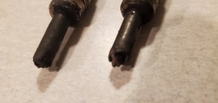

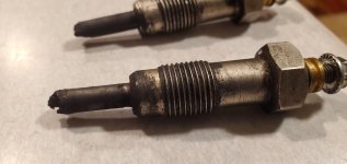

Hello, l own a Ford 1700 tractor, nice tractor but its eating glow plugs. I get about 4 uses out of them and they burned out. All electrical is good and ignition switch checks out. Would there be a possibility of something inside the head that's worn l am using l believe the correct plugs sba185366010 . Any advise would be appreciated. Geo

it looks like they are getting too much voltage, and overheating!. or they are just staying on too long, and burning out.. I don't know what voltage these are supposed to get. it don't have anything to do with something inside the head being worn, though.

I think the problem is at the injection/compression/combustion processes, see this information (page 6):
https://www.boschautoparts.com/documents/101512/0/0/0b189154-b815-46d7-bf70-e153bb6ecb88
At over-voltage you get a swelling/melting from the inside out (or no visible damage). The damages on your plugs seem very much to come from cold diesel fuel sprayed over the hot tip of the "bulb", causing it to crack, when the engine is running.
Do not buy anything yet, apart from plugs.
Check the timing and the injectors, before you put the new plugs in.
And look for/clean out parts from the damaged plugs inside the cylinder.
