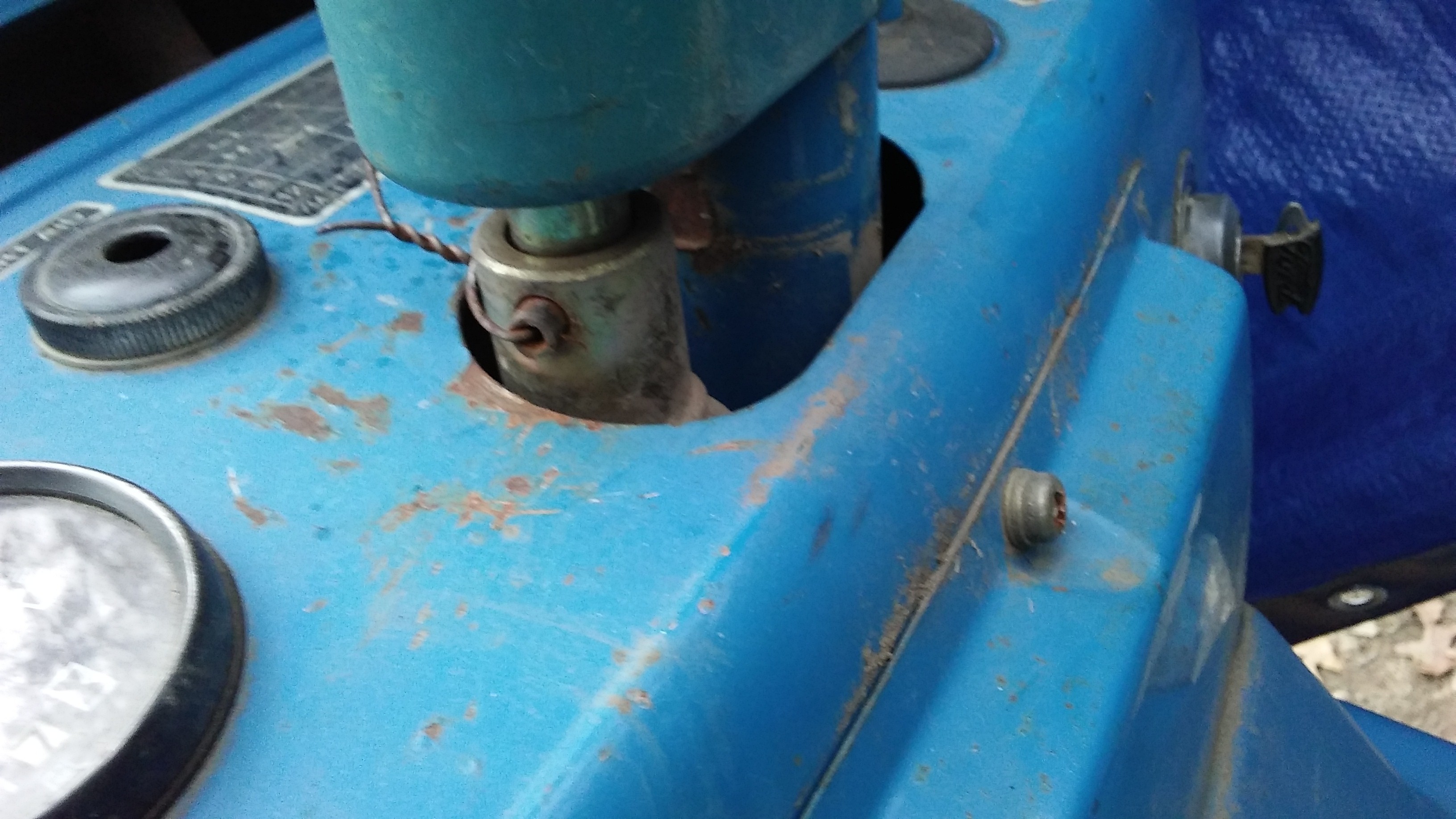

Just remembered a problem I had.
As in your case, shifter didn't respond.
Problem was a roll pin in the linkage came out.
